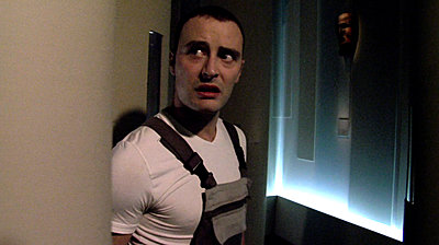

- Stephen, enclosed is a screenshot regarding the greys. I don't have one for the reds but the artefact is this: instead of decreasing uniformly away from the light source (spotlight trained on an object on red background) the brightness decreases in visible steps, almost like circular gradients. No, we didn't vectorscope. We'll do that.
- Eric, unfortunately I could not add more lighting because we shot in a museum so a) some areas had total lux restrictions plus b) in some rooms (like the one in the screenshot ) I didn't have enough budget to bump up the overall level as this would have required 20-odd additional Dedolights and taken a full day - it was only a screener after all.
-Paolo: the blacks were actually very impressive, beautifully velvety with still enough detail. So, you are absolutely right about the camera's potential in the blacks. I loved that and it's important to me because I am very keen on night/dark scenes. I'm not sure HDCAM does soooo much better, at x-times the rental and post cost, of course, and HDCAM yields a more sterile, clinical image quality.
Thanks for the cleaning tip!
