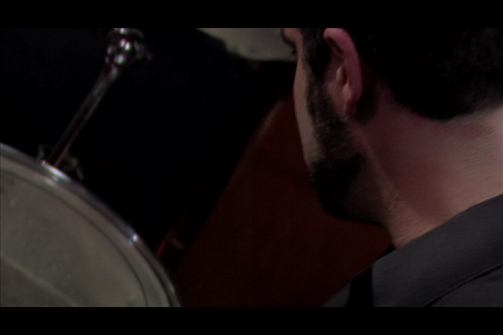

While looking through the footage of a project I shot this weekend, I've noticed a very similar occurence. I've attached a screen to show you. It's faint, but you can see a line down the middle of the frame that separates the image, leaving the left side a bit grainier.
I shot at f2 with the AE Shift at +3. I did not notice it through the viewfinder or on the LCD, but here it is.
