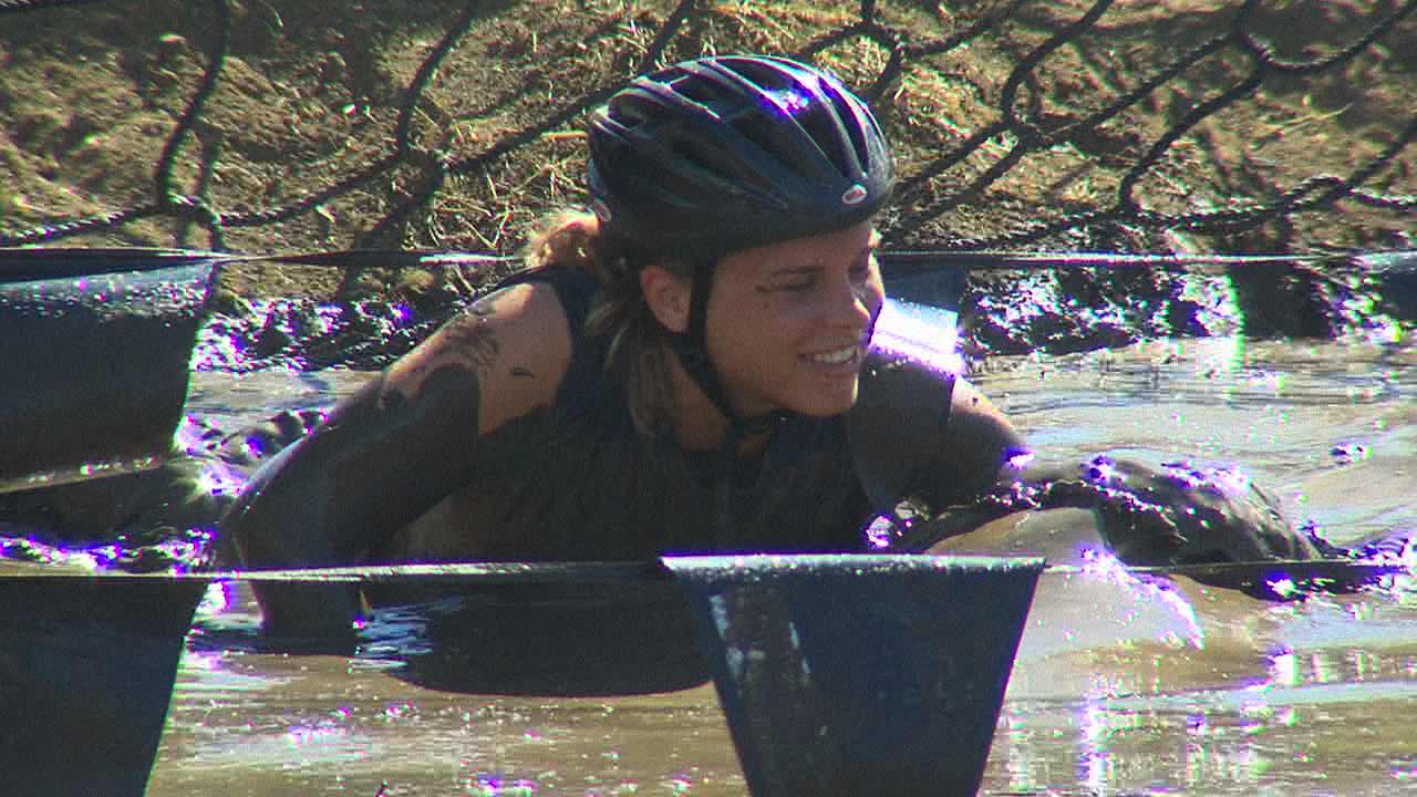

I can't quite digest two things lately: One, that a 900 square foot condemned house in Palo Alto sells for 1.5mil in one day - and Two, that I need to spend another ten thousand dollars if I want to zoom in on my girl slopping mud all over herself WITHOUT her having purple teeth (almost) once I get back to the Mac. I know, I know, "Don't zoom"
Personally, I think you might be more suited to stand up than videography. Also, that screen shot, i've never seen that much CA if you're referring to the purple stuff. In fact all the CA i've seen is green.

I'm probably the farthest thing from a nitpicker most of the time. My desk is a mess, my truck is a disaster, and if you walked through my garage with your eyes closed you might impale yourself on a C-stand, then trip on a circular saw and bash your head into the tail section of a superbike. It's just the way I'm wired I think. But, then, when it comes time to focus in on something - that's when the the other me shows up. And when this HD200 is in my hands, it's time to focus.
Ironically, this still I have linked to here is NOT in focus. What can I say, I'm learning. But it's still a good (better) example of just why I posted this question originally. And I think it's a good example of when a "Little" is just too much. I would have used a more horrible shot like this before, but I wanted to use the same shot as my boy got with the 20D.
By the way I've been fumbling around with filters in FCP and I have had some (very limited so far) success zeroing in on what I'm affectionately calling "Purple Haze" Something about Saturation in the highlights?
I've been kind of hoping someone would chime and say, "You idiot! You've got the DPA way off in that shot. Adjust your hootinany to B-17 between 3 and 5 and you'll be all set!"
Told you I'm shot... Been hit in the head with too many bolts
ps - Brian, how bout purple AND green in one shot? I think it must have been the subject matter exaggerating everything. Dark, brown, WET mud, on a very bright and sunny day.

I'm not one of gurus here. In fact, it seems I'm the only one here who is NOT a guru. But I've been loitering in the forum for a long time, and you've got some of the crappiest looking frame grabs I've ever seen. I'm assuming you just bought your 200? Maybe you just found a perfect storm of adverse lighting to bring out the worst. Hopefully someone who knows what they're talking about will weigh in here. I've never had a shot like that with my HD100.
Also, one of the dirty secrets of the JVCPRO HD series and HD in general is it's a bitch to focus.

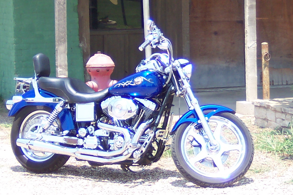

I'm going to take a stab and say that most of that is sensor overload. You'll often see the same purple fringing around lights at night time because the iris is open to expose the darker areas and the lights will overload it and give off a purple fringe.
I've had the same thing happen with the sun high in the sky, shooting stills of a motorcycle with lots of shiny chrome.

Yeah but were that the case wouldn't the overall shot be way overexposed?
Not necessarily, have a look at this. I have zoomed and cropped so it looks soft, but look at how all the shiny highlights have the purple haze.
No worries. Should only take me a week or so to turn that one around... ; )

Guru or not, if you can tell me how to NOT get this crap, or at least how to minimize it, I would much appreciate it
Attachment 3476
See, I'd say that looks overexposed though, at least the soil and grass. Eric's grab didn't look overexposed. In his frame grab, those purple thingees were so excessive that it actually looked like some kind of NLE filter FX.

For everyone: also keep in mind that fringing, be it purple or green or whatever, can be caused by several different things, only one of which is chromatic aberration. Some folks tend to make the mistake of referring to *all* fringing simply as "CA," and that's wrong. It might be CA, it might be a chroma sub-sampling issue as has been previously discussed on this site in our XL H1 forum, or possibly some other cause.
The usual reaction is "fringing or CA, whatever it is, just make it go away," but in order to make it go away, you have to understand what it is and what's causing it. If you just arbitrarily call it "CA" when it's really a chroma sub-sampling issue, then you're barking up the wrong tree and it ain't about to go away.
Identify the cause of the fringing. It might not be chromatic aberration.

Since I did NOT see this fringing in the viewfinder before shooting (and I WAS looking), I'm imagining that it might be nearly impossible to identify whether it's a sub-sampling issue (here I go back to the encyclopedia), or Chromatic Aberration (I'm guessing that tweaking settings until you affect it will help you identify it?). So when a shooter really needs to know, is THIS one of the cases where you absolutely have to have an external monitor?

Depending on the nature of the shot and how much color you are willing to sacrifice there is an option to "fix it in post". It's kind of a cheat depending on how you look at it.
Using color supression you can get rid of most of the CA. The downside is that the affected areas turn into a grey color. This is noticable in some shots but to save a shot it is sometimes worth it.
I tried it on Eric's attached image and it sort of works since it's mostly mud :)
You don't have to suppress all the colors this aggressively, I just wanted to show the possibilities with this simple approach.
Taking things to the next level would include swinging the affected colors back into something more "normal" instead of just making them gray.
