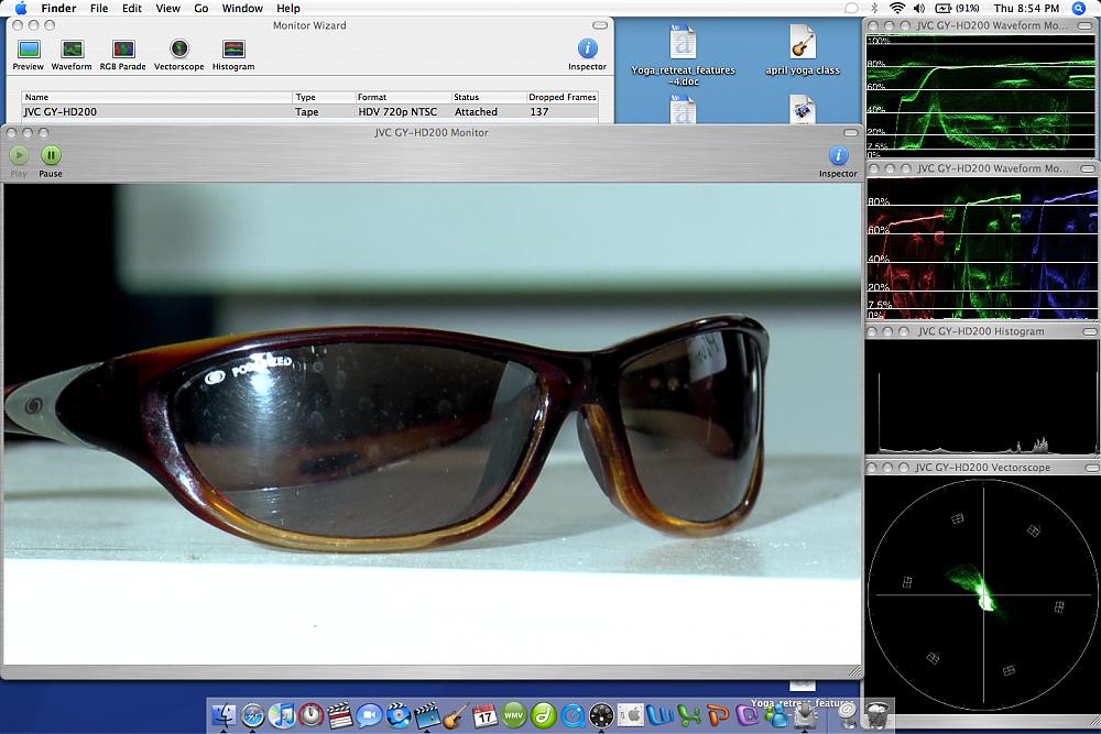

Holy shnikeys has anyone seen this yet?
http://www.bigmugsoftware.com/monitor/
I run a mac and have always understood, up until tonight, that using a mac laptop for a monitor is not an option. I'm anxious to try this because the laptop's already here and the software has a free trial along with it's already inexpensive price tag...
edit: Tried it and it works, although on this G4 there's a delay of about 5 seconds. They do say on the download page that you should have a G5 or later. Always something...
