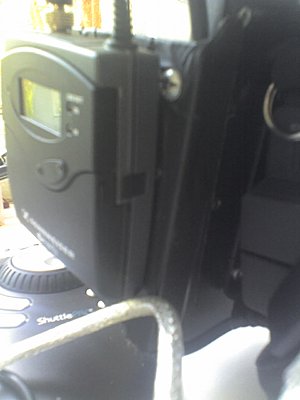

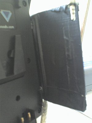

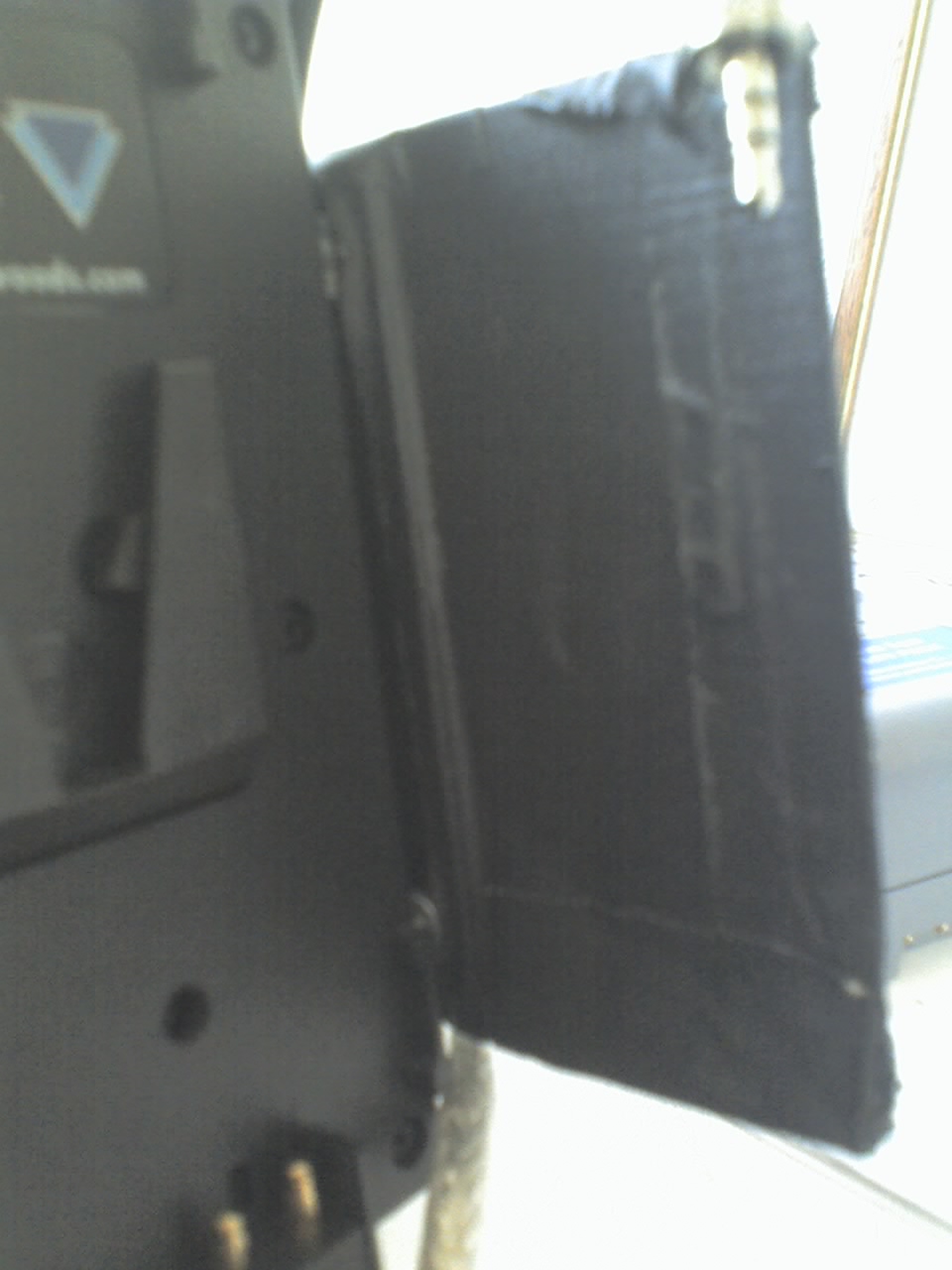

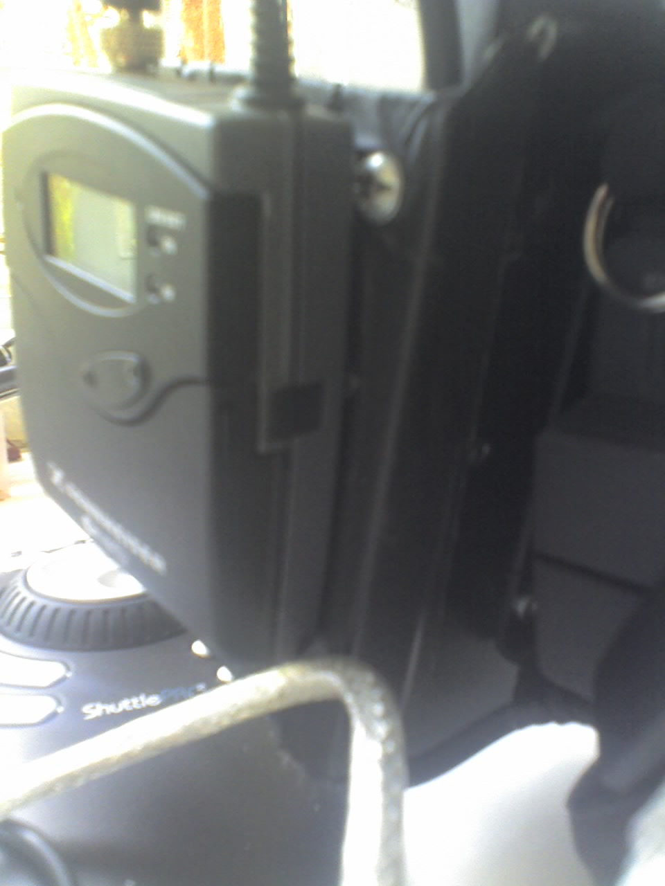

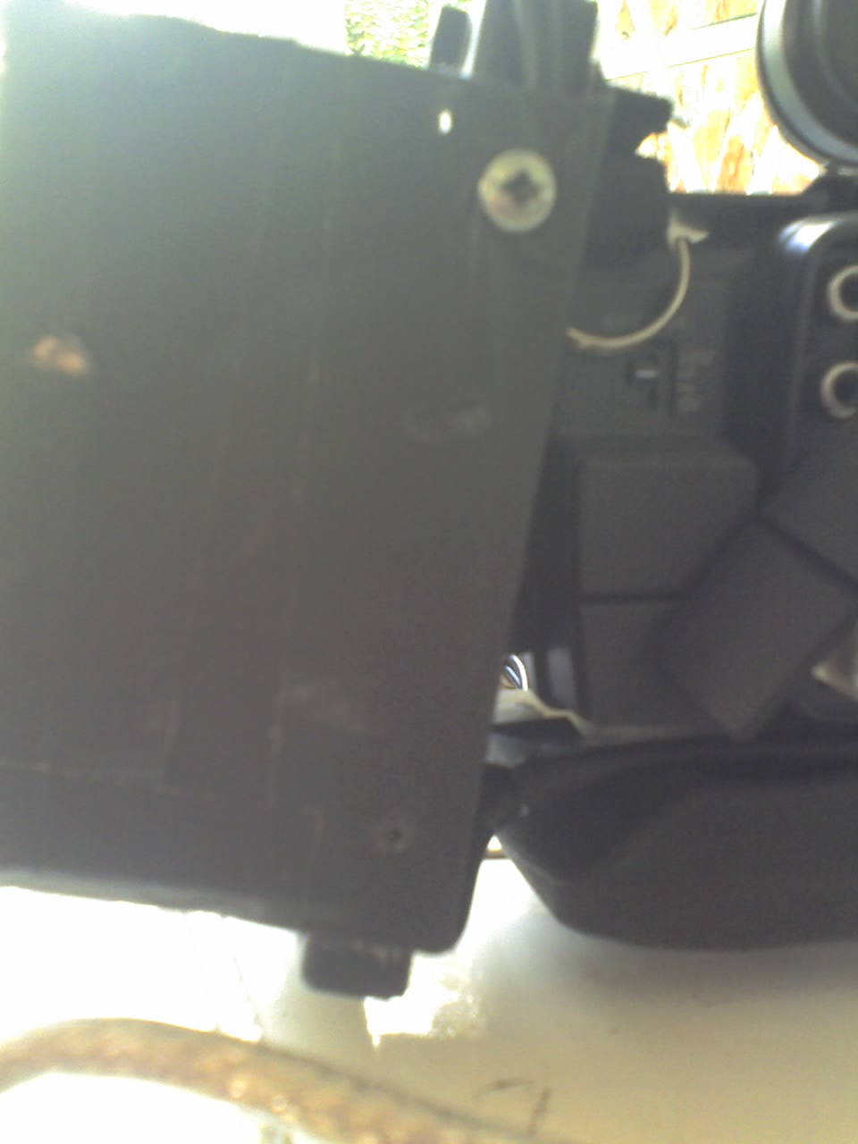

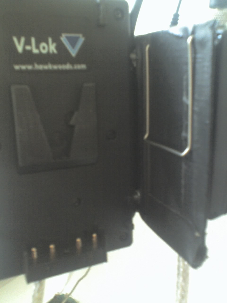

hi David. I have a Hawkswood V-Lok mount, too, and like Anthony i have fabricated a mount for a Sennheiser ew100 RX. i use a piece of Aluminium plate 100mm x 70 mm, with a 90 degree bend 10 mm in from one long side. There are holes on the side of the Hawkswood mount, and I drilled and tapped the plate to those. I've cut two slots in the top of my mic mount plate, into which the sprung wire clip on the Sennheiser drop down, to hold the RX in place. I've also wrapped the whole in matt black gaffer tape to give more grip. My Swit batteries drop neatly in next to the mic holder. Check the measurements for your batteries - I think Antons are a bit wider than Swits, so you may need more clearance. The RX cable runs between the shoulder mount and the tape access door.=, though sometimes it snags and I have to fiddle with the cable to eject a tape.
I'm thinking of getting a Firestore, and reckon I could fabricate a plate (maybe with a bracing arm) that will hold the FS behind the battery...
I'm attaching some arty picture of the mount taken on my phone.... hope they are useful.
And don't you wish they put L-shape XLR's on the mics?!
