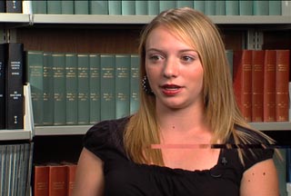

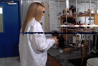

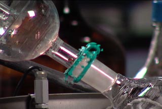

Alot of digital drop outs w/Pics
HD-100.
Had been shooting with Panasonic MQ tapes without issue.
Panasonic replaced MQ series tape with AMQ, now using them.
No display in camera while shooting yet when played back on two separate HD-50 vtrs we get the flashing "head cleaning required" error. Picture has random horizontal digital dropouts throughout.
Ran head cleaning tape through all units several times without any improvement.
Tested a digital clone via firewire from HD-100 to HD-50, issues remained but not as prominent.
Any ideas?

We have ALOT, which is why we sent it in for repair. The footage is unusable. What is strange is how random it seems. You can be logging in FCP and they are all over the place. You go to capture and they aren't in the same spot they were while logging. Occasionally they go away. Playback on the camera is fine with no warning and as mentioned earlier a firewire dub from cam to deck seems to help just a little. Problems appear on two different HD50 decks.

Scott, thanks for the input. What is weird is no they don't seem to be in the same places during playback. For example you can be logging in FCP and see them but when you capture they might be in a differnt spot on the clip. It's very odd. Another user said JVC had to replace the main board and drum assembly to fix his camera with these issues. At the price point of this camera body I am kind of worried that a repair like that with labor will cost close to what a new camera body sells for. I am used to old school betcam/dvcam drum/repair prices so hopefully I will be pleasantly suprised with this estimate when presented.
