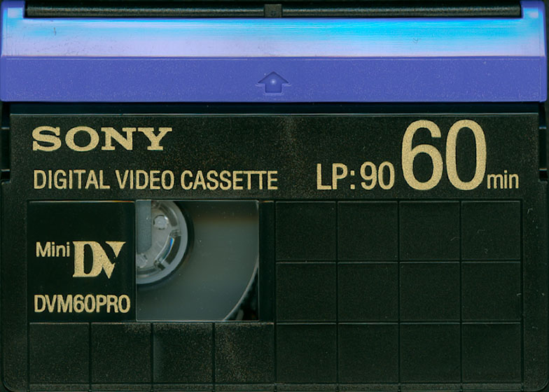

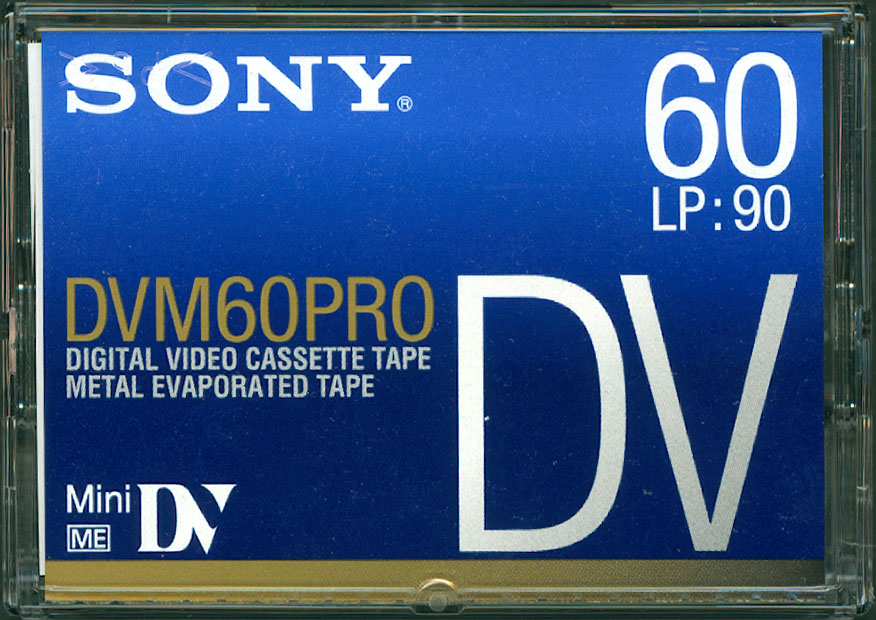

Andrew, what do you mean by "Sony blues"? The Sony DV tapes I use come in a blue wrapper. Is that what you mean? If so I didn't know Sony made any less expensive / lower priced ones than these.
D.J. Ammons is offline   Reply With Quote

Rather than rattle off some product code, I'll just post the following images:
Andrew
