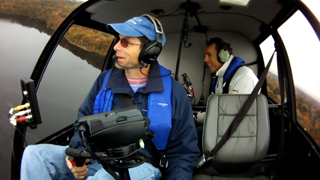

I have not posted any of the interior clips from the helmet cam shoot yet. It is on my list of items to edit.
I do have one still that I grabbed from the helmet cam footage here it is. We have been flying and shooting together for 6 years and have a blast as a team. This is one of the rare shoots where we do not have a producer in the front seat.

Just saw this pic on your blog.....

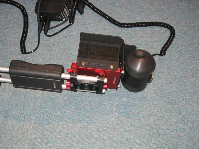

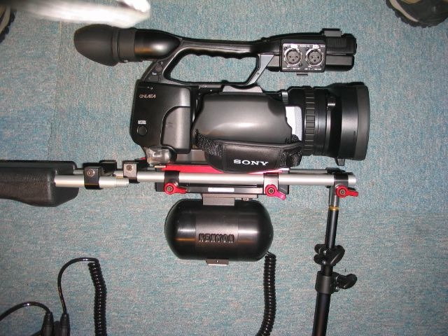

If you must hand hold I would suggest you rent two KS-8's and have one inline with the lens under the lens and the other off the back of your shoulder brace with the gyro 90 degrees to the one under the lens. Attached are two pictures of how I did this years ago. But the clients I have now this footage will not be accepted.

Sorry here are the two stills I said i would upload.
Helmet Cam - The Best Way?-shoulder-brace2.jpg   Helmet Cam - The Best Way?-shoulder-brace3.jpg

Awesome gyros...How much do it cost to rent them in US?
