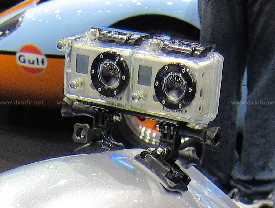

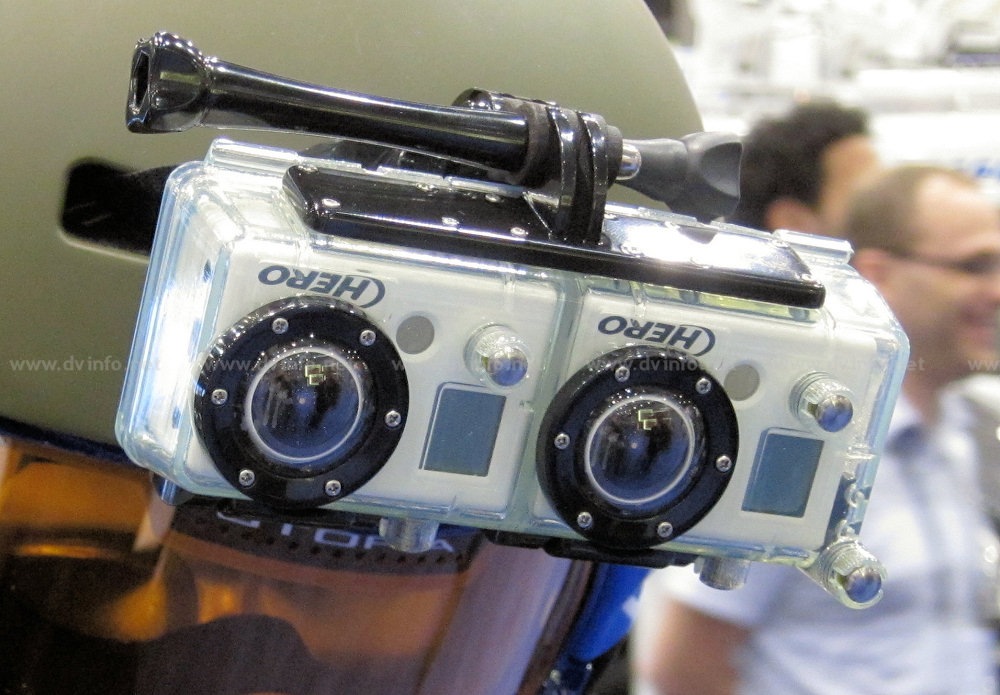

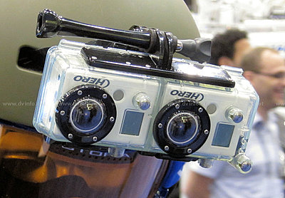

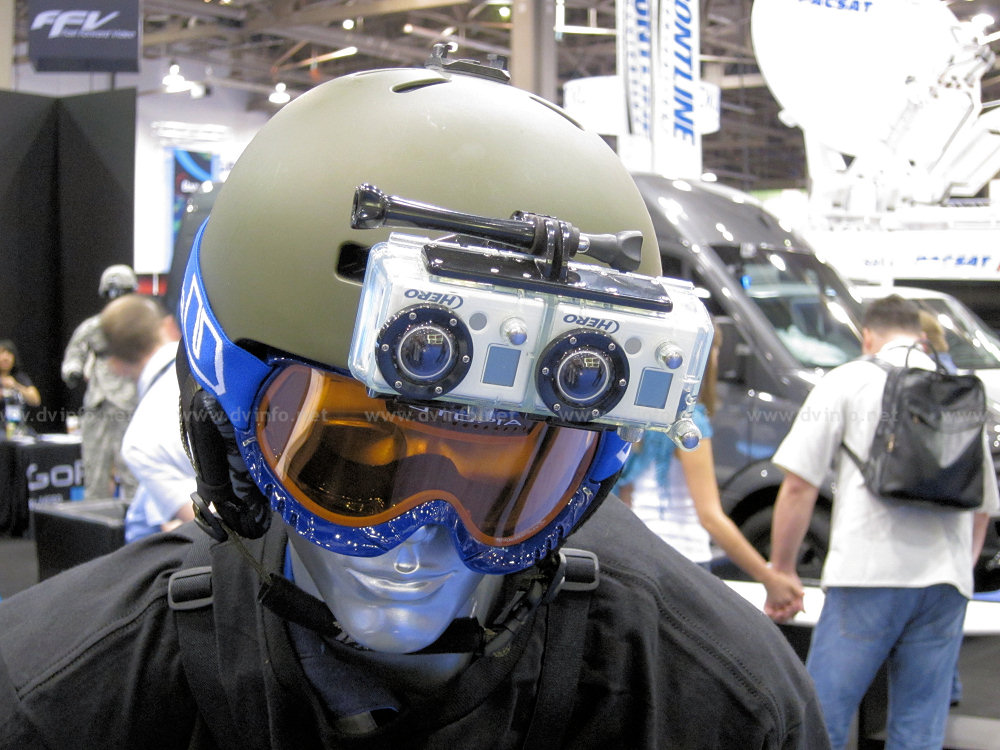

Old April 17th, 2010, 10:19 AM   #11
Posts: 27,382
Click to see 'em big...

Originally Posted by Pavel Houda View Post
...he said they genlock them,
Although they didn't use the term genlock, they also did tell Chris and me that they will have a connector to keep the cameras in synch. Neither the cable nor the dual-camera clear case for stereo is available yet. Will give it a try when we get our hands on them.
o.k., it's there @: YouTube - NAB 2010 Red & Cyan Anaglyph - GoPro Hero, True HD and NEW 3D Arrangement . Sorry, my 3D cinematography skills are poor. I don't know how I managed it, but some of the clips were L/R reversed. I'll have to re-post the video.
I was going to watch it anyway (holding my glasses in reverse) but it is marked private.
The bottom two (on the helmet) would give you a real headache the way they are tilted.
Edit: Come to think of it, the top two have the same problem.
