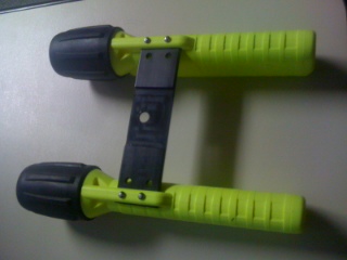

Wayne, I was going to try to connect the two Q40's with a something similar to the image below .... Its the set up we use with our Splash Cam: Seatrex High Definition Point of View Camera (at my day job) we've used this set up at 100ft while ice fishing and the 2 q40's seemed to give off enough light if the subject was close enough to the camera. I like your idea on the 20in arms, that seems like it would allow the lights to be farther spread out ... maybe I can accomplish this with Curt's Gorilla pod idea .... but I'm also interested in hearing about your PVC idea?
