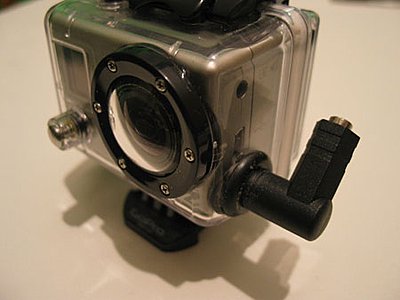

You may be interested in the arrangement I've made for using an external mic with myGoPro

That's neat Renton
It, of course, wouldn't be totally waterproof any more but would certainly protect the camera in a light drizzle...What mic are you intending to plug in there??

Hi Chris.
The case is totally waterproof...though obviously not for underwater (though it could be - I won't try it!), and the mic will not be protected. The right angle jack is a tight fit in the rubber gromit.
Just ordered a couple of elcheapo mics off ebay ...be interesting to see how they go...

Just make sure the mics are self powered!! I bought a neat el-cheapo from Jaycar here and it doesn't work as it's a dynamic mic ..I have always been under the impression that only condenser mics need either a battery or phantom power and dynamic mics work without powered inputs...the Hero didn't like it at all!!!
Let us know how those work?? I shot a wedding 2 weeks ago and used the Hero in the Church and the audio was quite good ..I guess it was because they had a speaker bank about 3 m from the floor and I had the GoPro on a stand just a tad lower and it was in the skeleton case.
Chris
