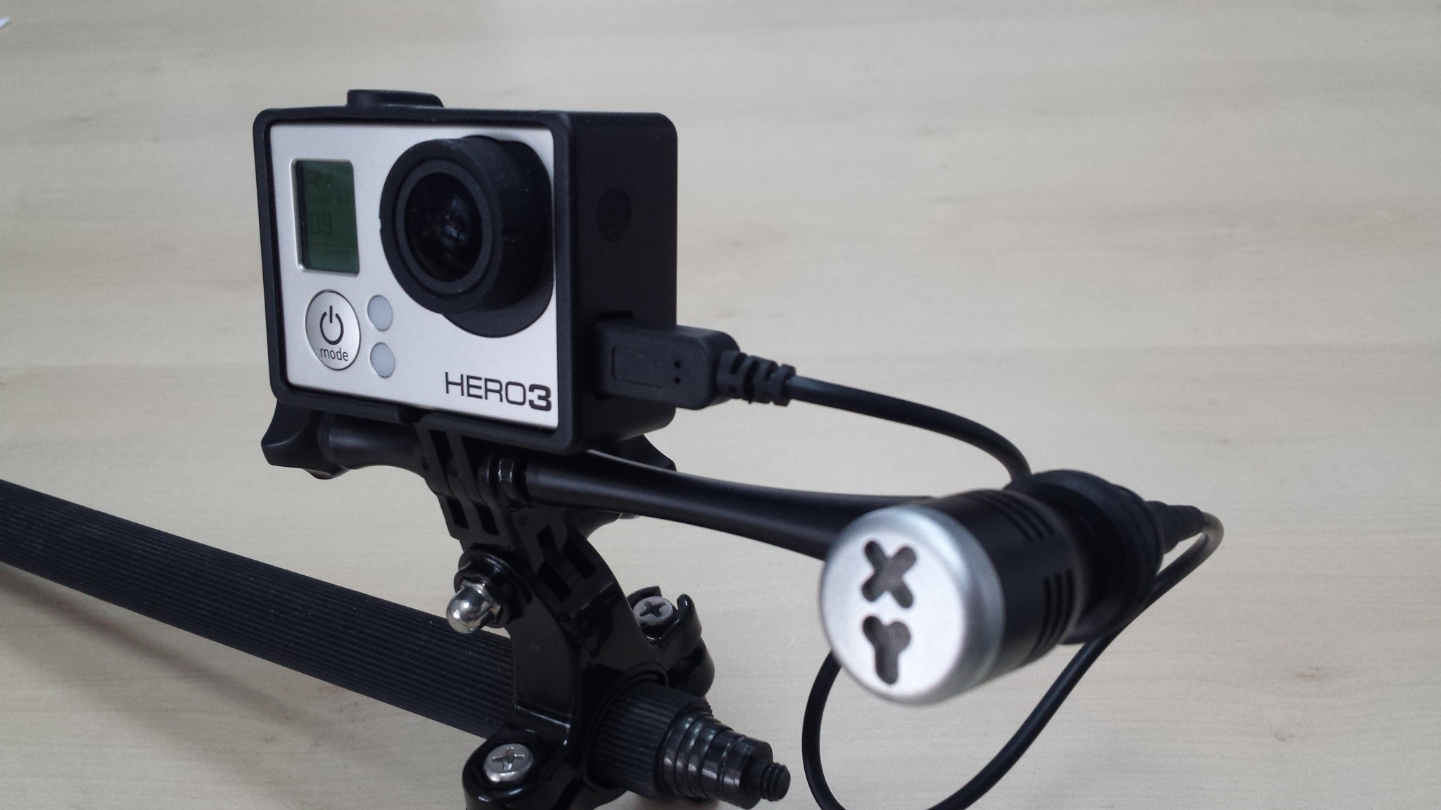

I have this new stereo mic im testing at the moment, iGoMic, it's shaping up to be very good with the GoPro. It's available from B and H. Comes with the GoPro USB mic cable and custom mount.
GoPro User Forum ? View topic - Stereo Microphone for GoPro

The iGoMic looks interesting but why don't they use right-angle USB plugs? The current USB plug, sticking straight out, is an accident waiting to happen.

PPS I'll buy the igomic in a NY second if...if you can say with confidence that it will move GoPro's audio up to a whole new level.

Ian...I noticed you haven't written up a review of the mic yet on the other site. Still testing? Or has your impression changed after listening to the audio for a while?
