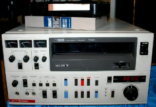

I would like to convert an old college production---shot on 3/4-inch SP Videotape---to digital so I can author a DVD. I will be using my Canopus ADVC300 converter. I believe I can get my hands on a 3/4-inch tape deck, specifically the "Sony 5850."
Question: I don't know if any of you remember these 3/4-inch deck dinosaurs or not, but will they have the proper audio and video outputs to go into my canopus converter box (which has composite and s-video inputs)?
I have tried to attach a jpg of one of these dinosaurs.

Hmm, should I be embarrassed to say I still have a 5600 in my equipment rack in the office? One of these days I'm going to get around to dubbing all of the old 3/4" masters and get rid of the monster.
In the meantime, it has composite video via BNC and RCA outs for audio--the 5850 might have XLR outs, though.

I have a Sony VP720 I use for dubbing purposes. It has a BNC out for video. You'll need a BNC to RCA adapter to feed a composite video signal to your canopus. Two RCA audio cables for the audio as well of course.
I've done this a lot, no problems at all.

Well, thanks for bringing a smile to my day. That's a no kidding piece of professional video equipment. You can tell by how much it weighs ;)
It will have a three prong plug (it's not THAT old), and Richard's spot on about what you'll need for the transfer. Most of the professional world still uses BNC connectors for composite (and component) video.
Treat it gently, it deserves a bit of respect. Heck, at one point, it was a huge breakthrough. In it's day, it was THE standard. There was none of the complex tangle of formats, bit depths, codecs, etc. that make up the current landscape. Of course you paid for that simplicity. Charles, any chance you remember what you paid for your 5600?

The Sony 5850 (pictured above), 5800, 9600, 9850, or JVC BRs810u.
What the difference is between those Sony models, I don't know. The higher numbered models, superior?
Where do you guys that have such decks go to have them serviced? I'm so electronically deficient that I don't think I'd attempt cleaning the video heads.
Probably a stupid question, but before I drop a few bucks on one, I'd like to know if there are places out there that service them.

The canopus 300 has a TBC built in, so you're good to go.
As to servicing the deck, if you're renting it, the place you're renting from will be servicing them. If you're buying, then ask the people you're buying from where THEY got them serviced.
I picked up my deck for twenty dollars. No Joke. There's a company in Florida that sells used broadcast gear, and they had a dozen of these old U-Matic Decks. (I have some u-matic footage, and I occasionally have to deal with it.) All they asked for was the shipping, as they were giving the decks away for free.
I clean the heads on them myself. It's MUCH easier than dealing with mini-dv. The drum is HUGE in comparison. I have a 'head cleaning' swab I got at an electronic supply store. Basically a little plastic handle with, I think, a deerskin chamois pad on the tip. A little bit of cleaning fluid (alcohol) and I rotate the drum by hand. Wipe the head GENTLY in the direction of rotation, NOT vertically as this will misalign the head... and they are good to go. These things were build like tanks, which is why they weigh so much.
Yeah, they run with standard edison plugs. You'll just need to pick up a BNC female to RCA male adapter. That is, the BNC end fits over a male connection, and leaves a MALE RCA exposed on the other end. Costs about two bucks at a good electronic supply store, about five at a Radio Shack.
EDIT: On second thought, if you're renting, DON'T crack the cover and service, you'll upset them no end.

BETA SP is a 3/4 inch format. The deck I have is an old U-Matic. It will NOT play SP tapes, but is from the same 'era' and 'bloodline' as the SP decks.
The model numbers will denote whether or not the decks are PLAYBACK only or PLAY and RECORD. Also, extra bells and whistles.

Richard, although I got out of the bay area and (somewhat) video stuff temporarily about that time, I think that the only diff between Beta and Beta SP (which stands for Superior Performance) is that the SP decks were set up to use metal particle tape - the heads were harder material, and if you use the metal particle tape on a NON-SP machine it will tend to wear the heads out faster.
IIRC, ALL beta machines were based on half inch tape - the 3/4" models were all U-matic, from the first VP-1000's, V-1600's and VO-1800's (manual audio gain and no tuner) on up; first to Vo-2800, VO-2850, etc - at that time, the "50" add-on in the model # meant it was some sort of editing deck, as in "assemble" and sometimes "insert" editing. To get clean edits with tape formats, flying erase heads were needed to keep moire to a minimum.
Although VHS eventually beat out consumer Beta (the general public has always preferred quantity over quality) Beta had the last laugh and several more "incarnations", up to Digi-beta (perhaps beyond that, I mighta missed something there)
During that era I worked at Memorex as a video tech in their QA lab, was responsible for design and build of head protrusion measuring fixtures, training other techs, etc, for all new types of machines so we could evaluate our tape for headwear (along with chroma noise, s/n, dropouts, etc) and we all KNEW that Beta would beat the sox off of VHS because it was obviously BETTER. But like I said, the public spoke :=(
I also ran a successful video maintenance biz in the same time frame with a partner; he did mostly 2" quadruplex and I did mostly helical, although if one of us was busy the other could handle either part of the market.
AS to cleaning the heads of these machines (both u-matic and the half inch ones) I used to use q-tips and xylene (xylol), and I DID rub (VERY VERY gently) perpendicular to head travel, because it seemed to get the head cleaner - I always used a well-saturated q-tip, and immediately spun the heads up to both aid in drying and to let centrifugal force help dislodge any stray cotton strands that might have gotten stuck on the head. I also cleaned, then de-magged, then cleaned again (same with audio transports - magnetized heads tend to hold onto particles a bit hence the double cleaning)
I do NOT, repeat NOT, recommend this method to anyone who isn't trained in the GENTLE art of watch repair or similar, however - because doing it that way doesn't put the heads out of alignment exactly - it just DESTROYS them. The heads themselves were tiny little chunks of Hot Pressed Ferrite (That's what the "HPF" in literature stood for) and they don't "bend" or go out of alignment, they simply crumble because HPF is VERY brittle due to its extreme hardness.
So everyone, PLEASE stick to the cleaning method mentioned EARLIER in this thread, or likely suffer a broken video head - you'll probably have to look long and hard to find a video tech anywhere that still has the concentricity gauge and fixture that is needed to properly align a video head drum on these machines for decent playback, and that's if heads themselves are even still available - as I said, I've been away from this segment of video for about 3 decades now so for all I know, there may be a whole new resurgence of interest I'm not aware of.
BTW, ALWAYS let a machine's tape path DRY thoroughly before you try to run a tape - pretty much ALL solvents that will clean heads will ALSO soften oxide coatings and make MUD of your tape path. Not a pretty sight.
HTH... Steve

Not positive, but I believe that the "SP" designation as Sony applied it to TAPES, meant that the tape was a "metal particle" tape - these tended to be more abrasive in addition to their higher coercivity, so were not recommended for "standard" machines - they should, however, PLAY in a standard machine; although the different flux levels might or might not cause moire or other picture artifacts. If you had very many of these tapes to dub, using a standard machine might cause quite a bit of extra wear on the heads of the machine - but with only the one tape, I would just play the tape and check for the above picture problems - if they don't appear, I'd feed it into your ADVC-300 (I have one, great box) and go for it... Steve
(BTW, it's likely that the amount of "artifacts" that show up would be worse with a machine that has worn heads - as video heads wear down, the signal saturates the heads easier(less mass) so you have to lower the record drive - playback from worn heads will be hotter, so equalization changes can be necessary to reduce the effects of "overdriving" the heads due to their increased sensitivity. It's not likely you have the service manual if this is a rented or borrowed machine, so you'll probably be limited to checking playback and if it looks OK you're golden.

Correct me if I'm wrong, but I believe there were 3 main formats in Umatic (or 3/4 inch if you prefer), Loband, Hiband, and SP (or hiband SP). I believe "KSP" was the designation for the SP tapes produced by Sony - KCA being the designation for the standard loband tapes, and BCA the Hiband. In the UK, Loband was the most common, and the format of the vo-5800 (recorder/player) and vo-5850 (edit recorder) machines (I have one of each in my loft, probably causing the roof beams to sag!) - if I remember correctly you could record any format on any tape stock, but loband machines only playback loband, hiband play back loband and hiband, and SP machines played them all back. London Ad agencies used to like stuff on loband, and even up to about three years ago there were loads of loband machines in circulation, but I think after time the rollers began to perish and by now I'd be surprised if many places still had them. Hope this helps
