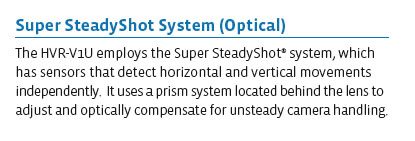

Originally Posted by Stuart Graham View Post
It doesn't mention the OIS in the Sony brochure for the V1 for some reason.
Look a little more closely on page 4 of the brochure :-)
http://ws.sel.sony.com/PIPWebService...nalpdf1-07.pdf

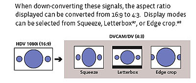

That's interesting Nick, because my impression is definitely the opposite. I get better results shooting HDV and down-converting to widescreen DV in-camera. I even tried some tests several years ago after first getting the camera and satisfied myself of this....

Originally Posted by Boyd Ostroff View Post
I don't see the V1 manual online, and have only played around with one for a little while, but I know it's a little different. I believe it lacks the edge crop downconversion, not sure whether it can record 4:3 in DV mode.
While looking at the V1 brochure manual just now I found the following (see attachment). But I'm pretty sure *something* is different between the V1 and Z1 when it comes to 4:3 material, just can't remember exactly what!
