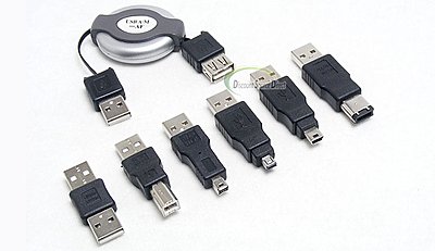

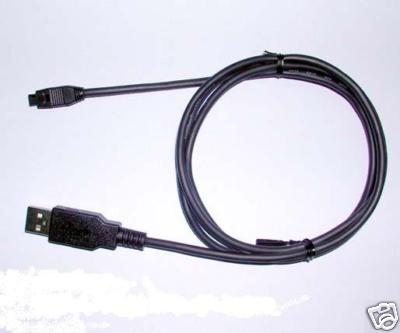

Just wanted to post a follow-up, I purchased a cord on eBay a while back and it has worked perfectly, I was going to get this one http://cgi.ebay.com/ws/eBayISAPI.dll...m=220316077232 but got this instead http://cgi.ebay.com/ws/eBayISAPI.dll...m=310084988274

I am puzzled - together with hundreds of others here... The cable you purchased is a USB to USB-mini cable - as far as I can tell from the eBay photo and description.
How did you use it? What did you use it for? To capture video? What format - DV or HDV?
Please elaborate.

To my knowledge there is no way to convert from USB to Firewire just by using a wire with different connectors. I could be wrong, but I'd bet a shiny nickle I'm not.

Looking at the cable+connectors on the left...
I think the idea with that cable is that it provides generic transport.
Need something different? Pop the appropriate adapters on, on BOTH ends.
Need Firewire? Pop a 6 pin FireWire adapter on one end, a 4 pin FireWire adapter on the other, and you're in business to go from computer to camcorder.
Trying to go from USB (computer) to FireWire (camcorder) WILL NOT WORK.
The adapters on both ends of the cable need to be of the same family type. (USB, FireWire, whatever).
