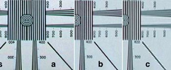

I don't blame you for being skeptical as it makes no sense, but it is definitely true. Just tried to find that article in the DVmag archive, but after revamping their site I can't seem to do a search past 2007. They printed side by side pictures of a resolution chart, one with the Panasonic adapter, one with the in-camera stretch, and one cropped and stretched in post. I did save a copy of that, and here it is.
Adapter is on the left, in-camera is middle, and post is right.
I can't remember their explanation. To my eyes, the in-camera stretch has more detail and definitely less stair stepping.

Posts: 2,699
Originally Posted by Marco Leavitt View Post
.... using the incamera 16:9 in progressive mode is far superior to doing a crop and stretch in post. It's not quite native 16:9 but it's close. The benefit apparently only exists if you are shooting progressive.
Interesting, and it makes sense. The advice has long been that if you want both 4:3 and 16:9 it's far better to derive via cropping the 4:3 from 16:9 than vice versa. The reason is that it only involves simple horizontal rescaling, going 4:3 to 16:9 via cropping is far more complicated because of interlace.
In progressive mode, that vertical crop if done early enough in the chain should indeed be a simple rescale. (And try to do it in post and you're likely to have the interlace factor to deal with - DV will record it as psf.)

I can believe, all things being equal, that yes, take interlacing out of the picture, and things will be easier. And a single direction stretch will be easier to achieve. Of course, what's best is going to have a lot to do with the sensor dimensions, the layout of the pixels, etc.
No question that the middle image is better by far than the one on the right.
