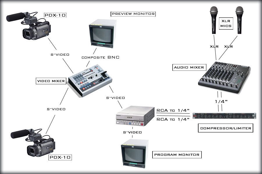

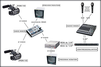

Don't run your audio through the camera....it will only make things more complicated.
The Edirol LVS400 is a good mixer, and much easier to use than the V-4 (the one made for clubs). I've never used the Panasonic mentioned, but I've had much better experiences with the Edirol over the Videonics. I've used and sold both in the company I work for.
I'd set up a system like this....diagram attached.
The DSR-11 isn't the greatest choice for this because it only offers an unbalanced audio connection, and has no audio meters to monitor the incoming audio levels. Just keep your levels right at the mixer and the compressor, and you should be ok.
If you more money to spend, you could buy a rackmount of three monitors...use two of them for preview monitors and the third one for a program monitor. It may be cheaper to do that anyway.
Good luck!

Wade, nice diagram!
I think it was the V-4 that had that annoyance that I describe in my post.
Glenn Chan is offline   Reply With Quote
Old November 17th, 2006, 11:54 AM   #10
Location: Wellsboro, Pa
Posts: 285
Yeah...the V-4 just has too many features for what most people will use. The LVS-400 is quite nice. I work for a company that sells to the church market, and I usually recommend that one to them, especially with the volunteer status of most church's video staff.
