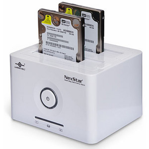

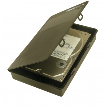

On the cheap, I'm a fan of just using bare SATA drives with a drive dock.
Then shelving them in these plastic wiebetech cases. It's funny the cases kind of resemble old vhs/betacam cases.
