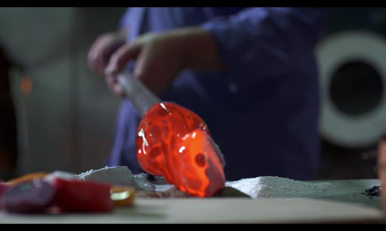

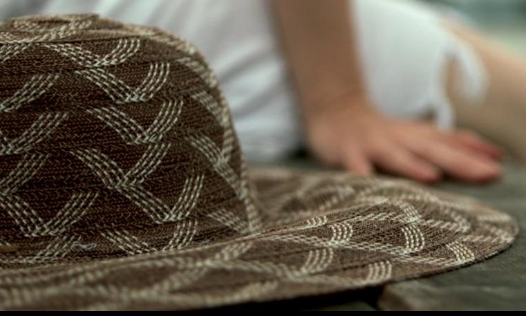

In the F3 forum I made a comment on the appearence of the F3's focus and others politely disagreed with me. In watching the very shallow depth of field from this CMOS I question whether the industry will provide the neccessary viewfinders, LCD's and focusing systems or is accurate focus relegated to the must have accessories? The footage in the F3 forum was excellent work and my comments I feel stepped on some toes but I have to be honest, I still feel as though extremely shallow DOF can miss critical focus and has limited use. Such as the swimming video in the F3 forum http://www.dvinfo.net/forum/sony-xdc...3-footage.html at the 10 second mark a portion of the the hat is in focus, appx 1/3. For me it isn't enough. Another piece of footage shows a glass blower and the entire picture looked OOF for a split second. The possibility exist that it was just test footage and not seen as critical or it could be that I am just wrong.

I wonder about the DOF with increased F stop, I would like to see some street scenes to see how deep it can be.

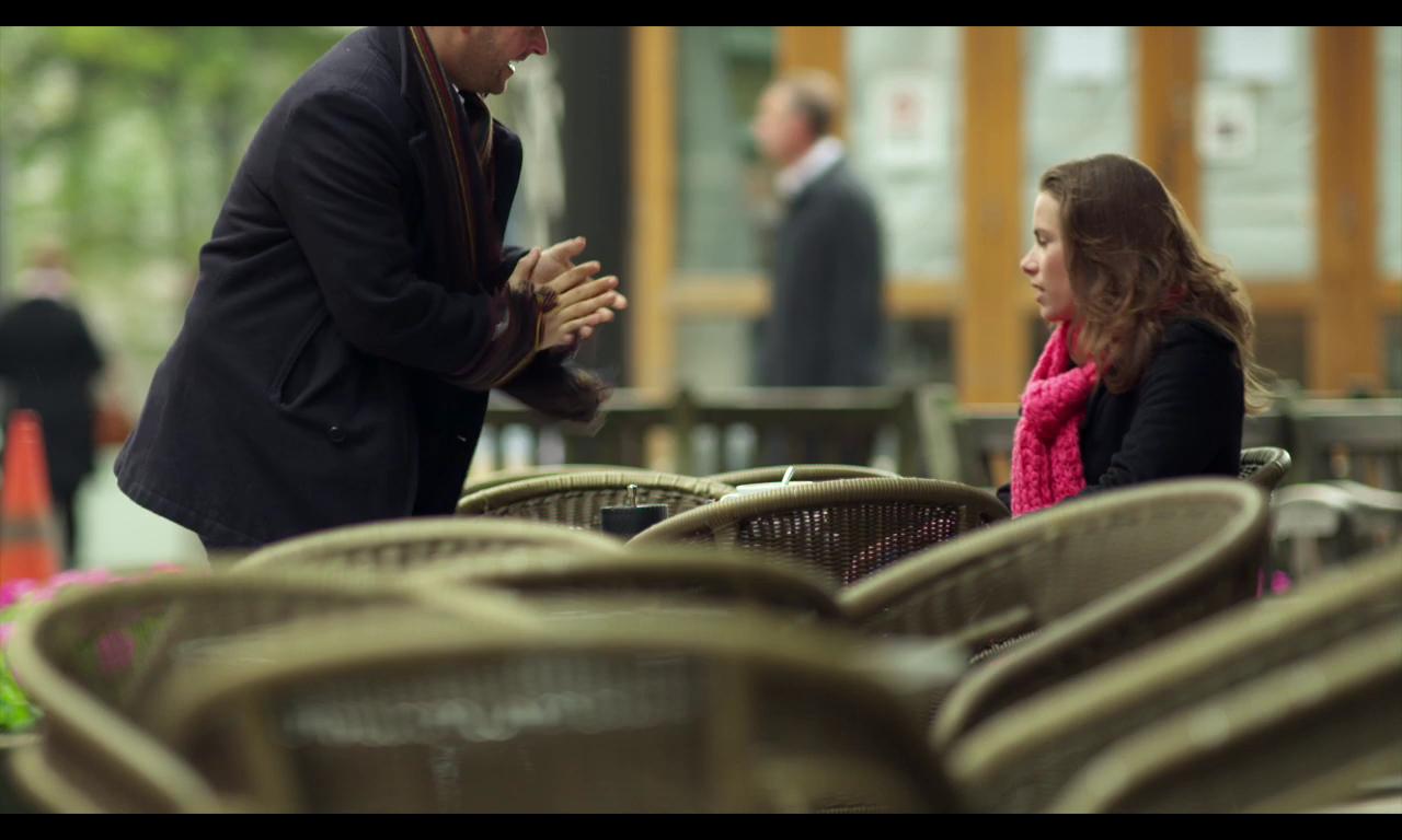

Does the F3 appear to hunt occaisionally to you ?? I have looked for but can't find any specs on the F3's LCD. Is there some ratio or formula to what an LCD has to be to replicate accurate focus on 1080p ?? I see the "knife edge" miss sometimes. Such as the seen where the woman is sitting streetside, it seems to hit the back of the chair rather than her face
Looking at your frame grab and then going back to film, it appears to me that the focus was preset to catch the male actor as he came into frame-- it more center of the table and at his hands. I don't think there was an attempt to have her in focus in the shot, and they probably intended the shot of him in frame to last longer.

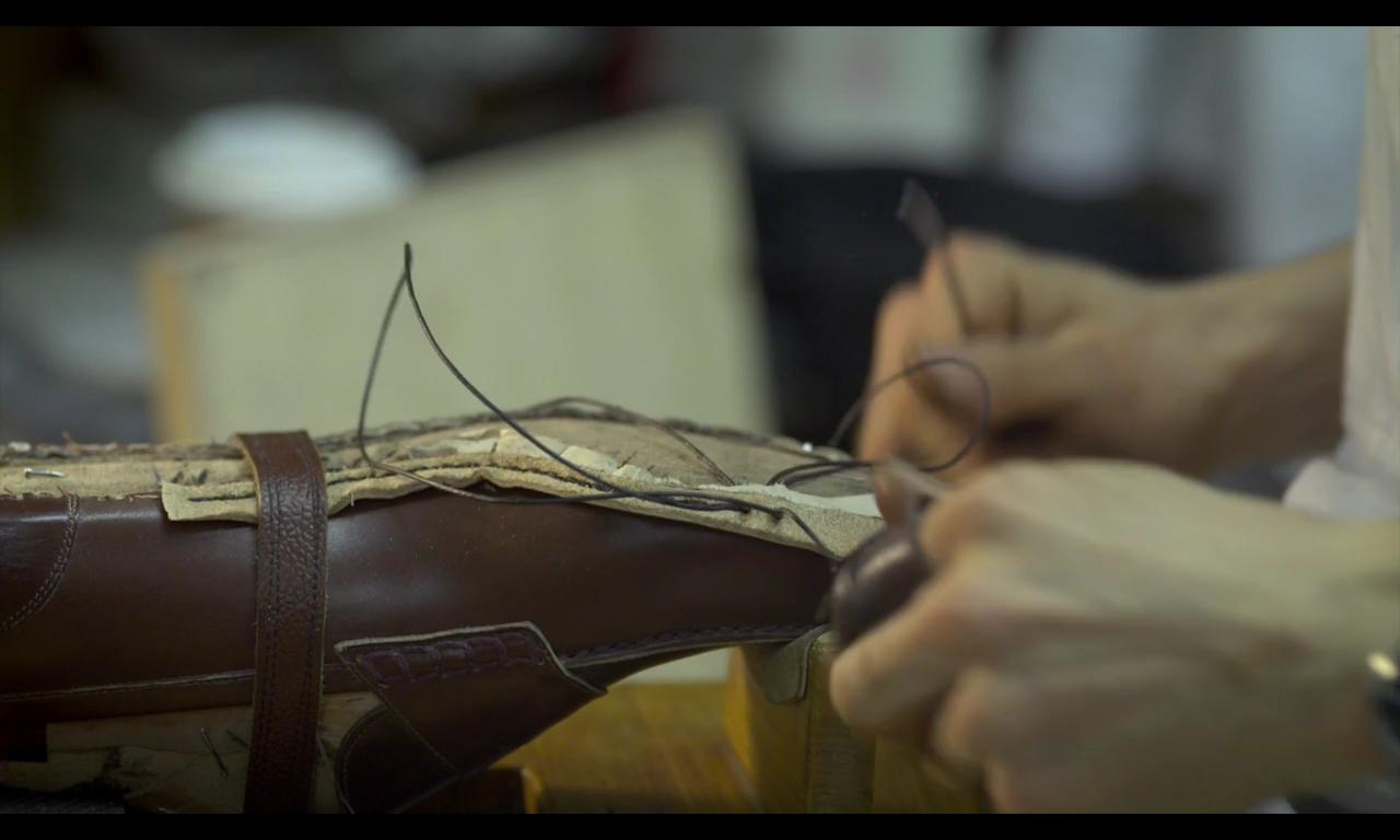

Perhaps the DSLR video craze has created wall, a place where photographers stumble ? An image should evoke a feeling and footage should tell a story (theres always exceptions). Should the entire Brides face be in focus ? Is the answer that simple, what do you want me to see? If there is a label on the hat, let me see the entire label, is there something on the brides nose? if not, let me see the entire bride.
Some latitude should be given to the F3 videographers as the story was showing off the F3, some critique to be given that some footage should have given us a wider variety of shots, DOF and scenes the camera is capable of. But maybe a stern lesson to ourselves about what "focus" really means, where it should be, what we are trying to convey and whether we are pleasing ourselves or an audience.
As an image what does this grab say, as footage does it miss ??
