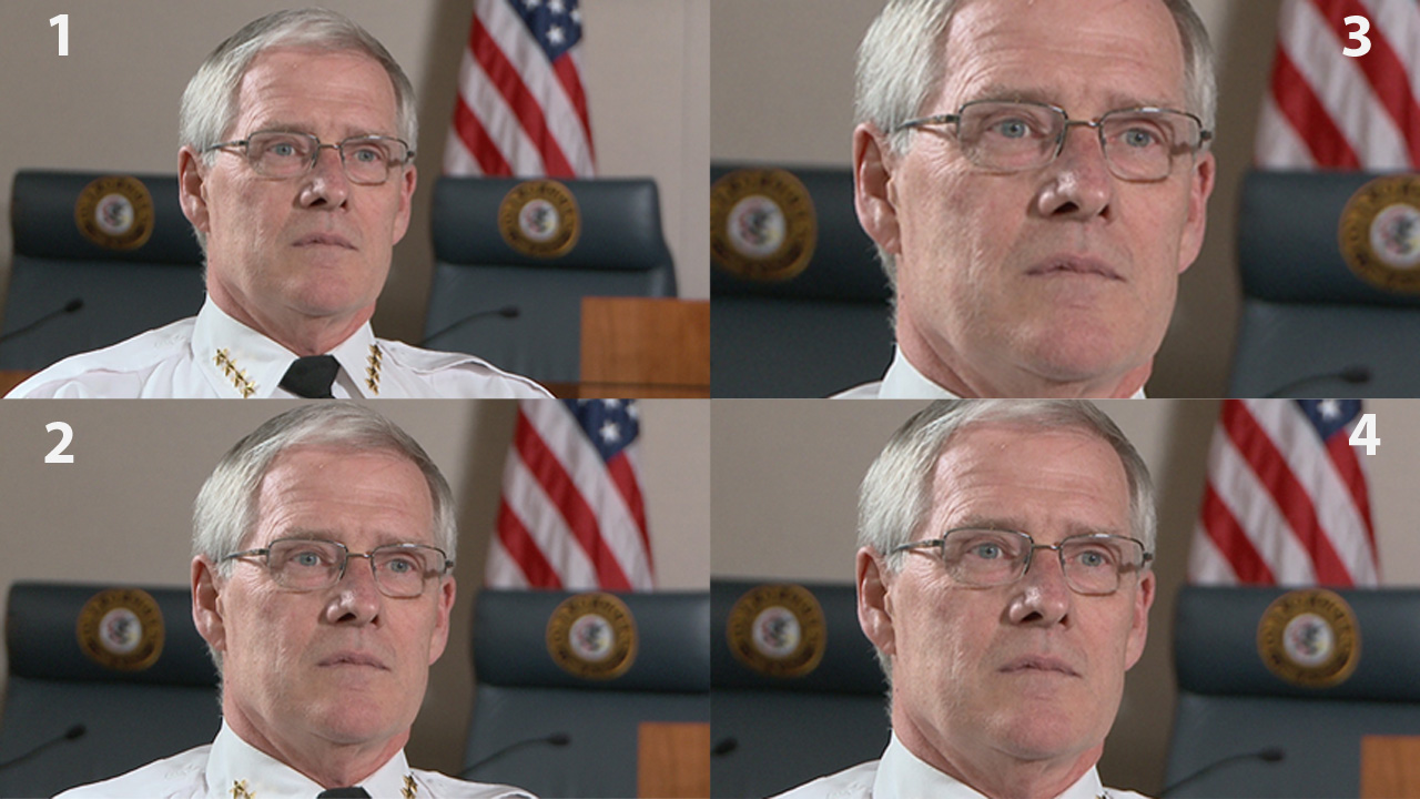

To those discussing how to establish the shot and sequence: is it normal to begin with a wide shot such as this video below?
If anyone can, please comment/criticize on this video, specifically the areas that I have control over (so, not the actual content/questions). Thanks.

Nice work Steve... You asked about the opening -- it doesn't look right to me at all. Unless you have music, gfx and/or VO covering it as part of the intro, I wouldn't use the wide shot until at least when she starts asking him the questions. We need to see her as she starts speaking - also so we can see her name key. I'm guessing you were doing one camera and the other two were locked off. For variety you could walk back and forth between cameras during the interview and mix up the shots a bit. Or just operate the camera the guest is on, and mix up the framing size a bit. You could even go for an over-the-shoulder shot once in a while -- when she starts asking a question zoom out quickly and get a wide shot. Then either zoom smoothly when he starts to talk, or crash zoom back in onto the medium framing of him just before she finished her question. Adds a little variety. Also the wide shot doesn't look quite right to me, seems like the camera needs to be tilted down and be a bit wider. Otherwise this is looking really good. I'm glad you've posted this stuff Steve it's got me thinking about how I would handle a request for this kind of interview.

The WS is kind of stuck in no-man's land: it can't really be used as a cutaway camera, because you can see both sets of lips, and it doesn't work when the talent is speaking (as in the open) because it's so far to the side.
I suppose you could set it up with the talent to do a turn to the WS camera, after her intro--but before she asks the first question--with a turn back to the interview subject. But having her continue her opening spiel on a different camera just looked a bit weird to me.
You do get extra credit for trying to work three cameras in with only one shooter, though!

FYI, I had 'nature' calling towards the end of the interview and when I came back, it was finished and my assistant had gotten that wide shot with the EX3. I then got some wide shots from the other side but those don't work because the talent are on the wrong sides of the frame. We were using only 2 cameras: an EX1 & EX3. The wide shot was done after the interview finished.
So, would that wide shot work anywhere or should I scrap it and stick with 2 camera angles?
For future reference, is it standard practice to alter the framing during this type of interview? I shot in 1080 and edit in 720 so I can make certain shots tighter such as when he is talking about Vietnam - what say you?
I have another interview this Wednesday with the fire marshal in one of the fire stations, and I hope to use the lens near full tele to get a fire truck in the shot behind the fire marshal. So, how tight can I get for this type of interview? See image below.

Shot sizes can change, especially during a long interview. Although, I'd tend not to go tighter than a CU for most interviews, you need really intense subject matter to justify using a BCU. These are normally done during shoot, rather than in post. Just change shot size when a question is being asked and you use the interviewer shot to cover the change. This can be done using one camera, you just shoot the reversals after the interview and the reporter repeats the questions - standard broadcast stuff.
Two shots are standard fare, just go more over the shoulder rather than from the side. On a long interview you can use these shots to break up the I/V or shorten answers These can be shot after the interview.

Yes - wide shot doesn't work as is. (Though I've seen a great deal worse. :-) )
I think a big problem is the timing - you cut to it just as the reporter introduces herself, and I feel that's when we most need to be seeing just her.
It may work if you delayed the cut a few seconds to her words "Featured in this interview... (cut) ... is newly appointed etc......" She introduces him, we see him at the same time - pictures match the words.
