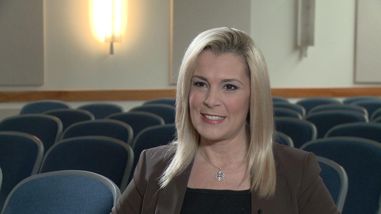

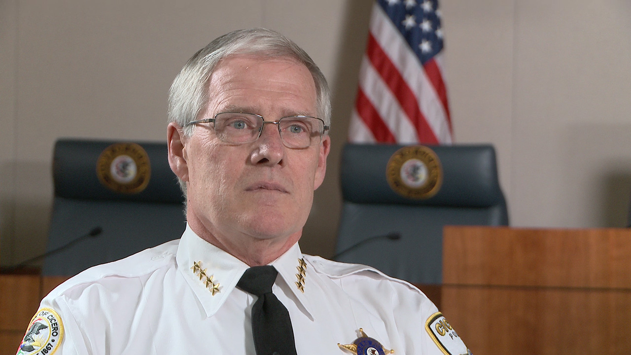

She is solely the on-air talent and I am everything else (DP, editor, cameraman) in addition to a 2nd cameraman. However, she does sit with me during editing to put together news pieces, but for everything else, I have full control over editing.
For our studio lighting, I understand that having flat lighting is the norm. In the studio, I use Kino's- 2 Diva 401s for key/fill and 2 Barfly 200s for backlight and greenscreen. For interviews, I use the Barflys for backlight and painting the background, and I am adding 2 LED fresnel lights to the mix (Litepanels SolaENG 3).
Here are some screen grabs from the interview 2 days ago. Due to time constraints and only 1 inexperienced assistant, this is what I came up with. Feel free to criticize.

May not be exactly be what your asking, and it may sound wrong to some, but there has been a long standing belief that the artistic styles seen in movies and such do not belong in journalism. I guess the hard stance is that tragedy and art do not go together. That straight forward statements and hard lighting add to the overall mood in journalism that it is supposed to be truthful and neutral. It is slowly loosing out to what I call dramalism :(

Hmmm...long form is a little different and I see why you're concerned about the lighting. Actually, things look pretty good. We have composition with depth and angles. Two-shots can be tough because, technically, both the talent and subject should be lit independently. Is this a one or two camera shoot?

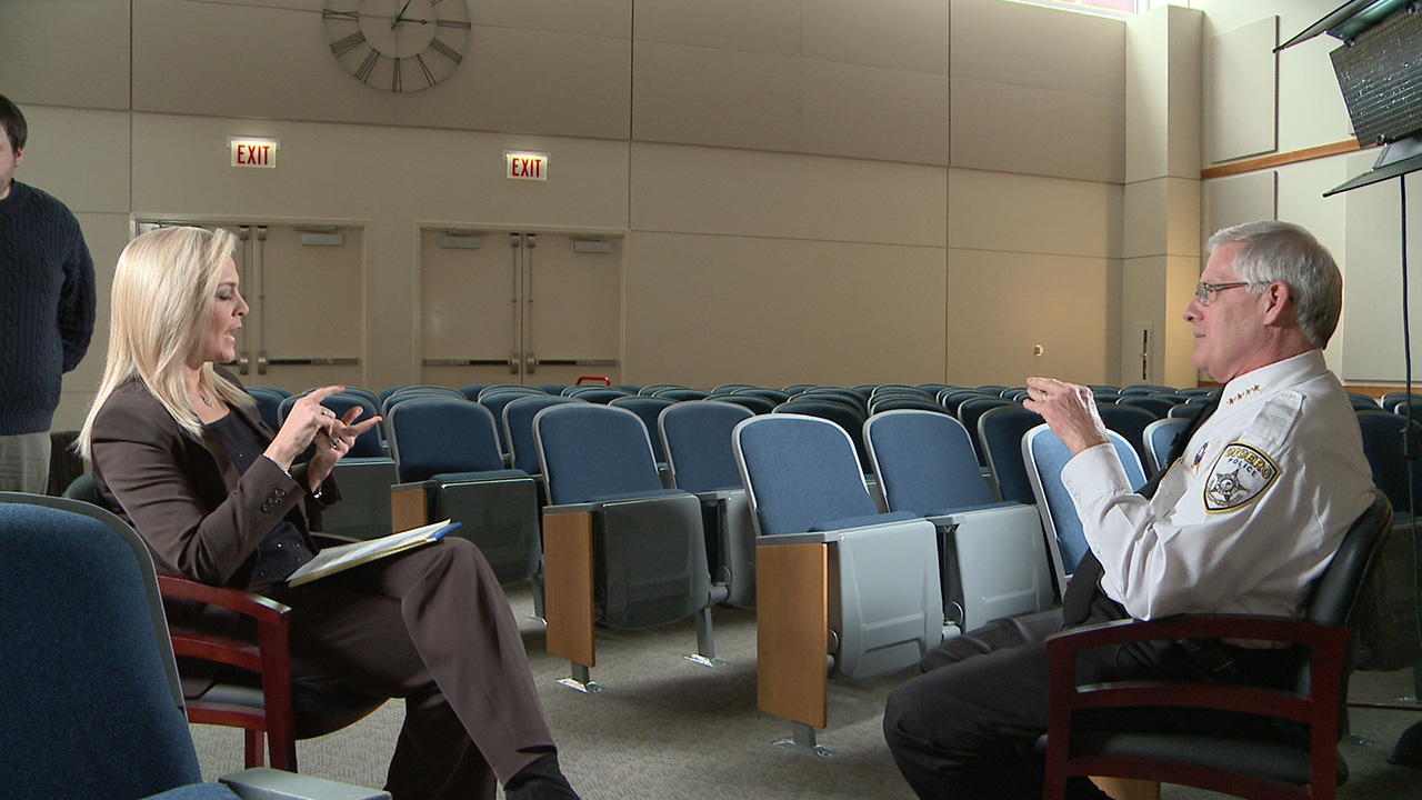

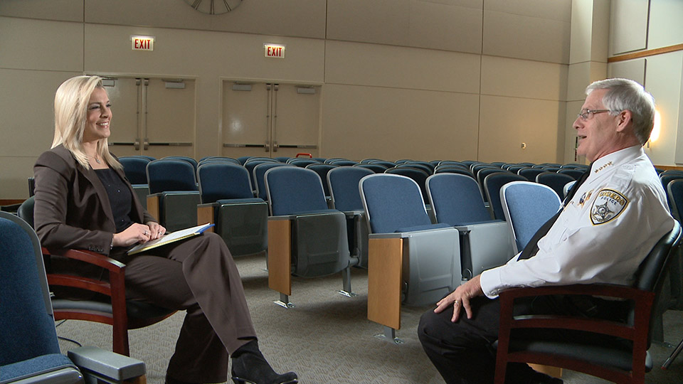

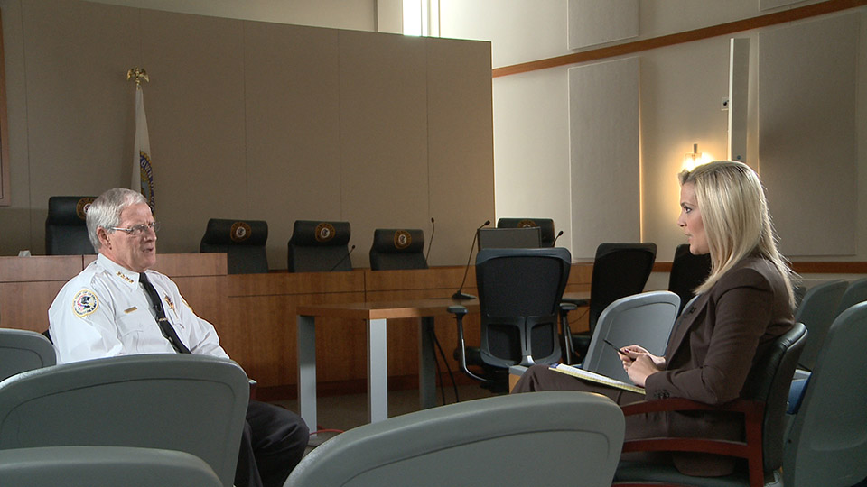

2 camera shoot: EX1 on her and EX3 on him and genlocked together.
This is to be broadcast on a gov't access channel and the web. The screenshots are from a new series called 'Someone You Should Know' and he is the new Police Chief. Next week will be the new Fire Marshall and probably a new city employee or resident every other week. Btw, this interview was shot in the boardroom/council chambers.
If someone can answer this: when is a good time to show a wide shot and which is better? I prefer to follow the 180 rule which means the first shot is the best in order to keep each person on the same side of the screen. Also, both wide shots were done after we finished so the video won't sync with the audio.

Your screen grabs look fine and that is pretty much what to expect for news shooting (I have seen a lot worse) Just one small thing is that in the single shot of the talent the light on the back wall is very distracting and draws my attention to it as it is the brightest thing in the shot, the one on the right is not switched on so I assume it could have been controlled. Also the exposure on the background and talent is pretty much the same, I always try to get a one stop difference between talent and background.

Usually the wide shots are shot after the interview, together with any reverse shots. Where they appear in the cut piece is another matter.
In the UK there seems to have developed a fashion in the wide shot of having the interview out of focus and some meaningless foreground object (like a bowl of flowers) sharp. Another is to have everything out of focus.
