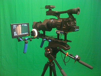

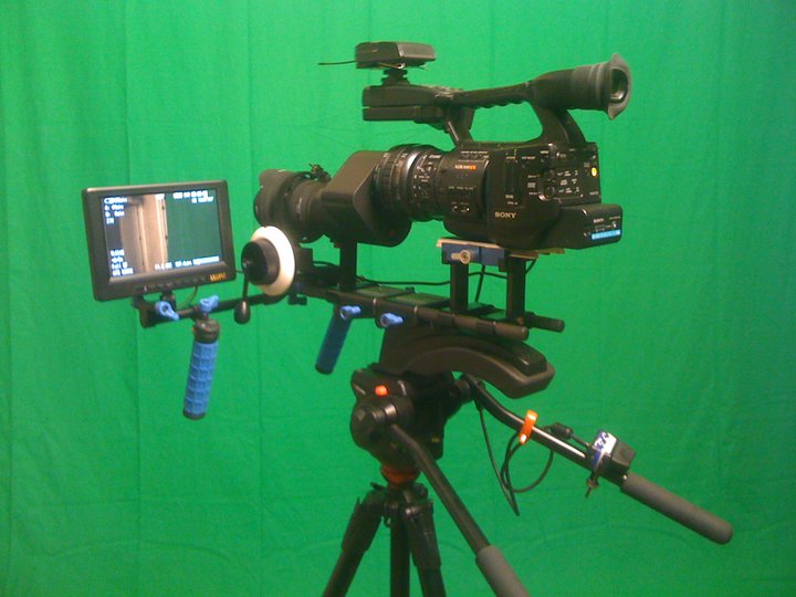

Sure the kit is a bit heavier then an EX1r by itself...but the 501HDV does fine. The tripod isn't used much on these run and guns. We lock off the interview for about 15 min.
That being said I'm open to new stuff...esp if it can help with the budget. The one thing I'm trying to avoid is a studio tripod. I hate lugging those things around. So I'm looking for a nimble yet strong field tripod.
I have attached a pic of the old set up. I have our old DOF adapter on it in the pic (since updated to Redrock M3).

I agree that tripod is not sufficient for the task and is a much higher priority. Maybe check out the Miller Solo range if you want something lighter but still very sturdy. The Libec range is also a good option but are a bit bulkier.
I think you could afford to go without the Ikan Monitor and the follow focus. For interviews you really don't need a follow focus, espescially when using a deeper DOF. Plus you say everything needs to be done in an hour - well with the gear list you have it would take an hour just to set up!
I don't know about the zoom controller either, if most of what you're doing is just talking head stuff. In the example video I didn't see a single zoom. Any zoom you do need to do will be fine using the on camera rocker - when you're shoulder mounted, that will actually be eaiser that using a seperate zoom controller. The only time I need a zoom controller is when I'm shooting events (weddings, concerts, from a tripod where I need to smoothly zoom and pan at the same time so can't take my hand off the tripod handle.

I have that same tripod but for a little XR500v. I have had to use this tripod recently while a 2nd Sachtler is on on order (FSB 8 on order with FSB 6 in use) for an EX1 while the EX3 is on the FSB 6. FOr strictly locked shots, it works ok but its cheap garbage in my book. One of the legs already broke from simply opening the latch to let it slide down.
Also, having that RR shoulder mount on this cheap tripod means not very stable shots when zoomed past 25% if there is wind or the operator has to adjust anything. I rented the RR twice to use on a FSB 6 and had to completely stop using it because of the instability, which is why I now have a Zacuto rig.
I would remove the monitor, follow focus, battery and SD cards/adapters and instead get anything non-Manfrotto and a single 32GB SxS-1 card (the cam includes either an 8GB or 16GB card - my EX3 came with a 16GB 2 months ago). I have rented a $800 Manfrotto tripod kit (w/503 HDV) and everyone I was sent had the same issue with a pop when panning, and even the one in my local Abel Cine has this same pop. Also, the legs were not stable at all.
