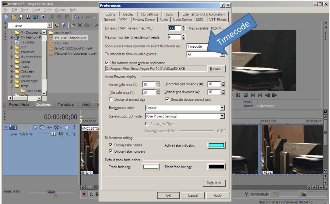

Ron mentioned in passing that some AVCHD camcorders will allow "free run" of timecode. In combination with using preset, this will allow the use of "time-of-day timecode".
That is, the camera's timecode generator just runs and runs, whether you're recording or not. For example, I've got a Panasonic AG-HMC150P in the shop at the moment, it does this rather well.
Anyone logging can use their watch as a timecode reference! (be careful with the camera's timecode preset, synchronize watches, etc.) You don't want to try this for the first time on-set, as using TOD code can be a little finicky to set up.
Then, Vegas has some display options, It's Options | Preferences | Video | Show source frame numbers on event thumbnails as: | timecode, and, Thumbnails to show in video events: | All
This will show timecode as a tooltip-style overlay directly on timeline clips... zoom in and it will show frame by frame, if that's what you want!
Vegas is great for this sort of stuff. I haven't explored the trimmer's capabilities for timecode display because I'm usually syncing multiple sources when I use it, but on the timeline it works great!

Ahhhhhhhhhhh finally the answer from Seth! Funny I had to find a "Vegas user since 1.0" to get the answer. Showing the timecode on the thumbnails is exactly what I needed. I can now log an edit to be made at 5:06 and when I look at the clip on the timeline, I can go right to 5:06 no matter where the event is on the timeline - Thank you!

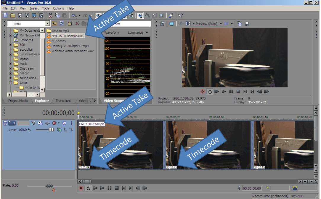

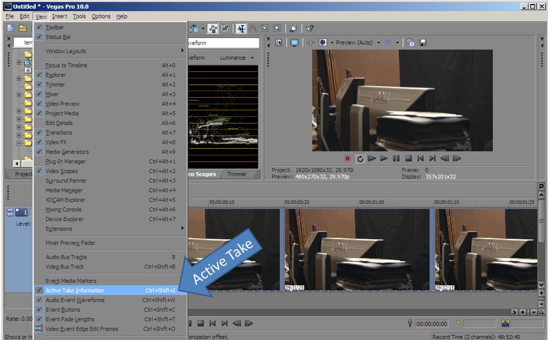

Ron, there are the camera settings for free-run timecode, AND the Vegas settings to display it. Both must be working for this.
Please see the attached snaps for the Vegas setup. This works across Vegas Pro versions...
