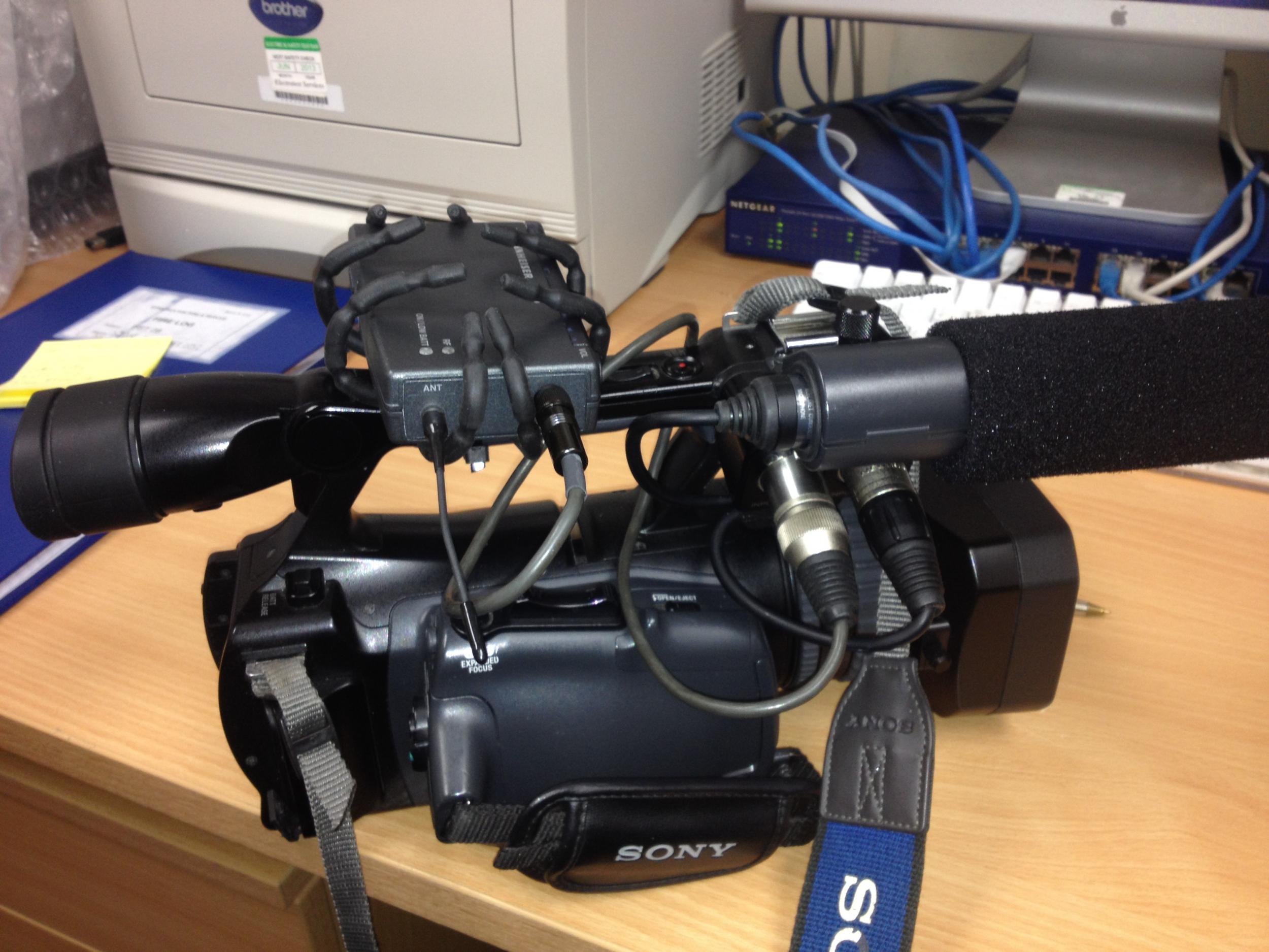

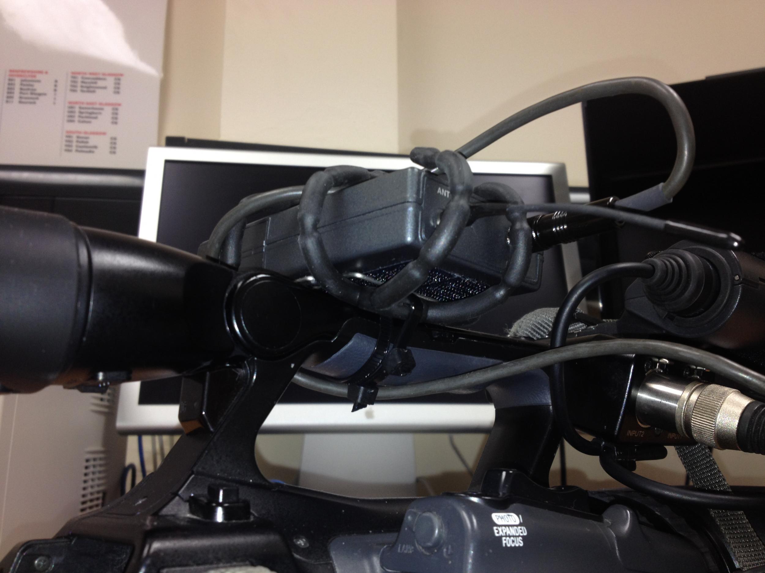

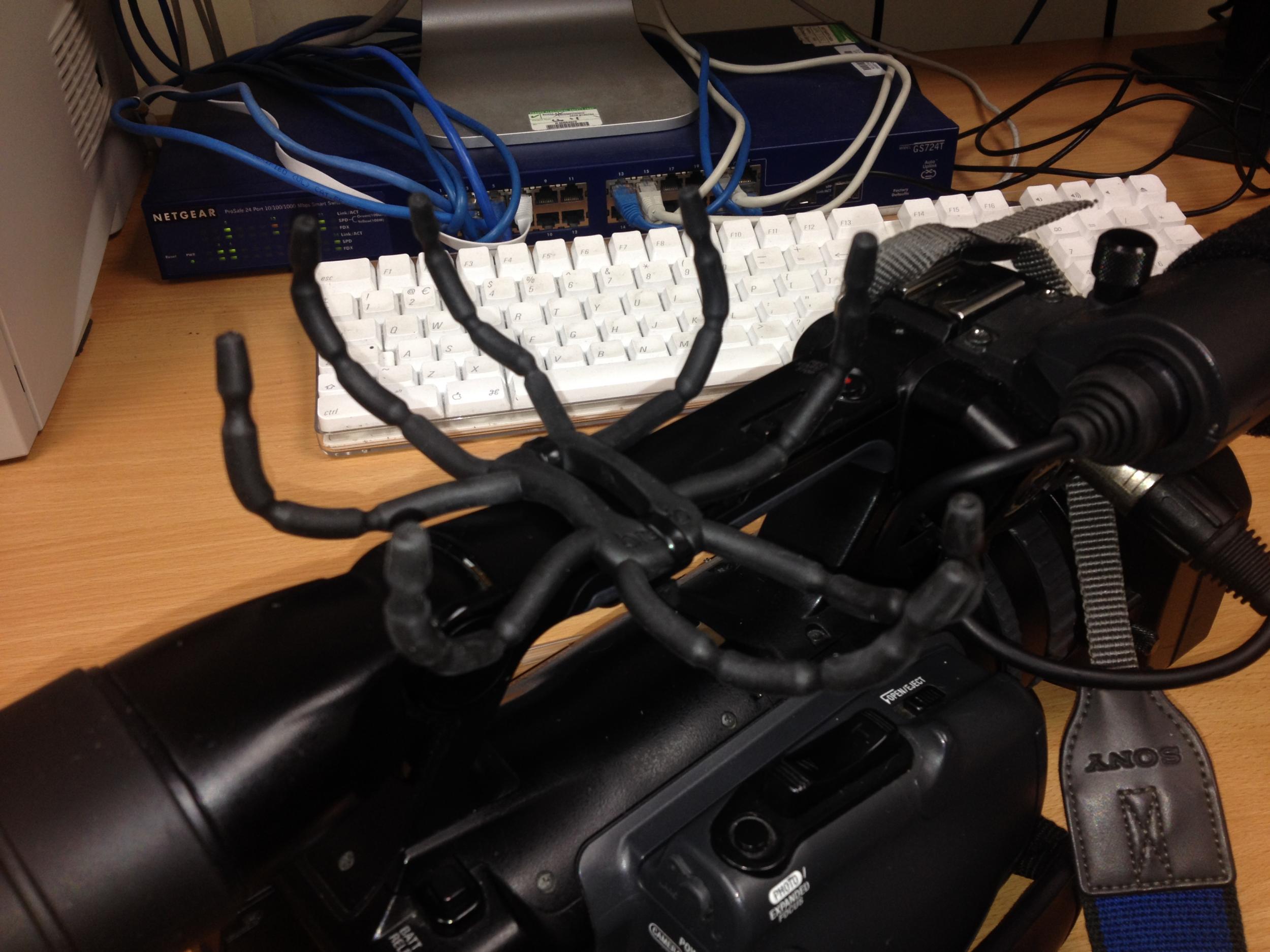

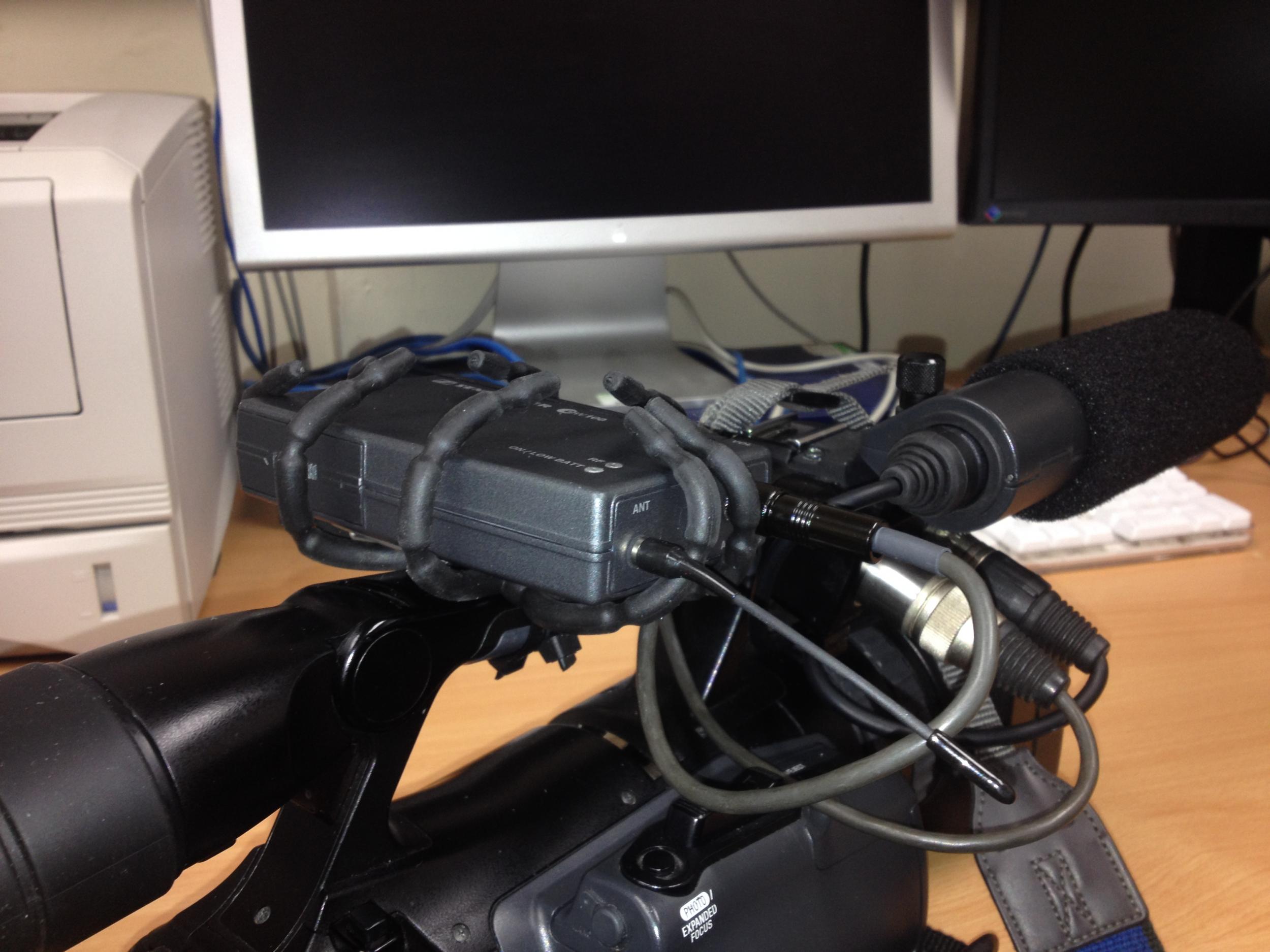

One very minor negative was that , unlike the PMW , and my previous GY-DV500 , the V1 does not have a threaded receptacle in the top handle where I could mount my radiomic receiver ( it does have a front shoe , but I use that for my PagLight ) .
I set to looking for some other means of attaching the receiver to the camera : Velcro onto the battery was one option , but I didn't feel it would be secure enough ; I looked at various brackets that doubled the shoe into two , but I felt this might put too much strain on it , besides them being a fiddle . In the end , I was looking for something that would grip round the handle and hold the receiver securely .
After looking at the websites of various dealers and component suppliers , I ended up going down to my local car and bike accessory shop - I looked at various brackets for fitting lights and things onto bikes , then at holders for mounting mobile phones onto car dashboards - this was where I found the Spider Podium .
It is an inexpensive little thing with eight bendy legs which can wrap around and grip things . I attached it to the top of the camcorder with a couple of cable ties , then found that the legs will wrap around and hold the receiver securely . When not in use the legs can be bent down under the handle out of the way . It remains to be seen whether they will eventually snap with repeated bending - I hope not ! Even if it lasts only a while it was only £15 .
Here are a few photos , and a link to the maker's website at the bottom .
