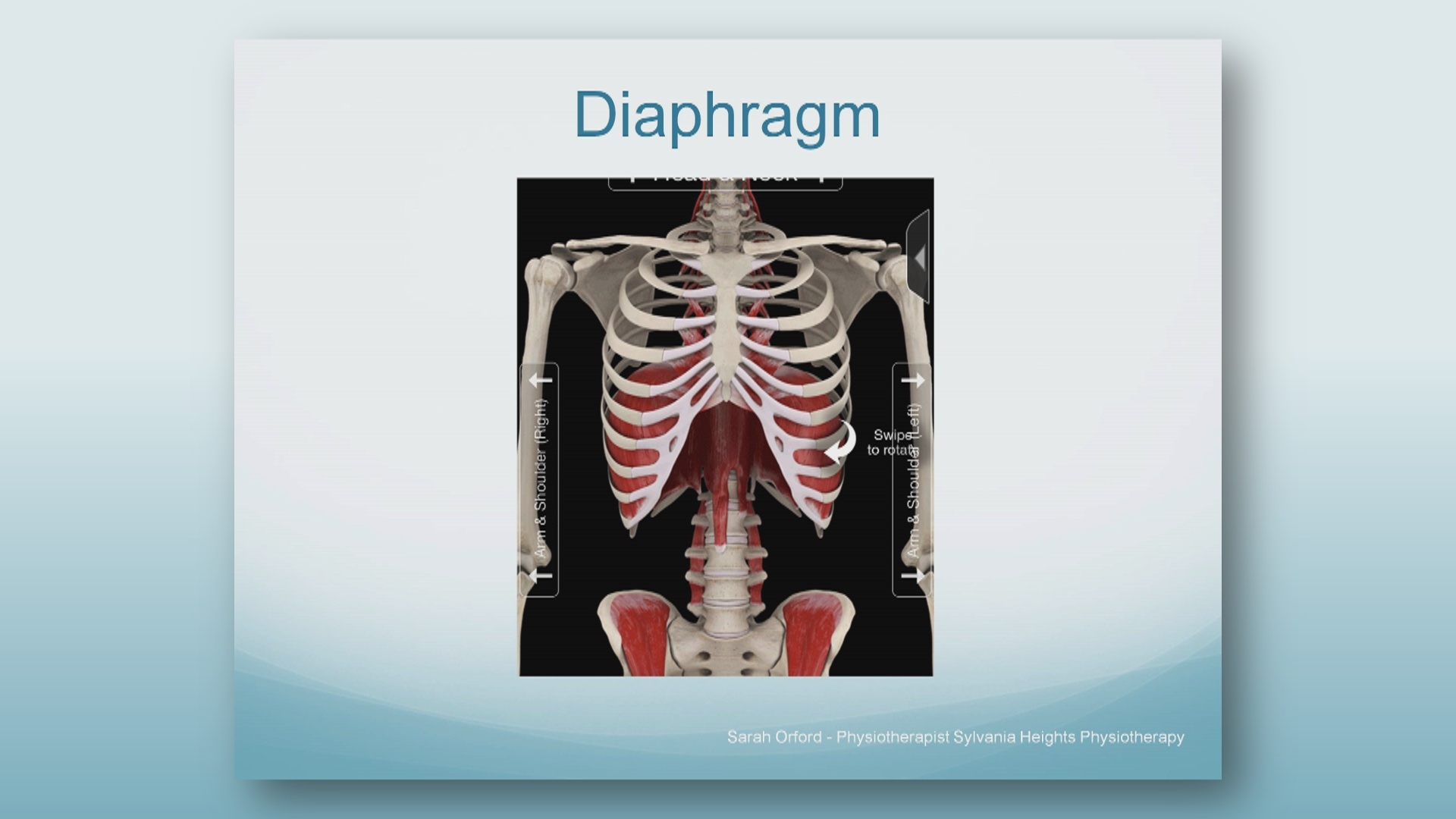

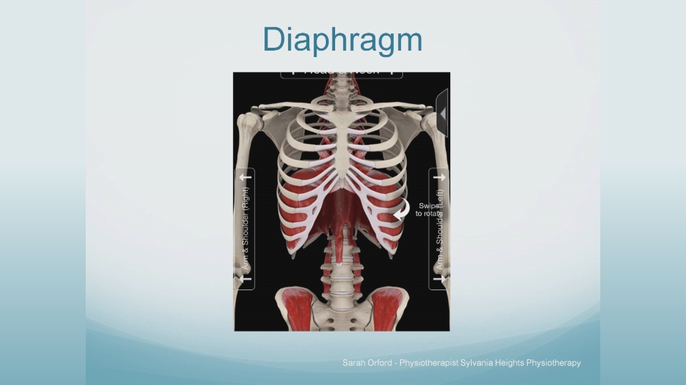

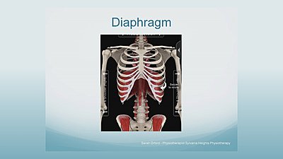

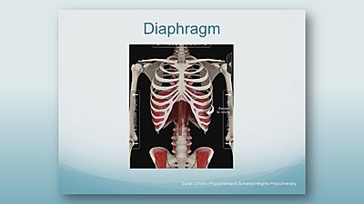

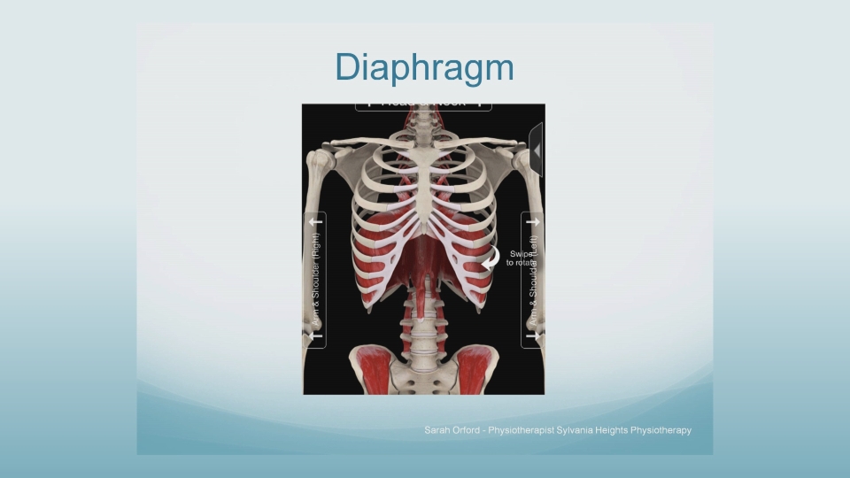

Then in post I normally have the slides on one track and create a somewhat matching grad to go on a lower track to fill the frame. Sometimes I will shrink the upper track to ensure safe area coverage, like slides #02 & #03. If the production has to meet broadcast spec or be shown on TV sets that are looking for a 16-235 video levels I make sure the slides track is scaled to a 16-235 video output level otherwise those slides will be pushing out PC RGB levels of 0-255. A couple of quick treatment examples attached.
