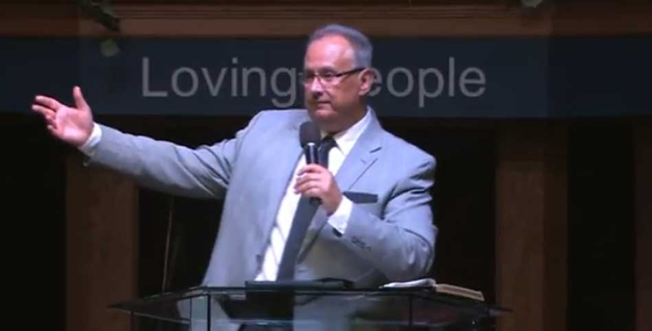

This is more what I was thinking about. Granted, given that he moves about a bit, I otherwise totally agree with your choice.
Andrew
If he is moving around a lot then it is tough indeed to go any tighter at all, especially if all the cameras are unmanned as the OP indicates.
But if you have a skilled operator then it should be easy enough to go even tighter.
