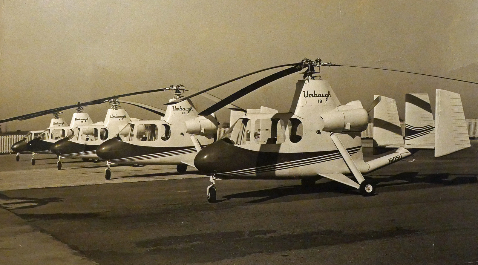

I have a 16mm 400ft reel with sound to convert to 2K on a thumb drive. Quotes are around $390. Anyone know cheaper? Pretty sentimental as it was a gyroplane company advert that I was in as a child in the 1960's.

^-- I'm sure the Costco route would be cheaper but wouldn't look as good...
