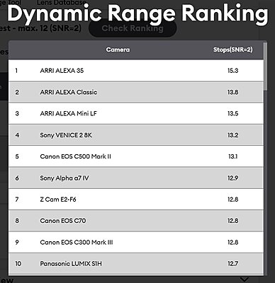

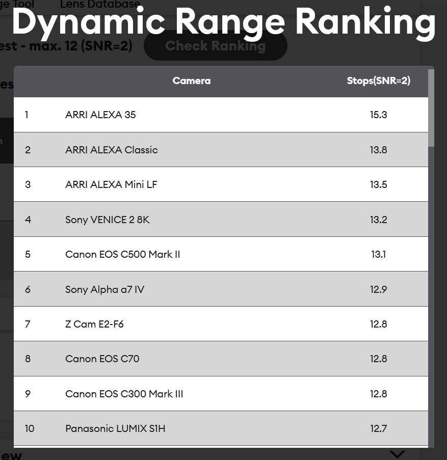

I went with the A7iv for a multitude of reasons over the A7Siii. They are all too numerous to mention here. I will mention a few.
#1 Most important for me is dynamic range, way above rolling shutter for example. In dynamic range only five very expensive dedicated cine cameras had better dynamic range. See CineD's attached pix.
