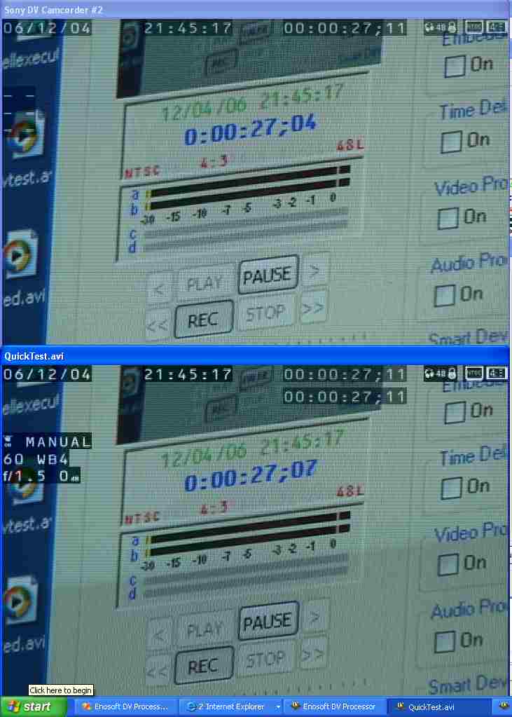

I thought I'd check and, to my amazement, the timecode on the tape is off by three frames compared to the captured version.
Here's what I did:
Set up my Sony PDX-10 to record to tape
Configure my capture program to capture to disk (our DV processor)
Hit record on the camcorder
A few seconds later, started capture
I pointed the camera at the computer monitor to record the capture program - it displays the timecode so I would have easily identifiable frames to compare later.
Then, opened the captured file in the DV processor - configured it to stamp the timecode on the video
In a second copy of the DV processor, cued up the camcorder with the taped version - again configured to stamp the timecode
Cued both versions to the same timecode and compared the frames
The result - see the attached thumbnail (click to enlarge).
Basically, the timecode recorded to tape is three frames ahead of that send via Firewire for the exact same video frame.
(There's also a latency between the camcorder and the computer. You can tell this because when the timecode written to the camera is 00:00:27;11, the camera sees frame 00:00:27;04 display on the monitor.)
Anyway - I'm surprised. I expect the camcorder is injecting the current timecode into the processed DV stream. The latter will be somewhat behind what's going directly to tape since the way DV is laid out on tape is rather different than the way it is packaged for Firewire. Perhaps it takes about 3 frames for the camcorder's firmware to do that...
There are options to get identical timecode on tape and disk:
1. Capture to disk only and then send back to tape IF you have a device that can preserve the incoming timecode (my Sony DSR-11 deck can do that)
2. Determine the timecode lag - for a given camcorder it's probably constant - and add/subtract in Premiere (you can tell Premiere to offset the timecode for each clip)
(The next version of our processor will have the "Embedded Data Processing" feature implemented and that will allow you to add/subtract values from the timecode etc during capture).
I wonder how different makes and models differ in this regard....
