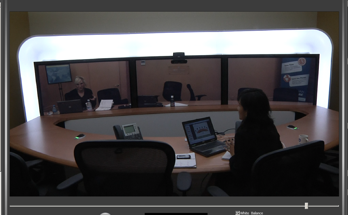

I did a project today that required me to film 3 monitors with bright lights surrounding the monitors. See attached picture.
As I checked out the results tonight, I learned the footage was very dark. I was using automatic settings. I am new to the HMC-150.
What should I have done to avoid such a dark video shot when dealing with bright lights?
Thanks for any help.
Simon

The bright lights fooled the auto-exposure system. For better results you should have zoomed in on the main subjects and set exposure on them and locked it manually, then zoomed back out to frame and shoot the shot. Yes, the bright light would have been even more bright in that case, but at least your subjects would have been at proper exposure.

If you were shooting in 1080i, you could have tried the DRS 1, 2 and 3 settings. This compresses the exposure latitude so the dark is lighter and the light is darker. It makes quite a bit of difference.
For shooting in 30P, the Knee should have been set to low, although in this case, DRS would work better.
You can also adjust parameters like master pedestal and gamma to create a more pleasing picture. You would really need a monitor to accurately fine tune the picture.

Make sure the auto/manual switch is in "manual". Zoom in on your subject. If the iris is in manual mode, turn it to auto mode by pressing in the "iris" wheel. The camera will set exposure on your subject. Then, put the iris in manual exposure mode by pressing the "iris" wheel in again. Zoom back out, and shoot.
