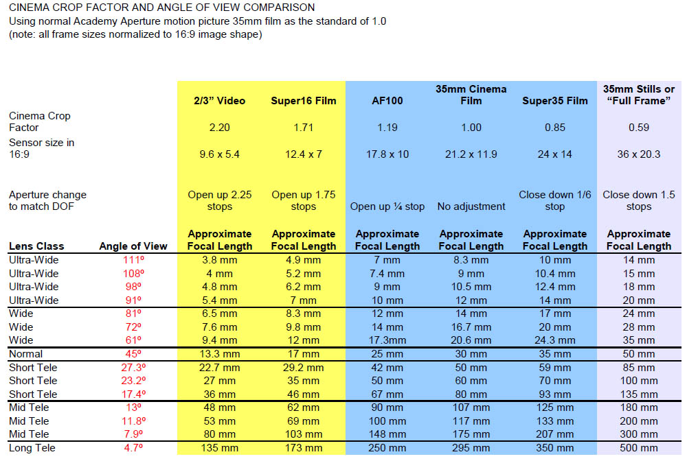

With reference to a full 35mm film frame of 36mm x 24mm I've calculated various crop factors:
AFC-100 17.3mm x 13mm 2.08
Super35mm 24.89 mm × 18.66 mm 1.44
Academy 21.95 mm × 16.00 mm 1.64
Canon 7D 22.5mm x 15mm 1.6
Canon 5D mkII 36mm x 24mm 0.00
If you're use to shooting on Super 35mm however and using 24.89mm x 18.66mm as reference, note the crop factors:
AFC-100 has a crop factor of 1.43
Canon 7D has a crop factor or 1.11
Referenced to Academy size 21.95mm x 16.00mm:
AFC-100 crop factor 1.27
Canon 7D crop factor 0.95
Dennis Hingsberg is offline   Reply With Quote
Old January 27th, 2011, 02:35 PM   #13
Sponsor: Westside AV
Posts: 1,365
Barry Green put this chart together on another forum.
With these comments:
B&H has a nice chart for stills cameras on their site to show the relative focal length needed on various stills cameras to achieve certain fields of view. But it's not very adaptable to the AF100 or cinema cameras.
Here I've put together a chart that shows the sensor sizes of common video and film formats, their Cinema Crop Factor as related to Academy Aperture 35mm Cinema Film frame size, and normalized for 16:9 image shape. It's not all that easy to put together a field of view chart when comparing different aspect ratios, so I normalized all the sensors for their widest 16:9-shaped field of view.
Without further adieu...
Turin Brakes Music video shot on AF-101-cinemacropfactorpresentationchart.jpg

In my own mind (where I debate the benefits and differences between various 35mm video equipment and solutions) I still struggle to find how comfortable I would feel as a DP using this camera for a professional production. It has it's limits is what I'm trying to say, and to me that x2 crop factor is still a killer in my opinion.
I mentioned in my post earlier I don't like using less than 50mm glass and my main reason for this is because of the image distortion that you start getting when you go below 50mm and put your subject close to your lens. Working with x2 really means you are using a wide angle lens like 24mm, bringing your subject closer to get in frame what you would have without the crop on a 50mm lens. This means perspectives are not compressed, and the subject and surroundings inherit the curve of the lens.
For example, in Phil's video "ascension day" if you look at the dolly move with combined head pan (0:12 - 0:20) it becomes extremely obvious what happens when you shoot with an extreme wide lens - the perspective and shape are changing due to the camera movement. I know I am being pickey bugger, but I'm just saying to me that is not acceptable if up against shooting x1 or x1.2, maybe even x1.6 max.
Old January 31st, 2011, 10:05 AM   #15
Location: Toronto, Ontario, Canada
Posts: 287
Originally Posted by Dennis Hingsberg View Post
...and to me that x2 crop factor is still a killer in my opinion.
It's only 2x crop-factor when compared to a Full-Frame 35mm STILL PHOTOGRAPHY camera like the Canon 5DMK2. If you compare it to to the 3-perf 35mm motion-picture camera, then the crop becomes 1.2. Big difference here. Effectively the AF-100 can be treated much like a 35mm motion picture camera when thinking about lens focal-lengths to shoot video with.
This is all about putting your subject close to the the lens and nothing about the focal-length of the lens. A 50mm lens is a very wide angle lens when used with a 6x7 still photo camera like the Mamiya RZ67, because with the 6x7 format a 50mm lens has a field of view equivalent to a 24mm lens would have with a 35mm full-frame still photo camera like the Canon F-1 or Canon 5DMK2.
20 years ago I was a professional stills photographer, shooting lots of studio and location work. I know from experience that ANY lens will start to distort a person's features if you place them closer than 5 feet from the lens. So in shooting portraiture with a 35mm Full-Frame camera, if the subject had a "flat" face I would use an 85mm lens and have them sit about 5 feet from my camera, and this combination would help to "expand" the person's "flat" features and result in a nicer photo. If the subject had a "big" face ( usually this meant big nose and protruding ears ) I would use a 135mm lens and have them sit about 7-8 feet away from the camera, and this would have the effect of "compressing" the subjects features and result in a nicer photo. Simply by changing the distance that the person was from my camera, I could greatly change how the camera photographed them. I would use different lenses so that my crop would be the same a two different distances. ( 5 and 8 feet away )
So using a 25mm lens with the Panasonic AF-100 has the same field-of-view as using a 50mm lens with a Canon 5DMK2 if the subject you are shooting is the same distance away.
So if you are used to thinking in Full-Frame 35mm still photo camera terms ( i.e. Canon 5DMK2 ), a 50mm lens on the Full-Frame Canon has the SAME field-of-view as a 25mm lens on the Panasonic AF-100.
If you are worried about distortion, then position your AF-100 camera EXACTLY the same way you would position your Full-Frame 35mm camera, but use a lens with HALF the focal-length of the Full-Frame 35mm camera. The field-of-view will be EXACTLY the same.
...One more worm to add to your over-flowing can is this: To have the SAME depth of field ( bokeh ) when comparing a Full-Frame 35mm still-photo camera ( Canon 5DMK2 ) with a Micro 4/3 camera (Panasonic AF-100 ) you must close down your equivalent Full-Frame 35mm lens by 2 F-Stops.
So if you were to shoot a video with the Panasonic AF-100 using a 25mm lens set to F-Stop 2.0, then you would need to shoot video with a Canon 5DMK2 using a 50mm lens set to F-Stop 4.0 to create a perfect match to the video shot with the AF-100. The two videos would have the SAME field of view, and the SAME depth of field. ( bokeh )
So the bottom line is:
Canon 5DMK2 with a 50mm lens at f/4.0 produces EXACTLY the SAME image as a Panasonic AF-100 with a 25mm lens at f/2.0
Hope this helps. ( from a fellow Canuck living in Toronto )
