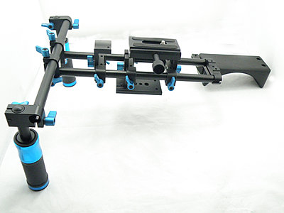

Shucks, I have just seen that the 130 has a Sony style mic holder and not a 2nd cold shoe..I guess that means that there is no way that you could use a Rode Videomic on it?? Anyone know if the 130/160 mic clamp would clamp over the tube section of a videomic if you removed the shock mounting??? The tube that comes out of the battery/electronics housing is just under 1" in diameter.
I can get one of these rigs from SE Asia for around $350 ..they might work???

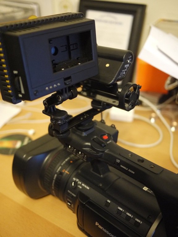

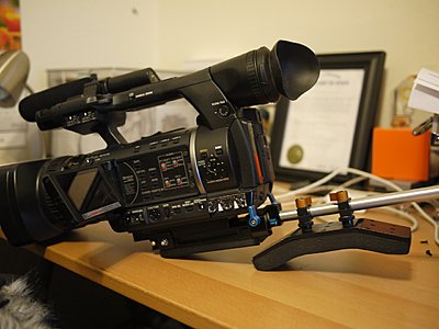

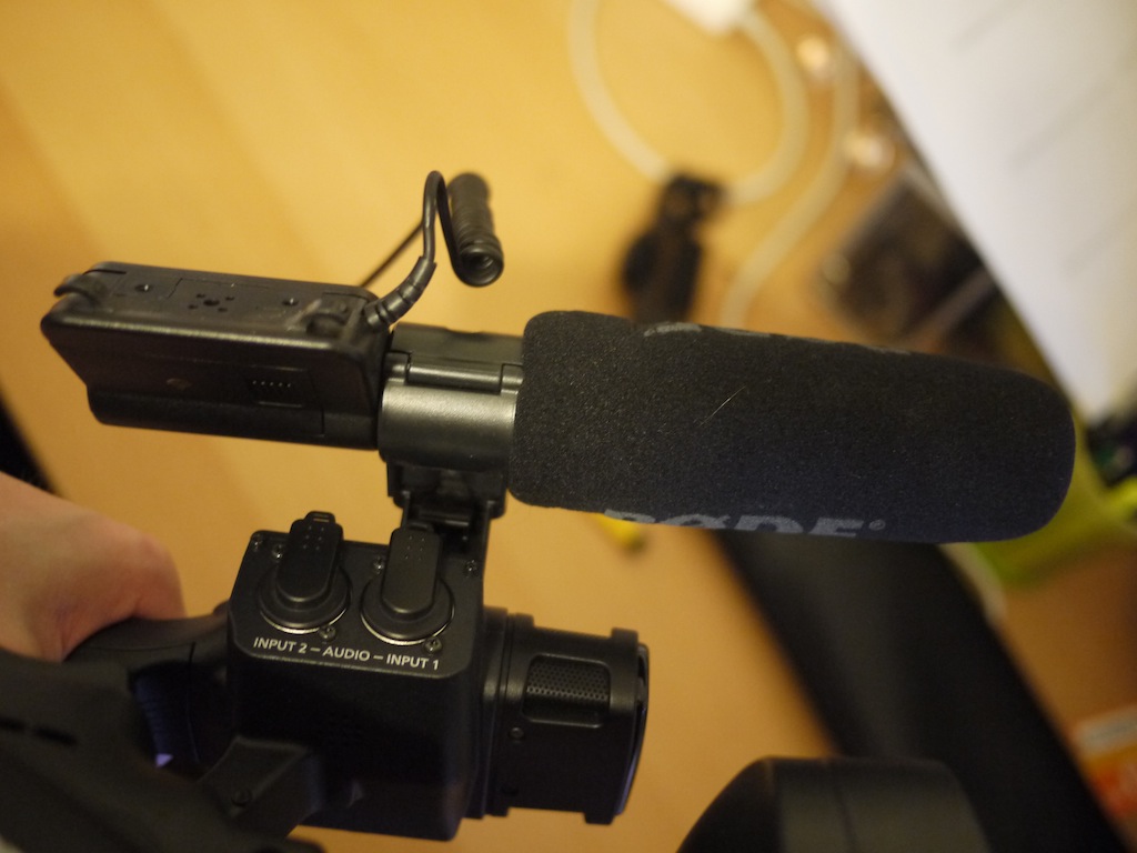

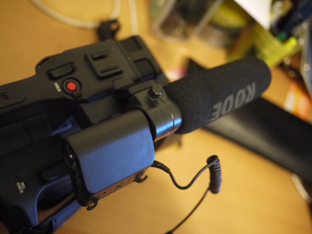

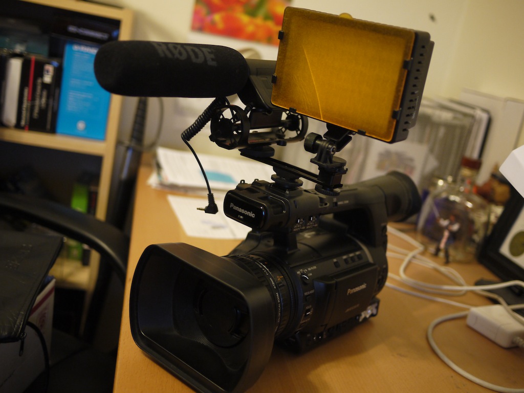

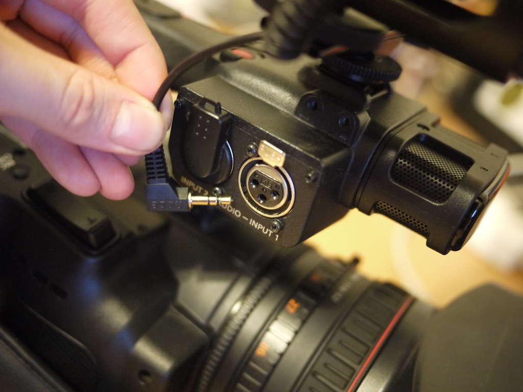

Thanks for the shout out, Chris. I'm waiting for a render, so I tested your theories and took some photos! :)
A few things:
I hooked the camera to my 40" HDTV last night via HDMI and just played around with the picture profiles for a while. You certainly need to adjust the settings a bit in order to get the best possible image, but I think I finally have mine dialed in and I was quite impressed. With the right profile, 12db of gain is almost completely imperceivable - I don't like going much higher than that, but in a pinch I think 15-18db would definitely be usable. Also, if you zoom all the way into 21x, the lens aperture ramps down pretty significantly, but things are pretty good (≈F2.8) up to about 14x or 15x. My point is, I think you'll be impressed with the low-light sensitivity of the cam.
Something to think about is if 1080p60 is a necessary feature. The step-up AC160 is supposed to be getting this in the near future. After the initial release of the cameras, the prices came down a bit for the 160. At current US prices, I might have spent a little more to get that feature... I don't do just weddings, so full 1080p60 might not be as useful for your purposes. Just a thought - maybe even get one of each!
I happened to have a VideoMic laying around, and yes it does (sort of) fit in the mic holder. Not sure what covering up that part of the mic would do to sound, but it stays put solidly. The real problem is plugging in that 1/8" cable coming from the Rode. Maybe I'm missing something, but I don't think there's any 1/8" input on the camera. You'd need some sort of XLR to miniplug adapter.
The camera's mic holder does a better job with the mic than mounting the VideoMic on top with a "contraption" of some sort. In my case, I had a shoe extender I tried out. It works, but the whole thing is just so big and awkward! If you really wanted it to, the VideoMic would work, but if you're getting two brand new cameras, you might as well get a phantom-powered NTG-1 as well. You deserve it, right?
As far as the shoulder mount goes, I tried it out too - quite stable, but you'll definitely want some sort of a counterbalance to make it more comfortable to to use. I prefer to just cradle the back of the camera against the front of my shoulder but if you like a rig, that's cool too.
Anyway, those are my thoughts, photos attached of my experiments.

I guess replacing the mics is not a big deal at all!! However just to confirm, I ripped the 3.5mm 'twirly' cable and plug out my Videomics when I got them and replaced with a decent quality cable and XLR plug so they have been XLR since new!! Probably a better solution is your first pic?? All one would need is an aluminium flat bar with a male cold shoe fitting on one end and then a standard cold shoe above that for the video light and on the other end of the bar another standard cold shoe for the mic. In fact on the HMC82 I had to change all my suspension ring orientations so the mic didn't foul my light!!! By making a custom one, I can make sure the shoes are far enough spaced to work!!!
I have tried 720 50P on my HMC82's and didn't see any huge improvement over 25P so nope the 50P or 60P isn't an issue with me at all. In fact as far as I know Panasonic have decided that the adding of 60P via firmware might not even be possible!!! Seems silly to pay for a 160 when I won't use the features.
I saw your previous pic 'snuggling' the cam and that might just be the easiest way to shoot...otherwise maybe just a simple aluminium rail under the cam and at the rear a pad at sorta 45 degrees...if you have seen the Sony EX3 you can use that cam as a shoulder mount and it's really comfortable but has nothing actually on your shoulder ...as you said, like a rifle butt
Thanks again for the pics!!

Smart idea customizing the VideoMic to XLR! That should work perfect then.
I like the "cold shoe bar" but I'd have to recommend getting a quality one like the one listed by Rycote. I got a $10 one from eBay and it just isn't quite strong enough to trust. Used it once and it bent.
Almost something like this for the brace?: Redrock Micro - microBrace body pad

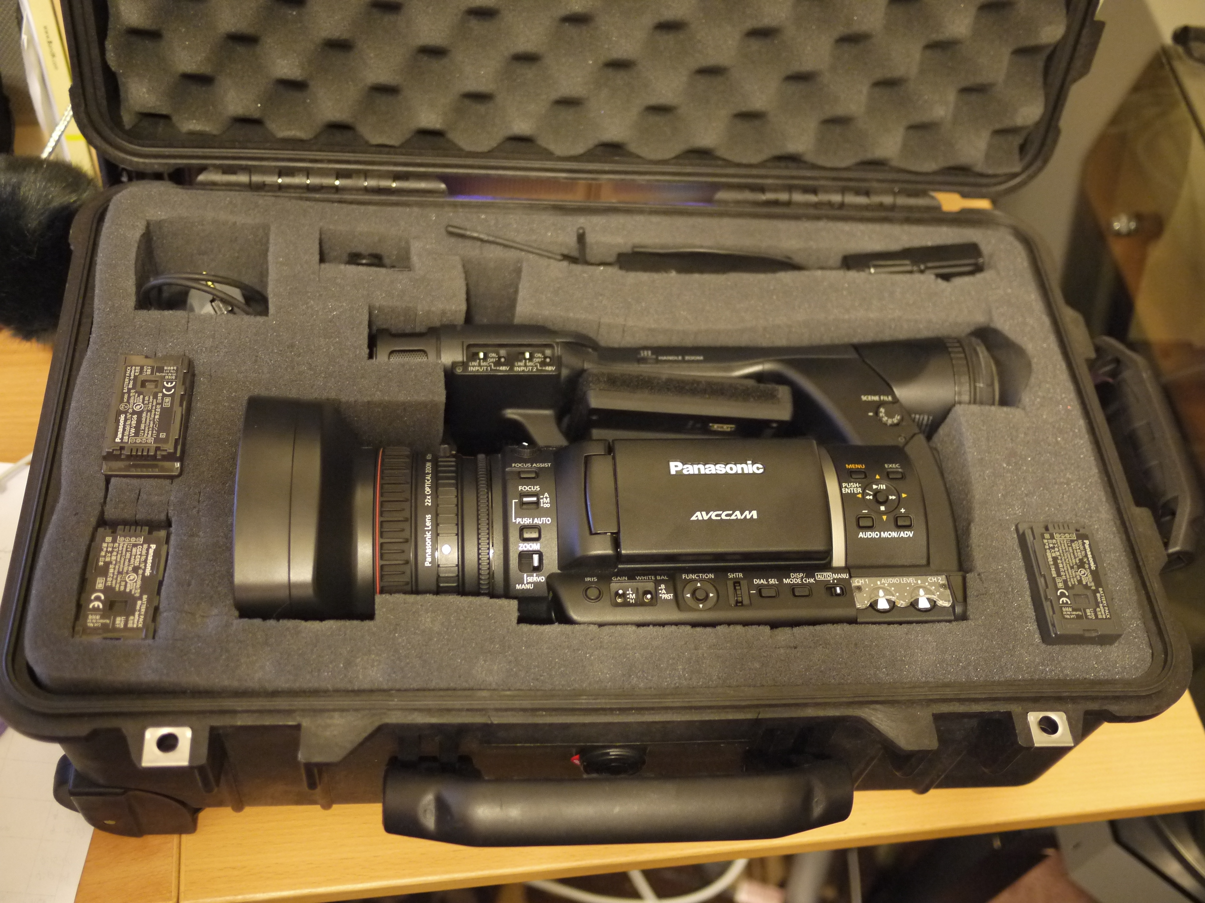

Also, I love the Pelican 1510 rolling case for the camera. If you're into hard cases, it fits pretty well!
