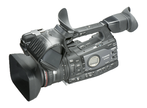

Now, I have also just found the Hoodman EVF that is made for the Canon XF305 and the blurb says "suitable for all 4" LCD's" The 130 has a 4" LCD ....!!! Anybody bought one of these units???
It seems to almost be a copy of the HMC80 flip up loupe with a decent eyecup too and straps over the LCD with velcro .... I think that might be the best option ???? Anyone know if they have diopter adjustment too???? So far I have only found a suitable model from Hoodman.

If you go to the Hoodman site and look for the EX Pro Kit the demo video (all 25 seconds of it) Shows the guy using it on not an EX1 but on a panasonic HPX202 and it looks pretty much perfect!!
I'm still trying to determine whether one needs to buy the EX1 kit as that does say that you have +-3 diopter adjustment (I need that adjustment!!!) but nothing is mentioned on the cheaper X305 EVF.
If it does have diopter adjustment (I think you turn the knob under the eyecup to adjust focus) then I want one or two ... without focus adjust I would think it would be useless unless you have 20/20 vision!!!
I can adjust my rig to suit but I think it would be perfect and you have the same sort of setup as the Sony EX3 ...only thing is you can't tilt the loupe upwards as it's strapped over the LCD.
Anyone else used one on a Panny camera ??? Is the EX Pro kit the better one to buy???

@Chris ... ahhh yes I was thinking sticks and the VF ... totally understand the handheld issue. I removed the VF from my EX1R all together.
I had a Hoodman on the EX1R. It has a diopter. What I didn't like about the Hoodman or any other LCD approach is that the LCD isn't really designed to hold the weight and accommodate the pressure. In the case of the EX1R, the LCD actually flexes outward a little. I found the Hoodman slipping left to right to the point it covered the screen at times or slipped off the edge at others. YMMV
But in the end, the Handycam designs all have the problem of a lack of proper ergonomics and there's little choice but to frankenstein the rig. I think this is why the EX3, H1 and JVC semi shoulder mount cameras are popular.

Yes, the mounting issue does present a problem of course...the EX3 does it the same way as the Panny HMC80 so the LCD is in a proper housing and the loupe flips up if you need it to. I have actually seen quite a few EX1's with the EVF physically blanked off !!
I'll look at the sliding issue...a squirt from my hot glue gun would keep the loupe in place all right but that's a little drastic! Maybe some soft "squishy" PVC on the bottom might hold it better??
The weight is always an issue considering the fact that the LCD isn't supposed to hold any extra attachments but I have also looked at the fact that there is 3 mount holes (2 x 1/4" and 1 x 3/8") in the middle of the AC-130 handle which might lend themselves nicely to some sort of extra support from the handle and down to the actual fitting to take some load off the LCD hinge. Hmmm maybe a little arm extending out from the handle so it hovers over the Hoodman near the eyepiece and a spring or lever arrangement between the arm and hoodman to allow you to tilt if you want to... Using it on a rig you should be able to have the support arm fixed as a support (or maybe adjustable on a shaft with a thumb screw but it's certainly worth looking at so the LCD hinges are not over stressed!!
Nice to know it has diopter adjustment otherwise you have to either add or subtract from the length to get the LCD image sharp.

I have two Hoodman EX1 Pro kits in my hot little hands now...We tried them out in the store and they should be absolutely perfect.
I'll post some pics later as I have a shoot to do but initial "in-store" tests looked pretty encouraging!!
I will need to move my rig shoulder pad closer to the cam by maybe 2 or 3" but that's about all ..the eyepiece fits nicely and fall into a natural position where you can use it.
