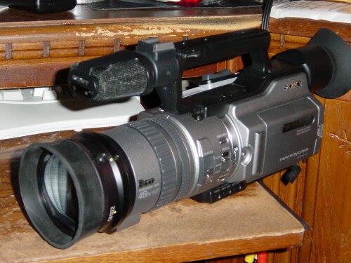

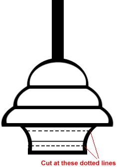

You could try to make a black rubber lens hood from a toilet plunger. Here's a picture.

Brandt,
Not my camera...I picked this up on another site. However, the rubber is stretched over the outside of the lens. That's why the cutout is not measured from the mouth of the plunger. You have to cut at a diameter slightly smaller than the OD of your lens housing. In the picture, the lens is the Century Anamorphic, which I believe is a 72mm. I suspect one could find smaller plungers that would work with smaller OD lens housings.
