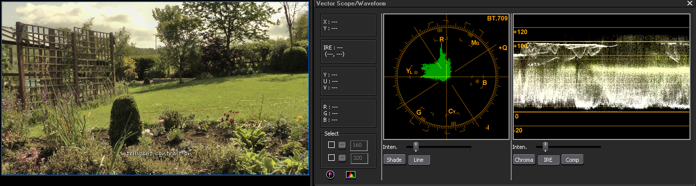

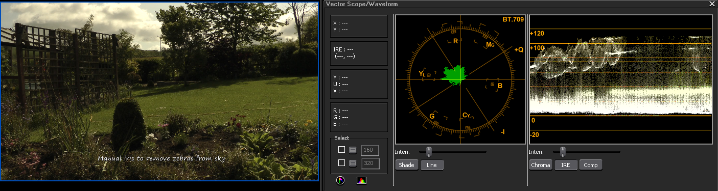

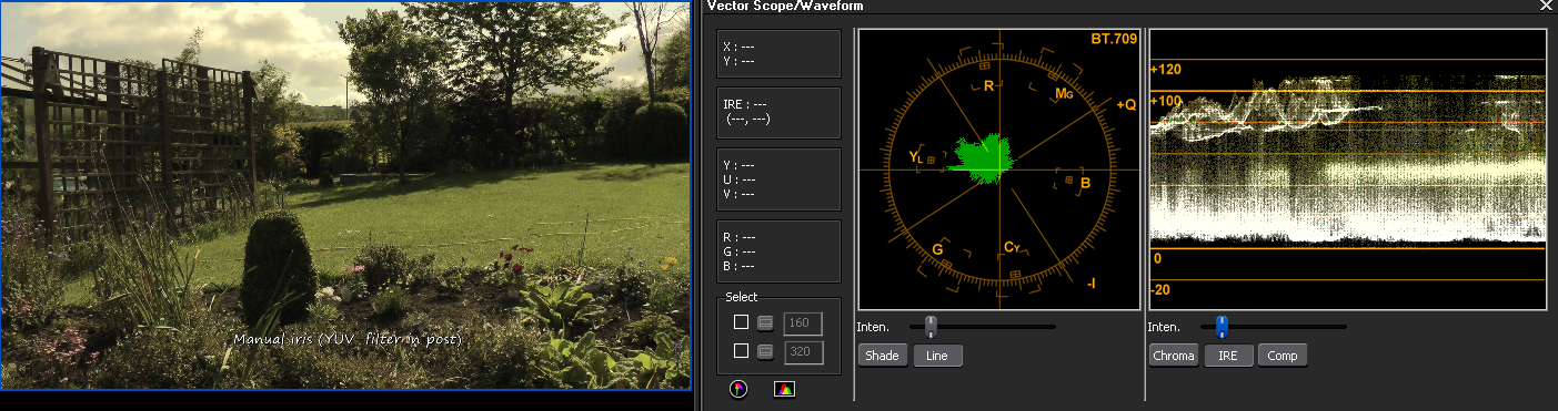

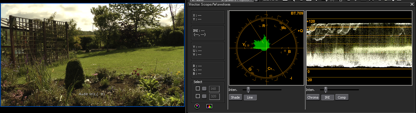

Hi Keith,
I have done some testing with shots taken with Intelligent Contrast Mode compared to auto iris and full manual and came to the conclusion it really does bake in the look, I did not find it possible to recover from it.
Here are four stills takes from 3 clips taken moments apart looking into a bright sky, the aim was to get the best overall exposure, keeping as much shadow detail as possible without burning out the clouds.
The first shot was taken in auto iris mode with -2 exposure set in picture settings. The second shot was taken in full manual lowering the exposure (iris) until zebras just cleared from the sky. The 3rd and final shot was taken in Intelligent Contrast Mode. Note it is not possible to use manual iris in this mode so no way it seems to apply less of this effect.
Notice only the full manual clip maintains cloud detail but the foreground is too dark. However with the overall detail in this shot I was able to tweak some brightness back into the dark areas in post with the help of a YUV filter plus a touch more chroma (the lower exposure also lowers chroma level as seen on the vectorscope left of waveform meter).
The waveform meter shows how severely the luma is squashed for the clip when Intelligent Contrast was used. I was not able to correct from this with out the image looking more plastic than ever.
The Panasonic TM900 Users Thread-auto-iris.png   The Panasonic TM900 Users Thread-manual-exposure.png
The Panasonic TM900 Users Thread-intelligent-exposure.png   The Panasonic TM900 Users Thread-manual-exp-yuv-filter.png

Hi
Thanks for the tests. Ignoring the technical measures for what is best, the best looking picture to me, i.e. how I would imagine that scene to look via my own eye is the Intelligent contrast one, it looks more like sun shining in the garden as I would see it, all the others look quite dreary and more like a dark winters day.
I can see what you are trying to achieve capturing as much detail without blowing the highlights or losing shadow detail, but our eyes blow highlights or lose shadow detail naturally anyway in similar situations, so circumventing that for me personally I think gives rise to a picture that looks less like as "I would see it", even if technically it is the better picture.

Hi Phil,
I do indeed agree the pictures are "dreary", the scene is so strongly backlit I didn't expect much else. If I were taking this shot for purely aesthetic reasons I would never shoot from such an angle (almost straight into sun), such shots are always going to be more or less silhouetted, I have exactly the same result with my EX1R camera despite it's picture profile and gamma options.
All I am trying to show here is how Intelligent Contrast mode locks in "looks" irrecoverably and cannot be undone by grading, that is what Keith asked and so that was my reply to that question, with this difficult shot taken manually it can be graded, still not a beautiful image but in my opinion preferable to the harsh flattened and plastic look.
BTW, I don't agree with your view "our eyes blow highlights or lose shadow detail naturally anyway in similar situations". I just went outside and looked at the same scene again in same conditions and can clearly see the subtle cloud shades in the brightest parts AND the darkest parts of the shrubs while casually taking in the scene. No digital consumer camcorder can do this as they don't have even the dynamic range of film let alone our eyesight.
Maybe I should have chosen a less severe shot for testing, perhaps there are some scenes which benefit from Intelligent Contrast but so far I just don't care for the look it gives when I try it.

Hi
They do, of course when you look at the sky your pupils contract, just like the iris of a camera, you can't stop this happening. Because we really only see in detail a very small circle in front of our eyes, we don't necessarily notice (except in particular circumstances) details of darker areas in our peripheral version becoming silhouettes as our pupils contract looking at the bright sky. As you look around a scene, your pupils are constantly adjusting.
The best demonstration of this comparing directly to a camera is when you are talking to someone sat in front of a bright window and they are in silhouette and you can see little or no details in their face, it's black, we are all familiar with that happening. With a camcorder/camera you would use backlight compensation and blow out the bright details around them and bring their face out of the shadows. If we had conscious control over our own eyes, we could do the same, and do you not think in such a case the view outside the window would not clip and turn to white losing all the detail?
I'm not saying a camera or camcorder has the same dynamic range as our eyes, but the principles are the same. You can even see noise in near darkness where your brain turns up the gain :)
Intelligent contrast has done a good job, it isn't designed to be used and still allow a wide degree of adjustment afterwards, as it is a "full auto" mode type thing, so yes it does rather bake the look in.
Sometimes, in order to capture more interesting details, you just have to let something "zebra" in the shot, or get creative with some graduated filters to darken the sky so you can keep some detail, which is probably the answer or something to try in success conditions.
I tend to agree overall that Intelligent Contrast isn't a fix for everything, and your approach with a bit of work in post can achieve as good or better results. Your examples probably were the extreme and quite challenging, just out of those I thought the intelligent contrast one was the better, all the others just appeared too dark and I would have scarified the sky to bring up the details in the shadows. I don't think there was anyway to really make a good shot in such conditions as you say.
