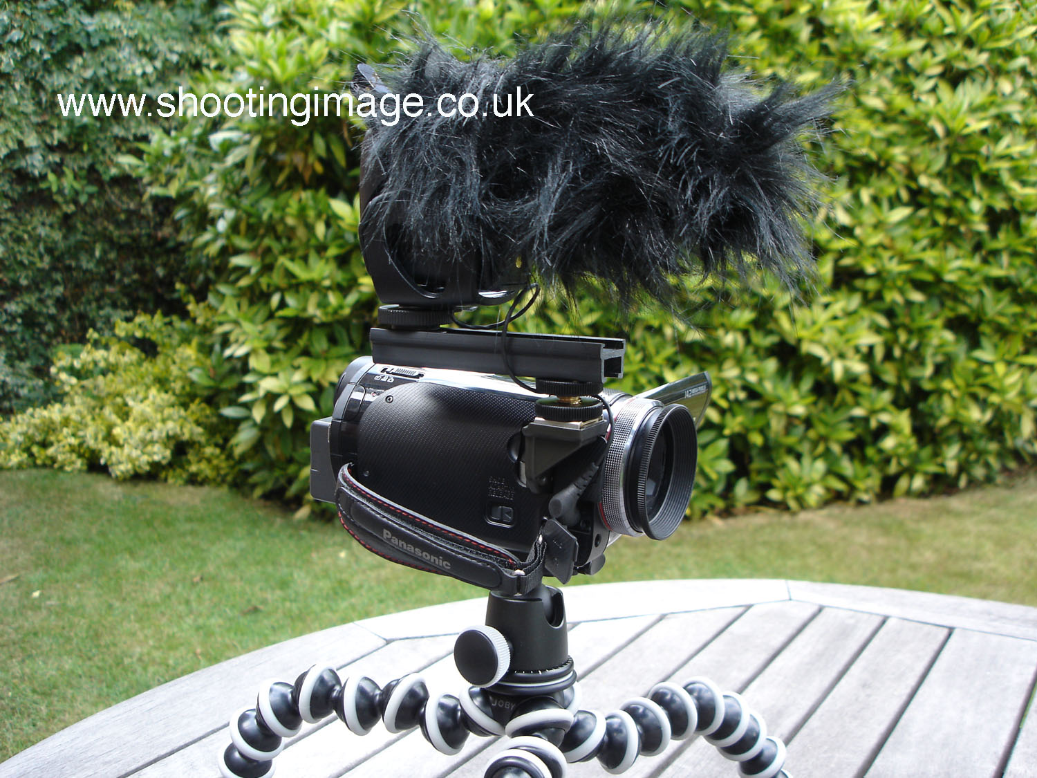

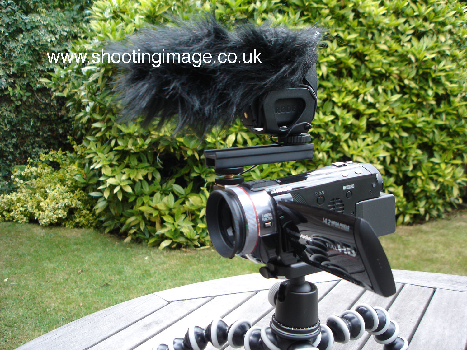

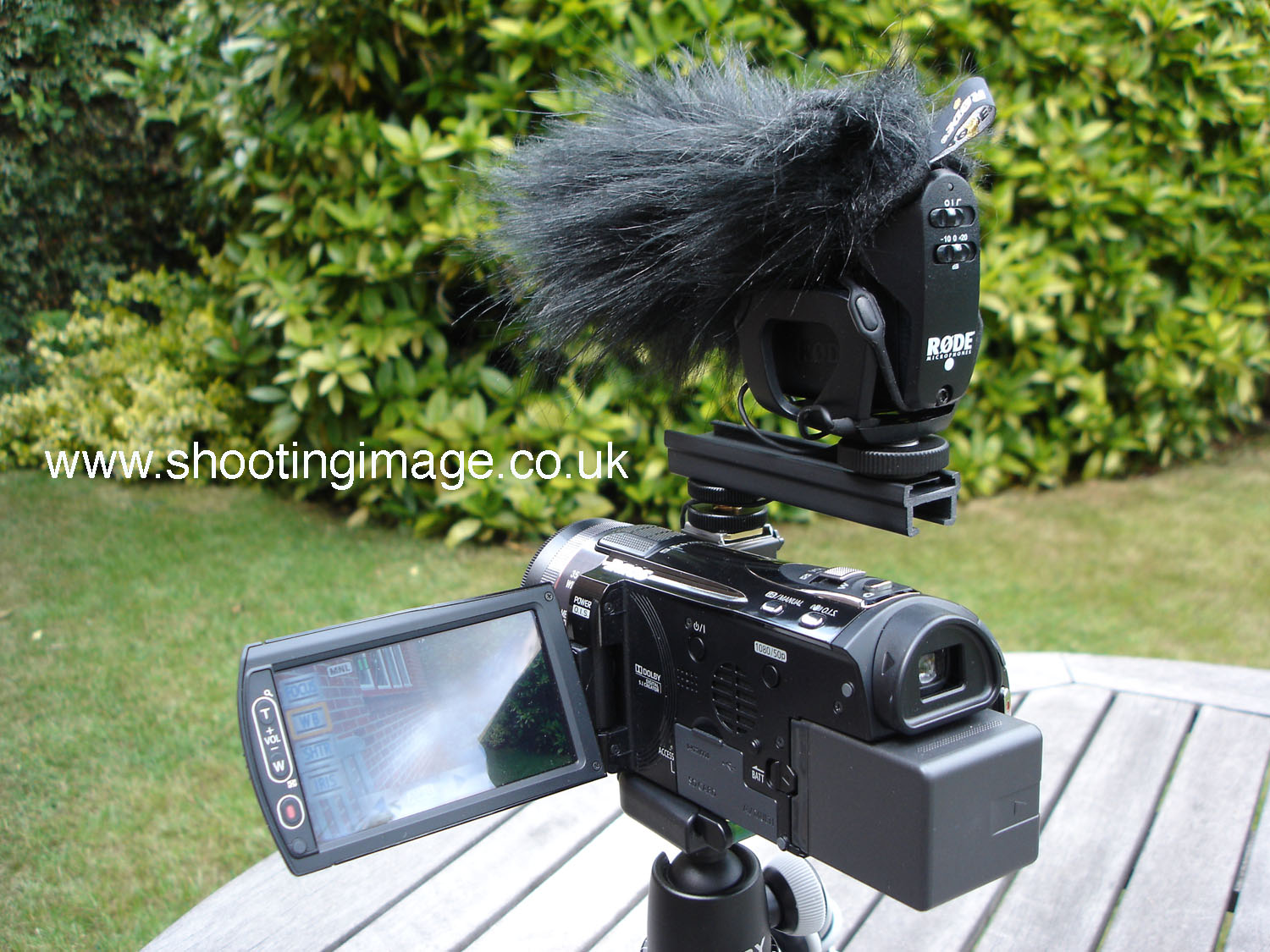

Panasonic TM900 Rode VMP and Deadcat Solution
Hi all,
After a bit of playing around I've found another solution for using the Rode Videomic Pro on the TM900 which enables it to wear its freebie Rode Deadcat and not appear in shot when on full wide on the Panny. This is an alternative way of keeping the deadcat out of shot to mounting the VMP body in the spare Invision Video mount that I have.
It's a 10cm Rycote Hot Shoe Extension (Code 037303). See the Rycote website for full details.
I actually bought this Hot Shoe Extension thinking I'd fit it at 90 degrees to the direction the camera is pointing in (i.e. with it extending out in the opposite direction to the LCD) and then mount the Rode VMP on the end of it in order to get an increased distance from the lens.
However, I found that since the Rode's metal shoe is rectangular, not square, I'd need to remove a few mm off the front and back of it to be able to do this...as there is no point having a shotgun pointing at 90 degrees to the direction that the camera is !!!! I may well get the file out again and do it to give me much greater flexibility in how I mount it... but will ponder it for a while before I do anything too destructive to the VMP's shoe in case I think of a better way.
Certainly, with the Rycote rail in the longways direction it's easy to mount the Rode VMP further back and out of sight of the lens, yet you can still get your fingers around the TM900's body and use it hand held - just - as long as your fingers are not too fat that is! (mine squeeze through nice and snugly!) Snaps below.

The Panasonic TM900 Users Thread-tm900vmprycote10cmext1.jpg   The Panasonic TM900 Users Thread-tm900vmprycote10cmext2.jpg

Originally Posted by Andy Wilkinson View Post
Hi all,
Andy, great minds think alike :) I've done the same exact thing with the hotshoe mount, the VideoMic Pro with freebee softie and the Rycote extension. It works well and the frame is clear. The mic adds quite a bit of volume (space not audio) to the whole TM900, of which it's charms are that it is so small and high quality, but it's all still very light weight with the mic and Rycote rig.
Did you ever mention your picture settings for getting the best high latitude images with the TM900? I've been using the intelligent contrast and then color correcting but since it has to be in auto exposure mode I'm noticing a bit of flickering during some shots shots while the TM900 is adjusting auto so I'm going to go to full manual when I can help it. I was liking the intelligent contrast though because I could really get a range of maybe 13 stops in a scene without blowing out or crushing, with the picture control down to -1 or -2.
I've done a bit of experimenting with manual exposure and the blacks do get a bit crushed but there isn't a lot of noise down there. I wish the color matrix was a bit more tunable though.
I have the TM700 as well and I think the TM900 has greater range and less noise. Thanks to you for starting this thread and for everybody else for sharing.

The Rycote rail is rather expensive for what it is and there are now a lot of much cheaper choices on Ebay now that lots of people are looking for solutions to equiping their dSLRs for video.
In particular search on c shaped flash bracket as these will enable you to add a microphone and a video light at the same time should you wish.
Don't use the c bracket "as is", just use the "c" bit. And attach it direct to the hotshoe using the same type of double screw adapter shown in Andy's photos (which are also readily available. You could of course attach it to the camcorder's tripod screw but you would then loose the ability to attach the whole thing to a tripod plate or ballhead unless also using a further suitable male/female screw; that would however relieve weight stress on the cam's hotshoe.
Pete

Old June 11th, 2011, 04:11 PM   #225
Location: Brisbane, California
Posts: 530
Re: The Panasonic TM900 Users Thread
Yes, Peter, you're quite right. In fact I wound up not using the Rycote hotshoe extension for much else, it was just lying around and that's why I'm using it on the TM900 . There are items very much like this that come with light sets, like the Sima LED lights, and these SIMA lights are sometimes like $10, you could get 4 lights with brackets for the cost of the way overpriced Rycote product. I have several Rycote items, they are well made and sometimes a good deal for the quality, in this case it's an accessory that's in many less expensive forms elsewhere.
