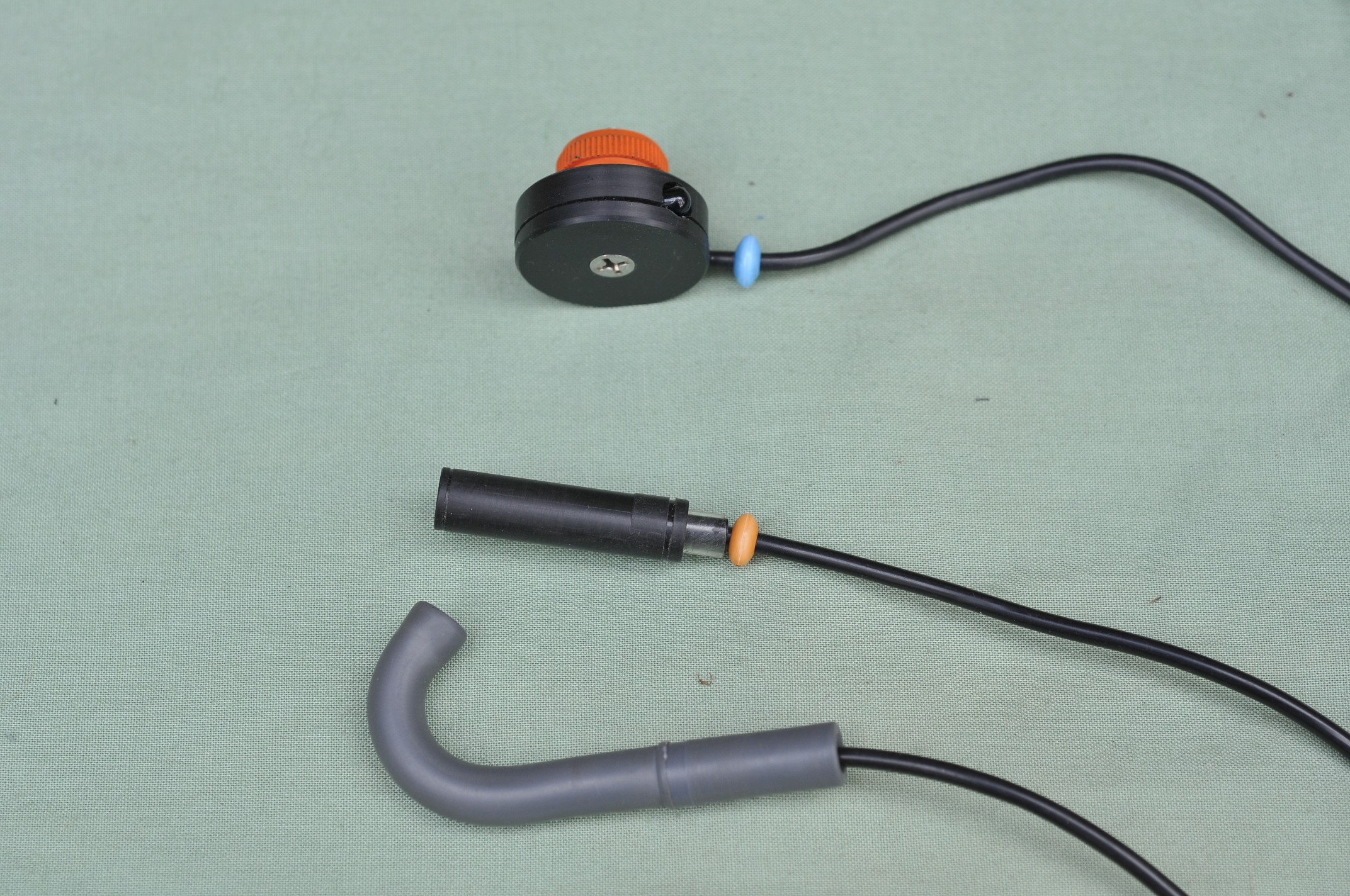

Hi again Mark,
I have two camera leads one about 7 feet long and the other about 25 feet. I can use either or both to together to give a 32 foot total if required. I do not know what the limit is but I am happy with what I have got. The 10 cores all have roles (sometimes more than one) including the option of powering the camera from an external supply, focus and motorized head control.
There is no noticeable delay when using the set-up to control the zoom.
The IR extender has two output sockets so that I can control two cameras from the one point. The sensor for the extender is housed with the DP6 monitor so that I can watch the DP6 screen and with the relevant IR remote run the TM900 and/or the EX3 and the DP6.
I have a selection IR emitters to cater for different mounting options. One is in the lower end of a “J” shaped tube. The long arm of the “J” clips to the bottom of the camera mount platform and the IR emitter points back to the camera. Another clips to the bottom of the tripod head mounting plate, the emitter points forward to a reflector that directs the signal to the front of camera. The advantage of this being that I can use the remote on its own if required.
I have not tried a fibre optic cable but I would expect that there are limits to in the ways they can be cut and joined..
Basically I am happy with the set up but there a couple features of the TM 900 that are disappointing; one is that the very useful prerecord function has to be set in the menu for every shot and the other is that I have no way of manually fiddling with the exposure remotely.
I am very pleased with the remote focus. It is particularly useful for close ups and also there is no risk of bumping the camera when making adjustments. I am full of praise for the blue focus assist function of the TM 900 and I am hoping that Small HD will give DP6 users a blue option.

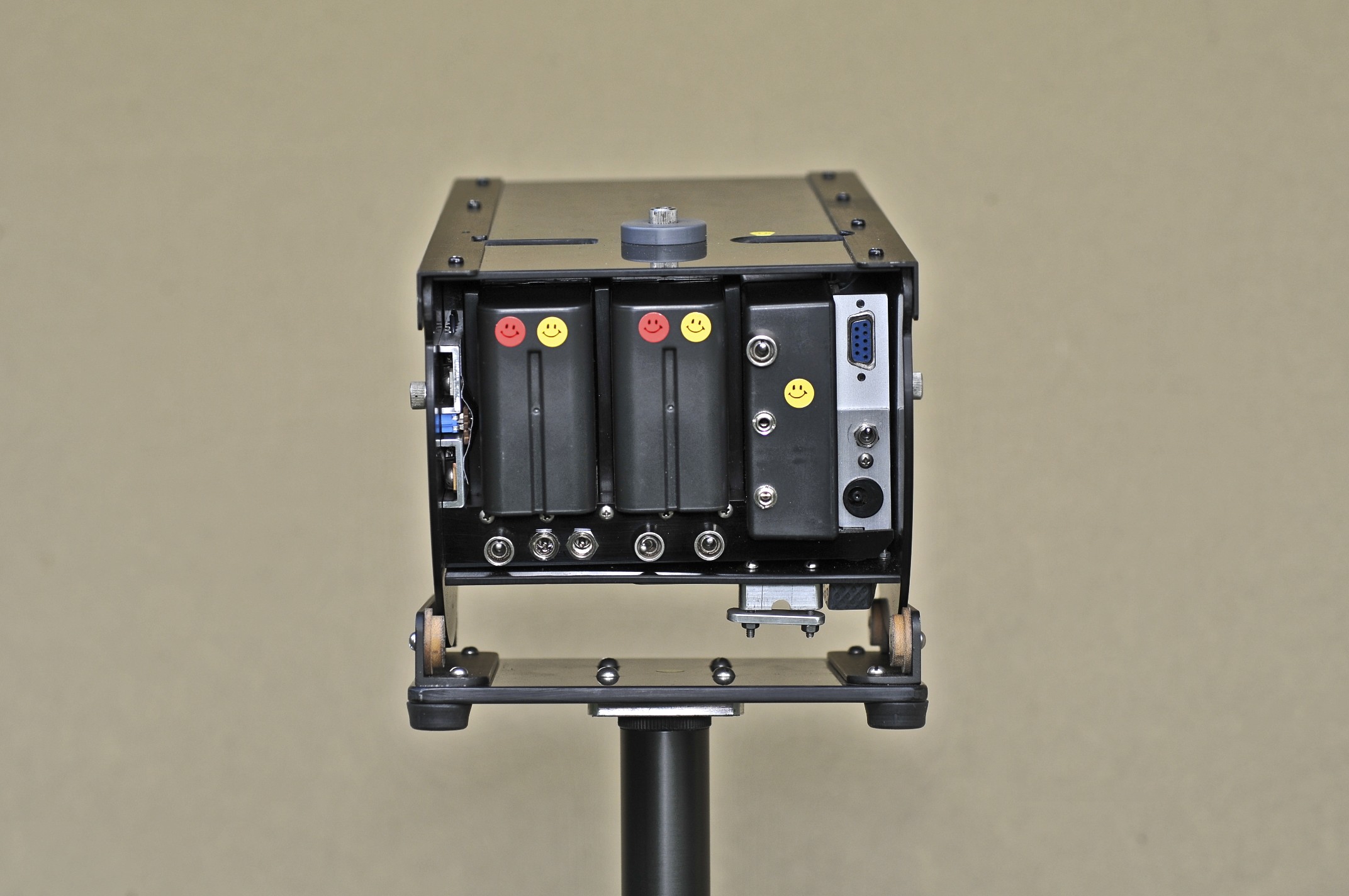

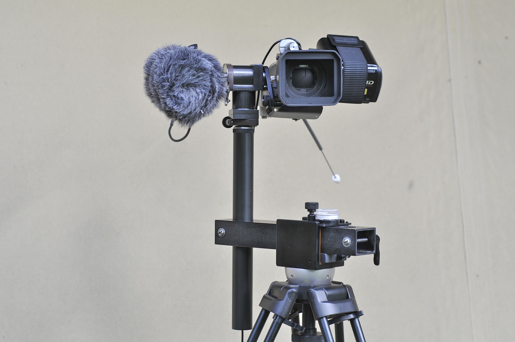

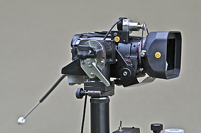

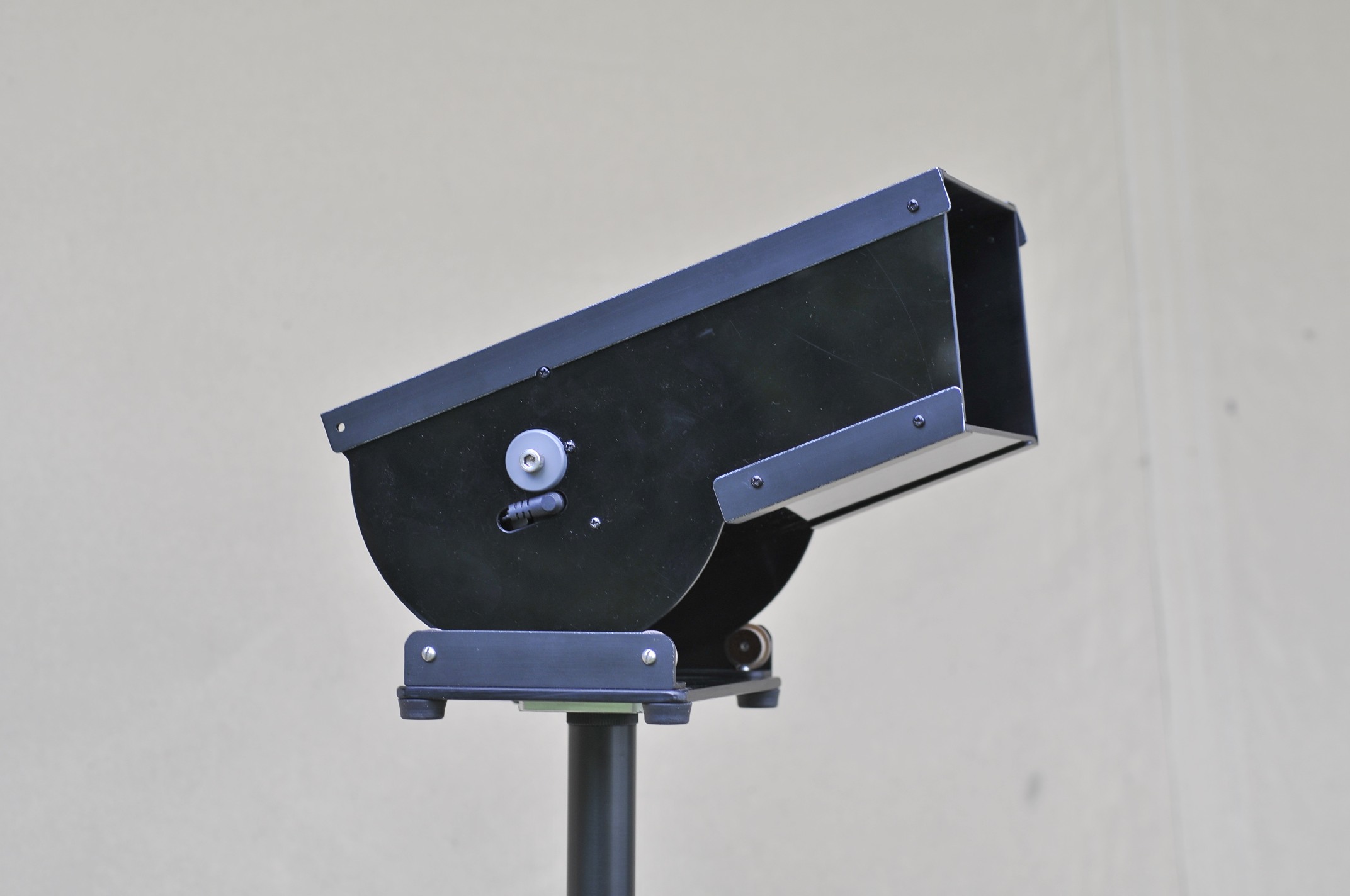

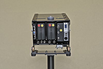

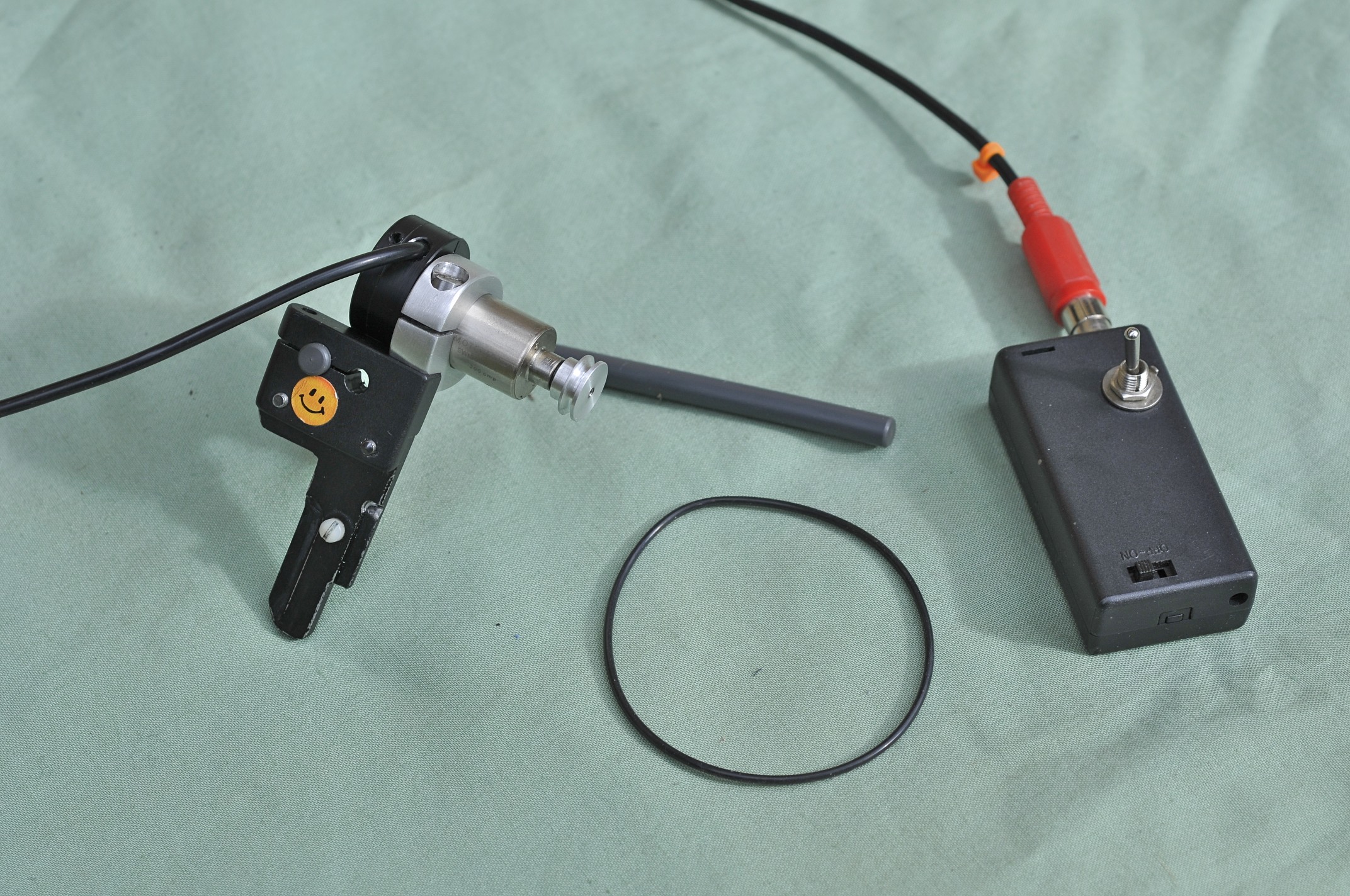

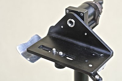

Roger, below are some pictures of some of my gadgets.
The motor is a salvaged Faulhaber. It is attached to piece of metal shaped to fit in the TM’s accessory shoe mount. Drive is by pulley and “O” ring. Faulhabers are very classy and are possibly an overkill. I have just discovered some Chinese motors marketed by Marcmart, their size is similar but their cost is less than $9 au. each including postage. They run very nicely and like the Faulhaber pictured should do the job with just one AA cell. The control box shown has one AA cell and a momentary contact switch set up so that if I push the toggle away from me the focus plane moves away also. Toggling the switch towards me brings the focus closer. At the moment the speed is fixed and happens to take about 22 seconds for one revolution of the control ring. I find it to be a good speed for focussing and if I try zooming it takes about 70 seconds to get through the full range i.e. up to 20x from wide angle. At that speed the zoom is so slow that you have to look twice to see if anything is happening. The motorised head uses Faulhaber motors with zero backlash gear boxes. I can get quite a good range of pan and tilt speeds just by varying the applied voltage. By increasing or decreasing the voltage slowly I can get smooth starts and stops. It would be relatively easy to apply a similar control to the zoom.
There is a picture of the housed extender and the TM900 remote. Note I have two leads and a splitter attached. One lead goes to my EX3 and the other to the TM900. I was worried that splitting the signal may cause problems but it works OK. Fortunately the EX3 and TM 900 are controlled by different signals, I just have to remember to pick up the right remote. There is a picture showing the IR emitter end of the extender cables, the top one is used for the EX3, the middle one clips to the underside of the tripod head and points forward to the reflector, the lower one clips to the underneath of the camera platform on the motorised head.
I have also shown two pictures of my DP6 field monitor. It housed in a semi-permanent hood together with its oversized batteries, another IR extender and a couple regulated voltage sources. One voltage source is set at at 9.3 volts and will run the TM900 if need be. The housing for the DP6 has a pair of rounded buttocks that sit in a cradle. The cradle can be set on the ground or on a bench. It can also be mounted on a tripod or hung from a tree. To change the viewing angle the the housing is simply tilted in the cradle. There are no clamps.
Greg is asking what tripod and heads we are using. The tripod shown is a Chinese e-Image found in a bargain bin minus ball and head. It is now fitted with a nodal head. Nodal heads do not use counterbalance springs, instead the centre of gravity of the camera, its accessories and in this case the microphone all align with the tilt axis. There is also has a column arrangement that provides for easy height adjustment. A short boom permits movement in a horizontal plane. These movements are not extensive but with them the camera position can be varied without moving the tripod, all highly desirable if you are working at very close range with a close up lens and a focussing range of a few inches. http://www.dvinfo.net/forum/images/a...attach/jpg.gif
