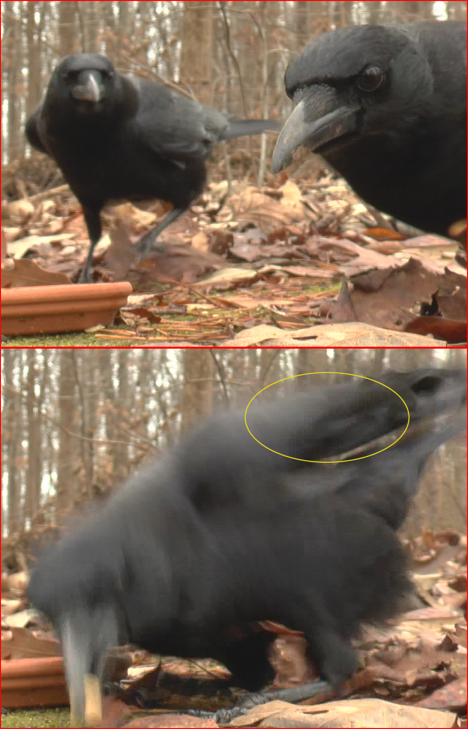

Could anyone with more experienced eyes help diagnose what I'm looking at?
Attached are two 100% crops from from a test shoot with some crows. In the 2nd frame, when the bird's body is moving, the dark areas of motion pixellate heavily. I'm guessing these are compression artifacts?
I'm baffled, since comparable files coming out of an earlier consumer-grade Panasonic (SDT750) never contain anything like this; shadowed motion from that camera is a gradient blur, not blocky. (I'm not trying to nitpick: when slowed to half-speed, the birds pixellated motions remind me of that old Predator movie...not exactly what I'm going for here.)
I'd hoped the x920 would be an inexpensive 'upgrade', but given my primary subject (fidgety black birds in a high-contrast environment), I'm having second thoughts.
Would that old standby of "you need a higher bitrate" help here? Any recommendations for more suitable gear would be appreciated. I'd considered a GH3, but I really need a deeper working dof.
(Shot at 1080/60p. Manual focus, +1 'Exposure Adjust.' Everything else auto. Settings when checked: 1/60, f3.4)

Yes, the bitrate argument works for these artifacts.
The fact is, AVCHD 2.0 at 28mbps is not enough to properly capture 1080p60. High motion will suffer these problems, it's unavoidable with the AVCHD 2.0 codec. The GH3 uses 50mbps which remedies this exact issue.
Unfortunately, the next step up that actually has a decent codec is the Sony 4K PXW-Z100, which can record 1080p60 with a really high bitrate.

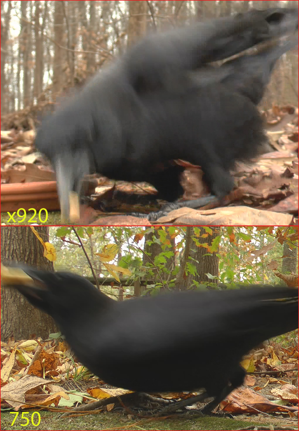

Out of curiosity, I checked files from my old camera for compression artifacts.
They're there, of course, but they're much more 'organic', a kind of posterized banding. Much easier on the eye than the linear tearing and blockiness of the newer model, at least under these conditions. (see attachment)
Chris: Good point about hand holding taxing the codec: most of the frame in my stuff is static, so I've probably been lucky. And the moving shadow detail is usually crushed to black.

Originally Posted by Pete Carney View Post
I have a TM700 and don't get that kind of macro blocking at all. Just a smooth blur on fast moving objects in 1080-60p.
That's just it...I've reviewed countless hours of footage on my older camera (which I understand is essentially the TM700 bundled with a goofy 3D attachement) and never saw this sort of thing...regardless of settings. The artifacting, even at its most severe, is always more organic looking. (I've attached the screen shots comparing simliar shots from the 2 cameras.)
