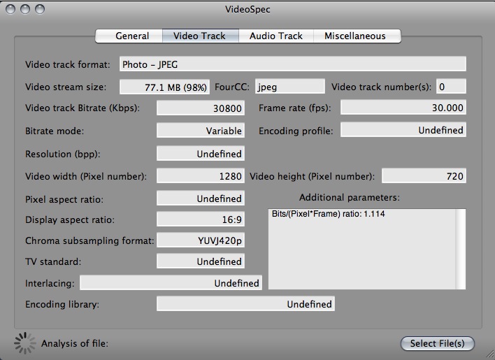

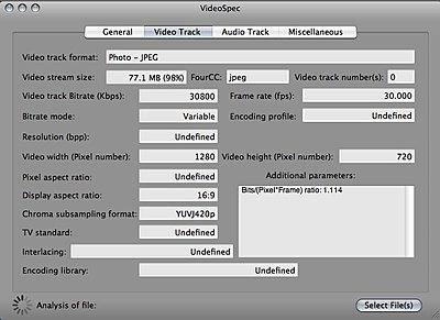

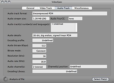

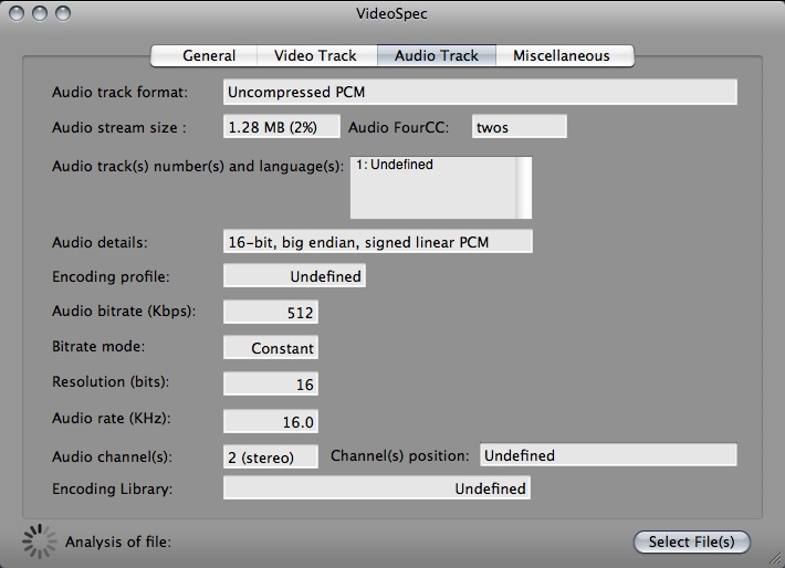

GH1 720p30 mode
Although the GH1 can record using AVCHD, it can also record to Photo-JPEG which is very EZ to edit. One potential issue -- recording is at the non-video rate of 30.00fps rather than 29.97fps.
I've got video samples, but no way to host.

Steve,
If you would confirm for me, the video bitrate for the JPEG video is 30.8 Mbps?
I'm just not used to seeing numbers that high in a consumer product.
On the other hand, the audio numbers, especially the 16 KHz sampling rate, confirms that anyone half way serious about shooting with this will be recording double system audio.
16KHz might be OK for dialog, but not for any kind of musical performance.

Remember this is, contrary to what I thought I'd read, Photo-JPEG not Motion-JPEG. So the data rate seems right.

Thanks for posting this info. I'm really look forward to seeing some clips from this camera, other than the tiny ones on the Panasonic website. There must be a few typos in the Panasonic specs for the camera DMC-GH1 | PRODUCTS | LUMIX | Digital Camera | Panasonic Global
It does say Motion Jpeg, Photo Jpeg is unusual I think as a camera codec, but I'd welcome it as it's great to work with even if it would fill up memory cards pretty quickly!
What would be the visual consequences of shooting and editing 30.0 fps and then rendering out to standard HD video at 29.97 fps?

I believe it is simply that every 1000th frame is dropped. Also audio will build up a lag with video by 1 frame, i.e. 1/30th of a second, over a period of 1000 frames (33.33 seconds), and then instantly catch up when the frame is dropped.
Some software will blend frames instead of just dropping, but that looks terrible, and causes a weird periodic blur that comes and goes every 33 seconds.
