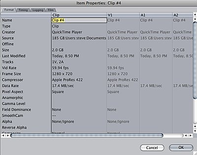

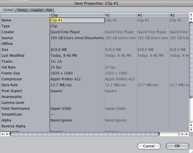

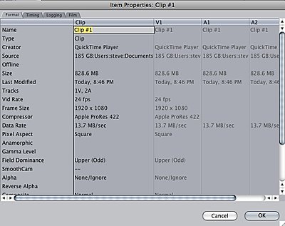

GH1 720p59.94 and 1080p24 modes
Here we have a mix -- 1080 is 24.00fps which makes sense going to films, but can cause trouble in the video world. Motion judder is VERY high -- or VERY BAD -- depending on your feeling about judder.
The 720p is 59.94 and is smooth as butter.
