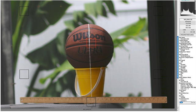

I had a focus problem with the first Canon 20D I bought. Canon was known for having focus QA problems back then. Basically, the lens was focussing at a point other than where the AF was "telling" it to focus. I used a rig as shown the screenshot to prove to B&H the camera was flawed. They replaced it and the second one was much better.
So in the rig, the basketball is the subject and has depth. There is a white string hung over the top that shows where the front of the ball is. The yard stick is at a 45 degree angle. When viewed using the camera software, one can see what AF points were used by the camera. Zooming into the yard stick, you will see where the depth of field actually is versus what the AF system was "focussing on". It's a helpful test is all. In my case, the faulty D20 was consistently, but not always, focussing behind and, to a lesser degree, in front of where it should have been. Basically is was randomly focussing correctly one in 10 pictures.
One thing when you do the test (if you haven't already), make sure you use mirror lockup on the D40 to take any camera shake out of the equation.
