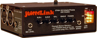

An issue flagged by some is that cams can produce an auto gain which increases the noise in moments of silence. That may not be the correct explanation, but its an increased noise in silent moments. I understand that some XLR adapters produce a preamp signal that negates this. This is explained very well in the Juiced Link website:
JUICED LINK - JL-DT454 [JL-DT454] - $419.00 : juicedLink, Unique and Trusted Solutions for Audio and Video Production
and I understand this BEACHTEK does the same thing:
BeachTek DXA-5Da Passive DSLR Adapter
So to get crystal clear sound in with an XLR adapter, and monitor it via headphones it would seem I need to buy one of these? would that be correct?

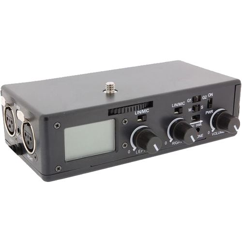

I want to see if I could revive this thread. Has anyone used the Beachtek DXA-SLR with the GH2 yet?
I have a Zoom recorder (owned it for years before the GH2) but I've never been satisfied with it. Just too difficult to use as an audio recorder much less at the same time as recording video if I am doing audio and video alone. And the battery life is very poor. A fresh set of batteries is a must for each session. It should have been designed for 4 AA batteries not 2. On a tripod bound indoor interview shoot, the Zoom is fine.

Has anyone tried this mixer? The price seems to be right.
http://www.bhphotovideo.com/c/product/563045-REG/juicedLink_CX211_CX211_Audio_Mixer_and.html
Jim Forrest is offline   Reply With Quote
Old March 21st, 2011, 09:52 AM   #14
Posts: 2,290
Re: XLR adapters and SOUND recording options for GH series
juicedLink CX211 Audio Mixer and Preamplifier CX211 B&H Photo
Jim, the price is good but it lacks phantom power and AGC disabling. Btw, *can* the gh1 or gh2 AGC be disable by third party devices?
Mainly this thing seems to be an XLR interface, but since it doesn't provide 48v I'm not sure what the point is unless you're using something like the ME66/K6 mic.
John Faihurst tested the more expensive version and got awesome results, so the units are great but the units you'd want cost more than the dedicated decks like the DR100.
