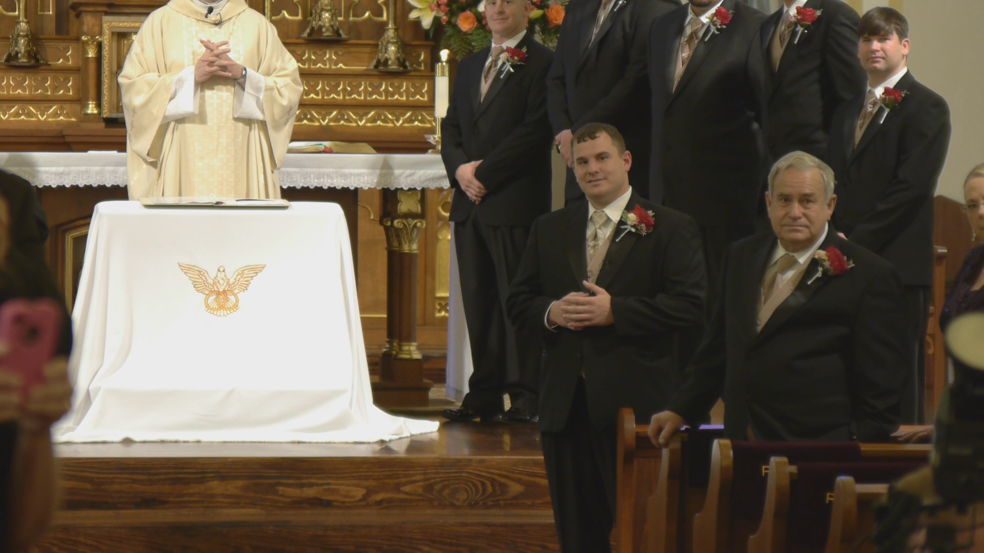

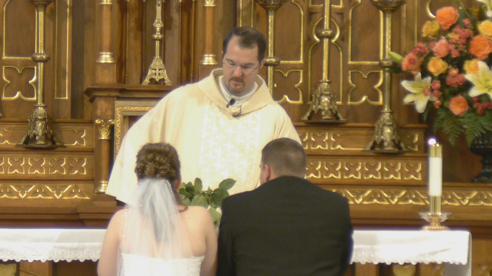

Here are 2 samples with a little background. Long middle isle with both sides of the church lined with both blue and yellow staind glass windows shot in the day. One shot with Ex Tele off and second with Ex Tele on, using a Vivitar 2.8 28-105mm. What I am curious about is the bluish halo/glow around the light colored objects, is this because of over exposure or something with the lighting or lens?

Steve, your grabs look fine to me. There is a phenomenon called light falloff with lenses, and I think that is what you are seeing. It is exacerbated when an area on the edges of your frame are darker than the middle. If you read the thread I pointed you too the Vivitar, according to the folks there, say it goes away about about F/8 or so.
I wouldn't give it a thought, there's nothing you can do in church about it, because you cannot close down your iris anyway.
There's another name for what your seeing, but i forget what it is. I don't see it in your images, they look fine. I would suggest to forget about it. A more expensive lens may have less of it, I don't know.
Keep in mind the telextender thingy is not ideal in low light situations also, so never assume you can use it with the best of results. In other words, you cannot count on it.

I was talking about the bluish glow around the alter, priest's robe, and the candle light glow. That is called falloff? I read the article and thought he was talking about a vignette effect and not lighter objects glowing hazeiness. I am going to read it again.

After looking at the second photo again, I see what you're talking about, sorry, didnt' catch it first time.
You are seeing effect of the telephoto, for sure. Sometimes it's great, sometimes it's not. Looks pretty bad in this case. I did't look at the photo or something the first time through, and I do apologize.
Telextender shot is lacking in detail, and that is as bothersome as the halo effect you see.
I would avoid it in church, if it were me.
As an aside may I suggest you upload jpegs rather than bmp files? Bmps are a bit unweildy and way oversized. Jpg would have been 10% of the size and looked just as good.

That lens is not quite happy on the GH2 or it has some hazing of the glass elements. I had the same problem with a pro wide angle converter that was made for an old TV camera when I put it on a new HD camera. That didn't work because the glass wasn't manufactured to a high enough standard.
The ETC mode on the GH2 can bring out problems in low light situations such as ISO noise and in your situation blooming. In well lit situations, ETC is a fine tool. As long as you don't use ETC in low light the Vivitar lens seems fine for video.
