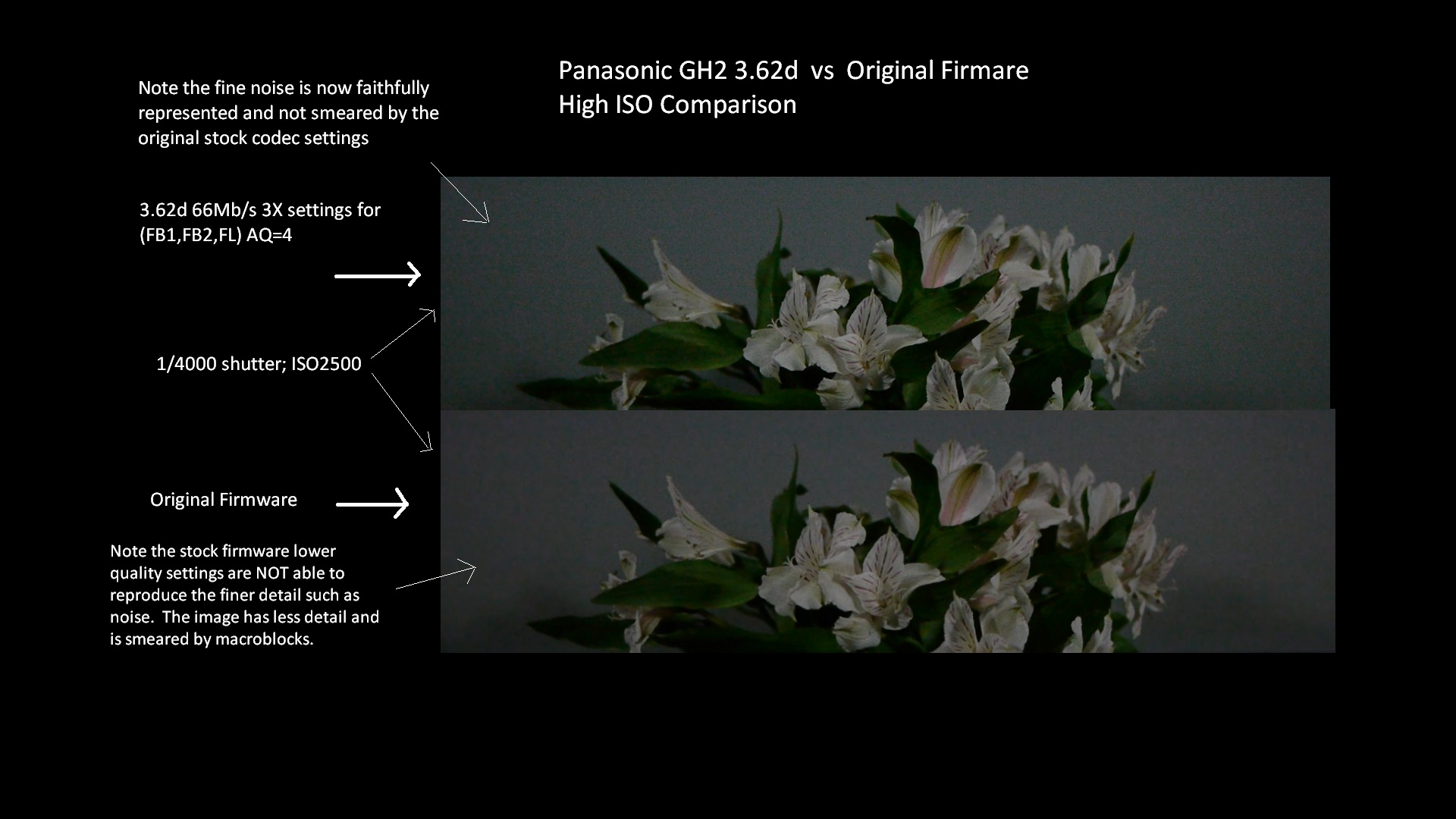

Old August 29th, 2011, 10:49 AM   #21
Location: Gilbert, AZ
Posts: 1,896
Re: How many of you have hacked your GH2?
Originally Posted by Philip R. Coltart View Post
Just so everyone is aware, this hack is not stable. I hacked my GH2 42 mbit high and I shot a wedding (foolish lover of quality that I am) and it worked fine all day EXCEPT for long clips. I reached about 10 minutes and it just suddenly stopped recording. :0)
Yes,
It's a good idea for anyone considering the hack to read through the posts to determine possible issues.
Version 3.62d improves on image quality with the auto quantizer function. As Chris Brandon mentions on VK's forum "If you go towards "detail" more of the extra bandwidth is allocated to using less quantization of macroblocks - which means better shadow detail and smoother detail all around."
Also, file spanning "can be" an issue with above 32Mb/s with v3.62d. I believe with version 3.61d 42Mb/s spanned without issues.
I'm currently using v3.62d at 66Mb/s AQ4 and the image quality is excellent!
It does not span past 4GB files, but it won't be long before VK / Chris and others figure this issue out.

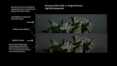

I've attached a high ISO (2500) comparison image.
This image compares stock 24Mb/s 1080P to 3.62d 1080P 66Mb/s AQ4.
This is an extreme test, but it certainly shows that the hack is able to resolve more image detail than the stock firmware.
Noise removal programs such as Neat Video will now be able to model the noise more accurately which will offer a better more detailed image in the end.
Simply amazing for the $$$
