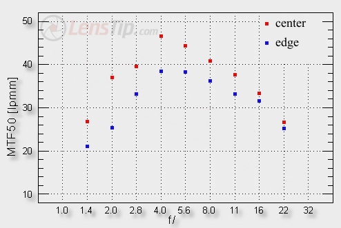

My Pentax 50mm F1.4 @ F2.8 has less than half the resolution of my Voigtlander Nokton 25 mm f/0.95 @ F2.8. BTW my Panasonic TM700 3MOS 1080p60 camcorder measured a horizontal sharpness of 1000 lw/ph and a vertical sharpness of 900 lw/ph on camcorderinfo.com and my GH2 with Voigtlander Nokton 25 mm f/0.95 looks just as sharp as my TM700. The very first test I did with my GH2 was with my 50mm F1.4 @ F4 in 1080p24 17mb/sec mode and looked just as sharp as my TM700 in 1080p60 28mb/sec mode when viewing the videos on my 1080p 47" HDTV off the SDHC cards with my PS3.
Pentax smc FA 50 mm f/1.4
Image resolution :
http://www.lenstip.com/upload3/3134_roz.jpg
Image resolution :
http://www.lenstip.com/upload3/3279_wykres.jpg

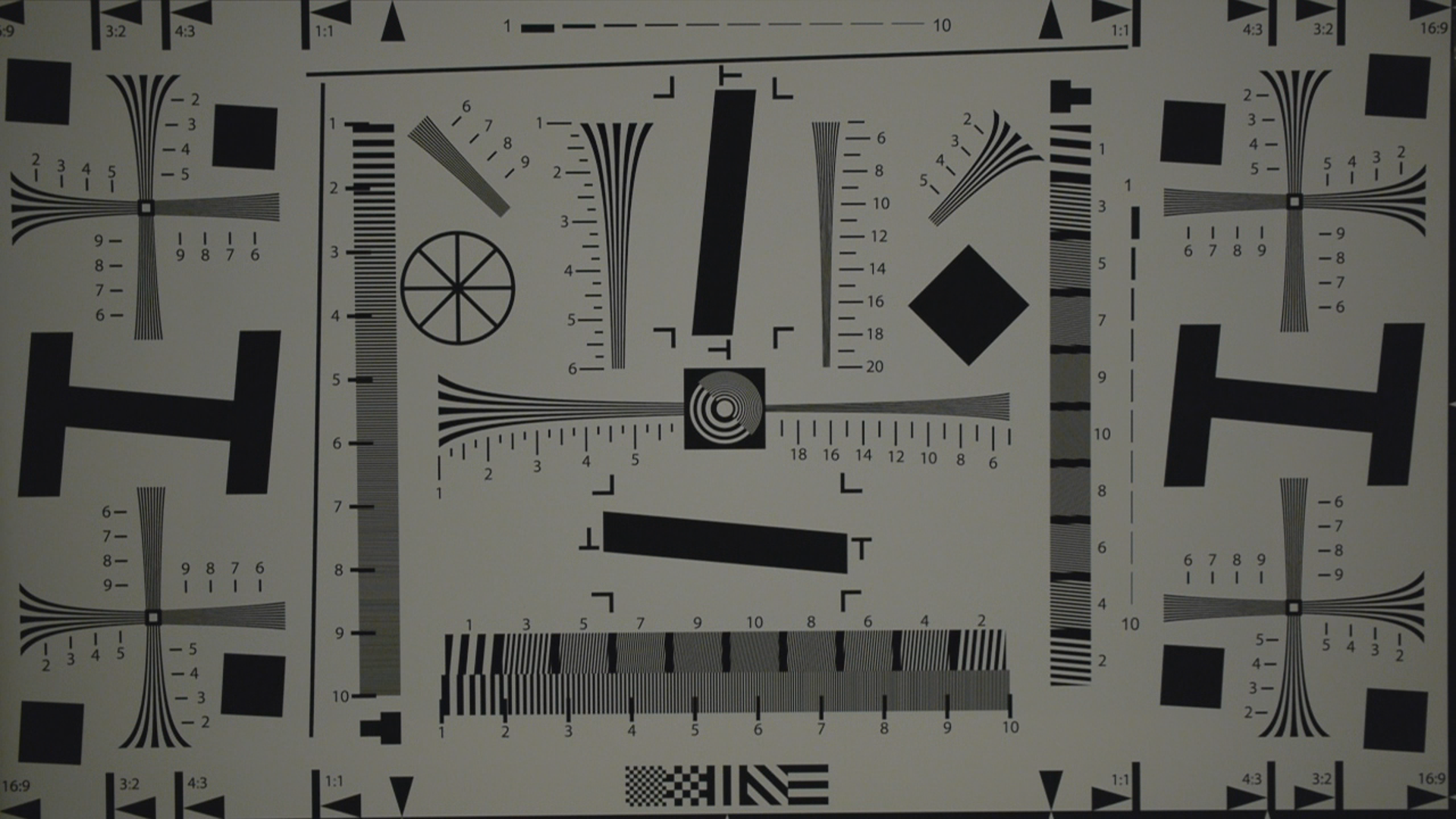

Okay, I just did a quick and dirty test with the chart and I got almost 800 lines horizontal and 700 vertical using the Aquarius 2 high bit rate hack/patch at the highest setting (24p at 24H) and a Panasonic 45 f2.8 at 2.8 to 5.6.
There are lots of lines false and real beyond these numbers (aliasing). It's a little surprising. Looking at video of detailed landscapes with the hacked GH2, XF100, and 5d2, the GH2 is the clear winner both in terms of apparent resolution and macro blocking, and a clean image. I would have expected numbers more like 1000 and 800.

Old December 7th, 2011, 07:39 PM   #7
Location: Colorado
Posts: 288
Re: How many lines of resolution for GH2?
Here is a copy of a not so professional shot of the test chart. The chart was not evenly lit or truly perpendicular to the camera:
Pat Reddy is offline   Reply With Quote

Also, if you Google "Barry Green GH2 lines resolution", one of the first links will take you to his tests where he includes clean downloadable test chart clips that you can evaluate. He indicated 800 lines in ETC mode and less than this in 1080 24p. If you look at his tests, I think you will agree that 1080 24p looks to be between 700 and 800 in the horizontal.
Pat
