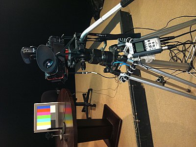

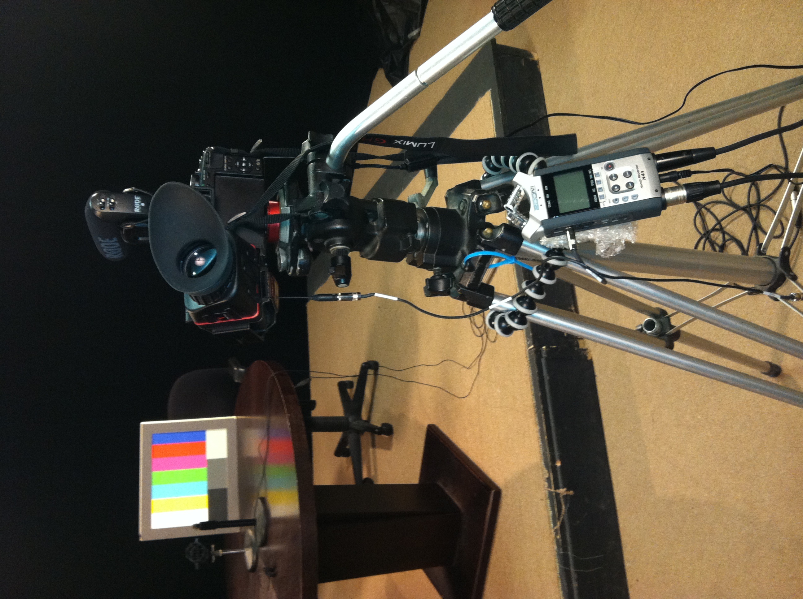

Here's a Zoom and GH2 set up. I am monitoring and sending the Zoom output to the GH2 with a Sescom line to mic with headphone jack cable. The Zoom is attached to the tripod with a Gorilla Pod. The talent hasn't shown up yet, what a way to spend a Sunday afternoon.

Shoot went well and the Zoom track was automatically synced up with the video track in FCPX using the synchronize tracks function.

Both. The output of the Zoom goes to the camera for a reference track. I start the camera first and then the Zoom. At the end I stop the Zoom and then the camera. Easier to sync the audio later if each shot has it's own audio file. It's not the cleanest set-up but it works well and the Zoom audio is much better than the GH2 audio.
