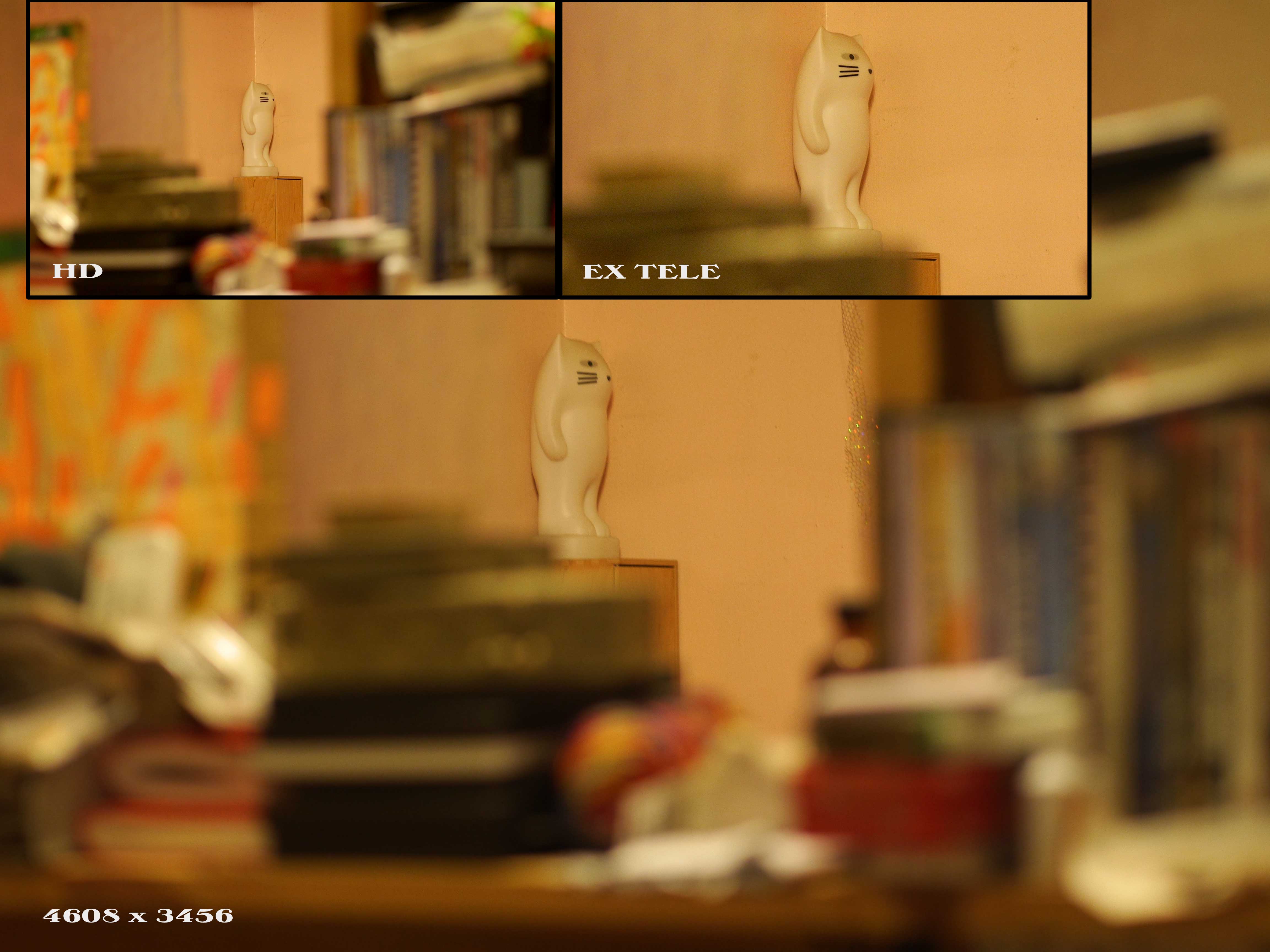

All I can do to add to this interesting discussion is that on the GH3 (and probably on the GH2), there is no functional difference in DOF between shooting HD, shooting EX. Tele or shooting a full frame still with the same lens.
