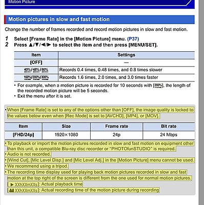

Being math challenged, the percentage thing is a mystery to me!
Can someone share a conversion of the percentages into actual FPS numbers?

In the GH3 menu, in video, there is a frame rate tab.
In the frame rate tab; the selections available are OFF, 40%, 48%, 80%, 160%, 200%, 300%.
These are variable frame rates. I think they are percentages of 24 FPS, not 30. But I'm not sure.
40% of 24 FPS would be 9.6 FPS.

Just did some quick tests.
The 80% is just barely slo-mo
the 40% is quite a nice slo-mo
300% is keystone cops territory.
So from my past experiences, the 80% looks like shooting 30fps and projecting 24 fps. Slight effect.
the 40% looks like shooting 48fps for projection at 24 fps.
Would love to know what these percentages actually translate into.

Page 185 of the GH3guideUSA.pdf says that regardless of other settings this mode sets 1080/24p at 24 Mbps with no sound.
Fran
Are you trying to say that whatever I set the option to, from 40% to 300%, I'm still at 24 FPS?
That is NOT what is happening. See my observations above or try it yourself.

No, I'm saying that the percentage change is in relation to 24 fps.
