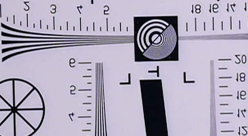

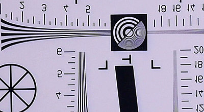

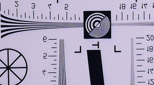

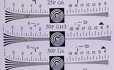

Recently I have been shooting with my gh3 and g6 and noticed a resolution difference, the image looked softer compared to my gh3 when I shot in 50p, I first thougth I might be imagining it untill I just shot a resolution chart (nothing scientific, just printed such a chart and shot it with the gh3 and g6, both with a lumix 12-35mm at 35mm and f2.8 shutter at 1/100 and 800 iso and all shot in the avchd mode and whitebalanced to outdoor (the light I used was 5600k). The image was not completely filled with the chart but that doesn't matter that much as it was only to see if there was any difference.
To my surprise the g6 is softer in 50p mode compared to 25p and what I thought the gh3 is also a tiny bit sharper in 50p mode compared to 25p for the g6. There is no visual difference between 25p and 50p on the gh3. This also explains why I saw a difference in sharpness. Sorry that the image is a bit small but it's easy to see, I"ll try to upload a larger one, what camera and the mode used is in the title of every photo.
Below is a 300% crop from the image so you can see the difference better, is there anyone with a g6 that has the time to confirm this?
G6 resolution difference between 25p and 50p-avchd_25p_g6_lumix.jpg   G6 resolution difference between 25p and 50p-avchd_50p_g6_.jpg

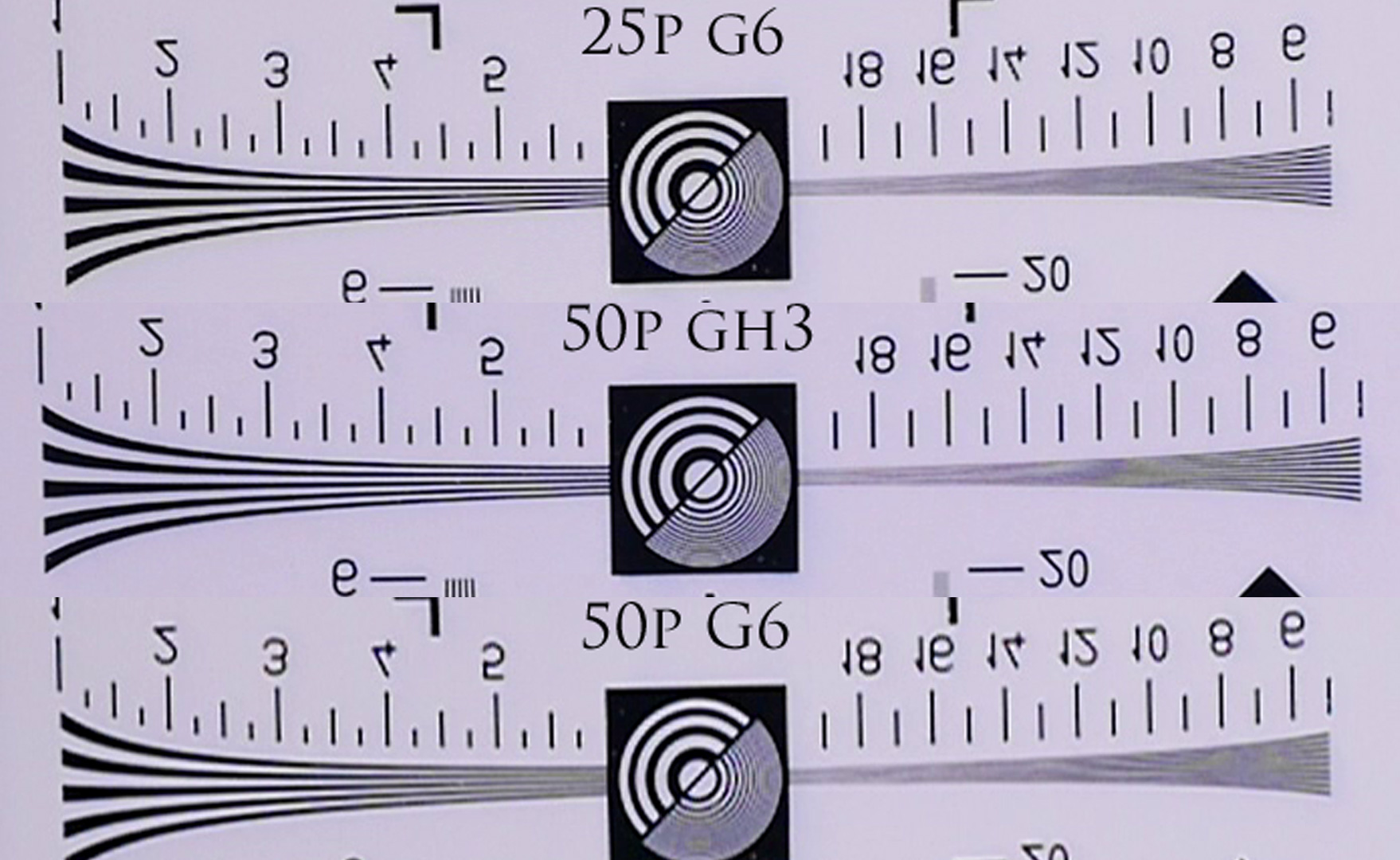

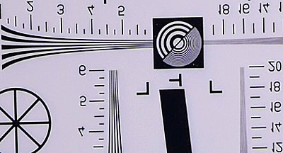

Here another one, it's a quite large crop but don't know the percentage here, but that doesn't matter as the difference shows, maybe I"m doing something wrong. I find it strange that no-one else has noticed this?

I also just notice now that the 50p image is strecthed vertically a bit compared to the 25p one on the g6. The resolution loss also appears to be more vertically then horizontally, lines that run vertical on that chart are somewhat the same, only the ones runining horizontaly show a obvious softness.

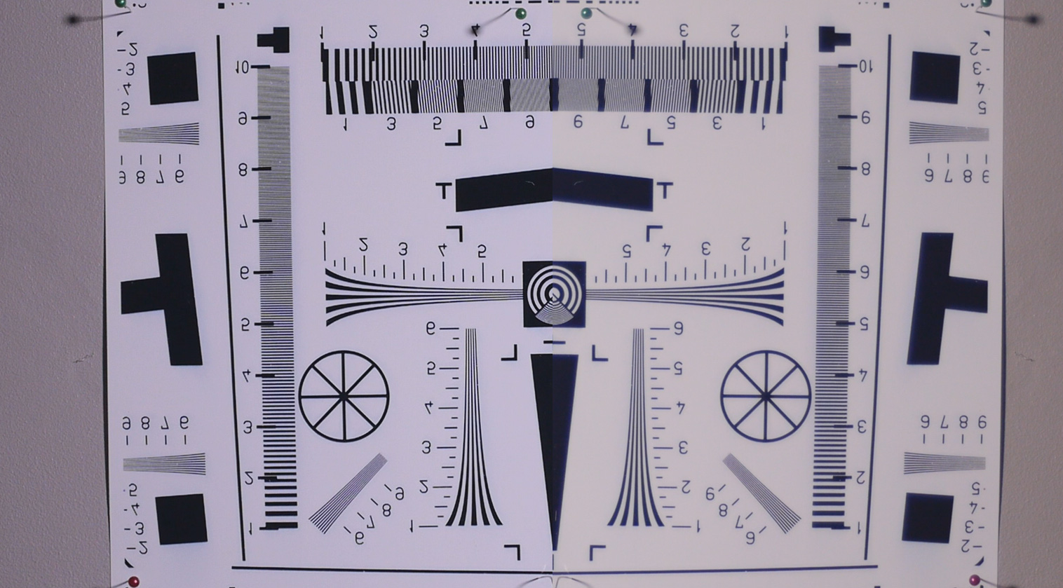

This is also interesting to see how a lens renders an image and how different they can be, below is the lumix 12-35mm on the left en the tamron adaptall II 35-80mm on the right, all camera settings where the same with both lenses, you need to zoom in on the image to see the difference in color and you"ll also notice the blacks "bleed" at the edges on the tamron where the lumix renders it pitchblack all the way.

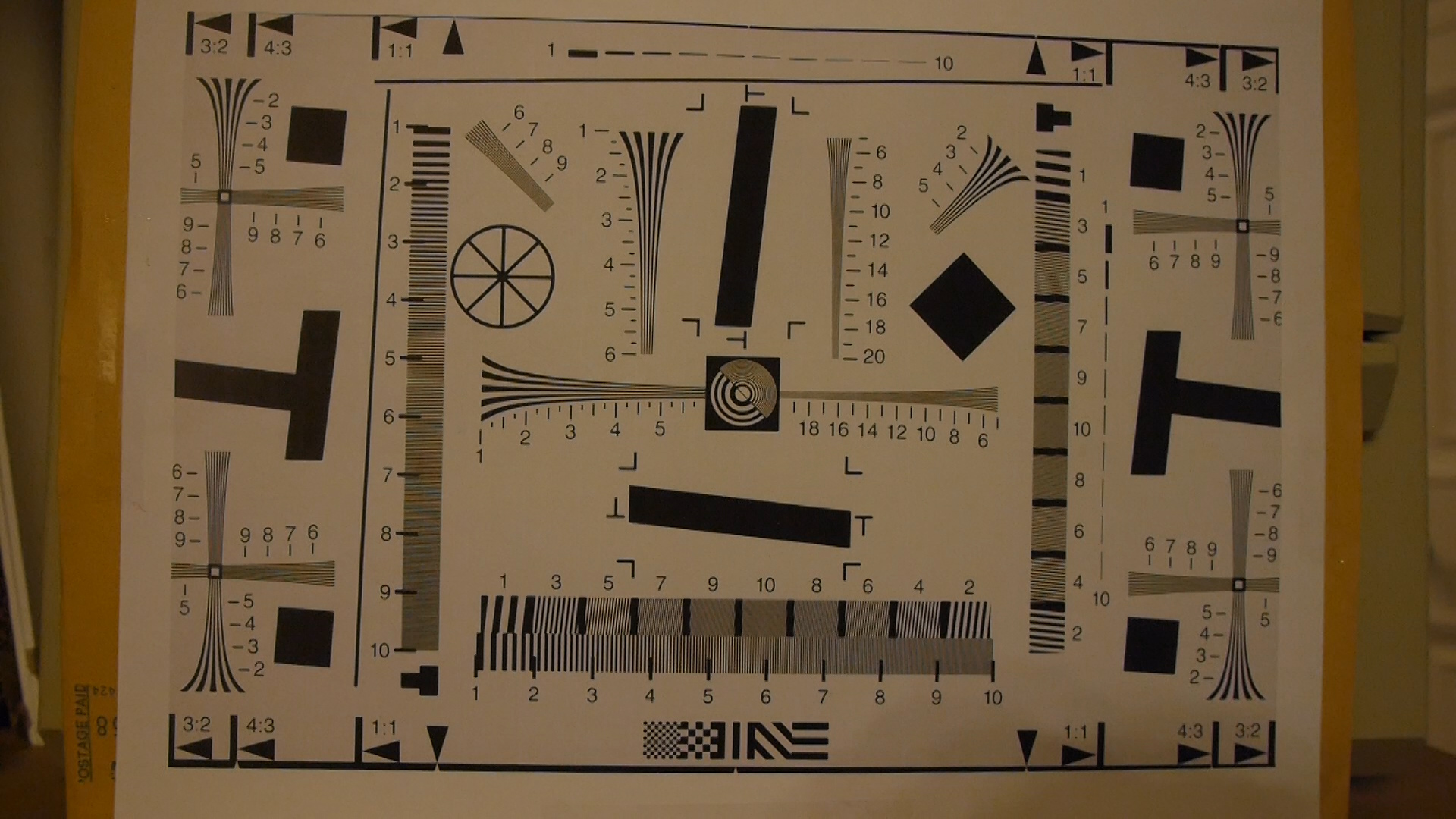

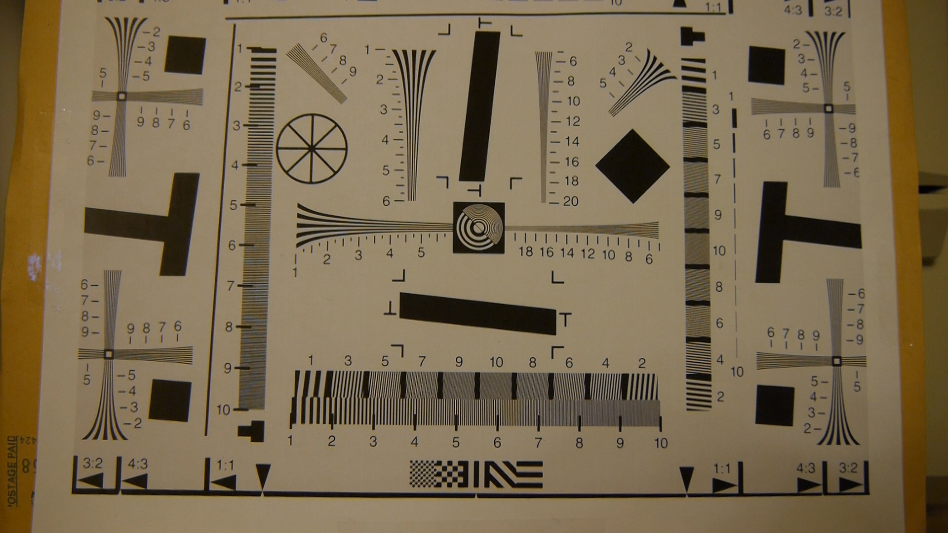

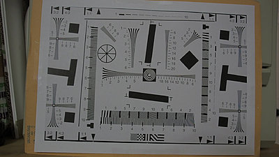

I have just shot some very rough charts & I am pleased to find that I don't see the softness with 50p. Here are the complete charts.
14-42mm kit lens at 14mm & F/3.5 ISO 800 1/50 AWB
G6 resolution difference between 25p and 50p-g6-25p.jpg   G6 resolution difference between 25p and 50p-g6-50p.jpg

Just for completeness sake these are shot with the 14mm lens at 1/100
14mm F/2.5 kit lens at F/3.5 ISO 800 1/100 WB Tungsten

Finally the same chart shot with the Olympus OM-D E-M5
14mm F/2.5 lens at F/3.5 ISO 800 1/50 AWB 30p

I do see a difference between the 25p and the 50p with both lenses. Look at the vertical rows with the horizontal lines going from 100 lines of resolution on the top of the chart to 1000 lines to the bottom. If you switch between the 25p and 50 while paying attention to the area around 700 lines, you'll see the image go from aliased in 25p to gray mush in 50p The first reason I would ascribe this effect is the compression. The camera is cramming twice as much information into a 50p stream than a 25p stream.This will lead to some sort of image degradation. Interestingly, the vertical lines do not exhibit the same effect at 700 lines.

It's weird because I do see a difference between the 2, the 25p chart has some weird kind of artifacts in the image that the 50p image doesn't have which is mostly noticeable on horizontal lines, almost looks like aliasing, something fishy is going on for sure.
I can tell that with my gh3 there is no visible difference whatsoever between 25p and 50p when I shoot that same chart, even when I magnify a lot, they look identical, only not with my g6 where I see a difference. The main question is how much that show on real life footage, this week it's mostly raining where I live so there is not much chance to shoot outside but as soon as I can I"ll make some comparisons, I do have a paid assignment this Thursday where I am shooting with the gh3, might take the g6 along and make a comparison shot when time allows.
