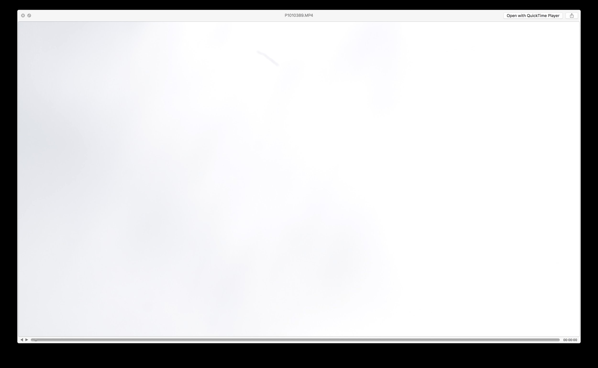

Sure, here's a shot from the manual video mode. I think it's quite far into the sensor and would be surprised if the other modes are cropping that much. I'm going to take it into the shop today to see if they'll clean it for me.

Now you know why you got such a "great deal". There are a lot of people on ebay who sell equipment without disclosing things like this in the hopes you won't notice.
You can buy a senor cleaning swab kit for this type of thing. I've done it before on a larger camera. It's tricky but do able.
This is the pitfall of interchangeable lens cameras. Every time you swap lens especially in the field you risk this.

I would think you would see this dust on the sensor if you removed the lens and looked in good light.
A lens blower should be enough to remove it with a few buffs of air, I wouldn't let a shop on it until you had tried that, as they don't always take the best care.
Sometimes however it can be a flaw on the sensor itself, or likely on the filter covering the sensor that can not be removed.

Thanks for the advice guys, I took it into the store and they had a look, turns out it was a scratch on the sensor. Unfortunately, since the store I bought it from was quite far away, they suggested I send it in for repair on the warrantee. It's off now and I'll get it back in a week or so. What a bummer.

I'm the same way I hate having to send back a new purchase but you did the right thing. I was surprised to hear it was a scratch since it wasn't a straight line.
